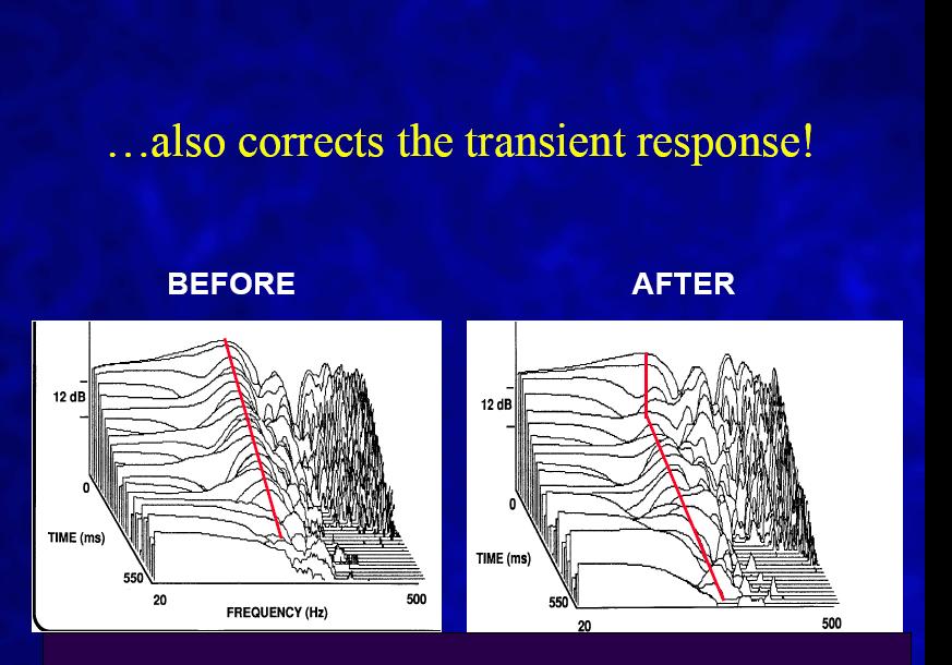

The problem is that if you rotate it to the side so you can clearly see the decay, it may be blocked by other resonances in the waterfall. If you view from the side and take a "slice" you could easily see it, but then its not really a waterfall. Of course, with a 3-d cursor you can get the data easily.
I have the data, from one of Floyd's powerpoints. Not sure how to get the image inline in this message. Do i have to host the file (http://) somewhere?
It does show the mode decaying quite fast, and then at a lower rate (harder to tell at that point since it is close in level to the rest of the decay). The initial level is close to the unequalized, with a very quick early decay. Of course, the eq filter is kprobably not perfectly matched to the resonance (it is real world). Personally, I have my reservations about waterfall plots.

ok, here's one. I have found another I can upload if you are interested.
Thanks Todd, I was hoping that you will post that particular CSD because it's the same Toole used in his book :) What we see is that the ringing is attenuated (which is good) but at the same time the decay rate has become slower (which is bad). In a minimum phase system the decay rate should be faster after applying an EQ, right?
Best, Markus
Best, Markus

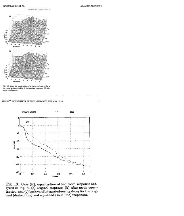

I dont think the decay rate is slower. It is certainly much faster in the early part. So overall if you avoid noise floor, I think the decay is faster. Here's more from Karjalainen et al, which shows the "slice" of the waterfall for the resonance in question. Similar to the Toole plot, the decay is much faster at the start and slower later. One reason for this is the noise floor, which I'm sure is right about -25 dB. So, the effect on the decay would start around -15 dB. The other thing, and perhaps this is what you are referring to, is that this type of decay may happen when the Q of the filter does not match the resonance exactly. i may have more on this, if I can find it... . keep in mind that in this example ther're not even trying to remove the resonance, just bring it down to the level of nearby peaks.

Hi John, so are you trying to remove all ringing then? Then add some back in to make it sound more natural? I'm dont really think its necessary, but sounds interesting.
Markus, I think you mean that the decay RATE should be similar in an approximately minimum phase system, but the decay TIME should be faster because the starting amplitude is lower. You had previously substituted one term for the other many pages ago, and it makes discussion a little confusing. It's hard to make out the slope here, but you can see that the resonant frequency hump goes to zero earlier AFTER equalization, hence the decay TIME is in fact faster.
Isn't this elementary linear systems theory? If you reduce the Q of a MP resonance, the time constant (i.e. decay rate) is reduced.
time const = Q/(pi*Fo) or somehting like that.
Again, I think that at least part of the complication here is that the Q of the correction filter seldom exactly matches the resonance. In fact it may not always be easy to determine the Q of the resonance. So you end up with a corrected response that has two slopes, from the Q of the resonance and the correction filter not cancelling correctly. Should it be surprising that the decay in time has two slopes then?
