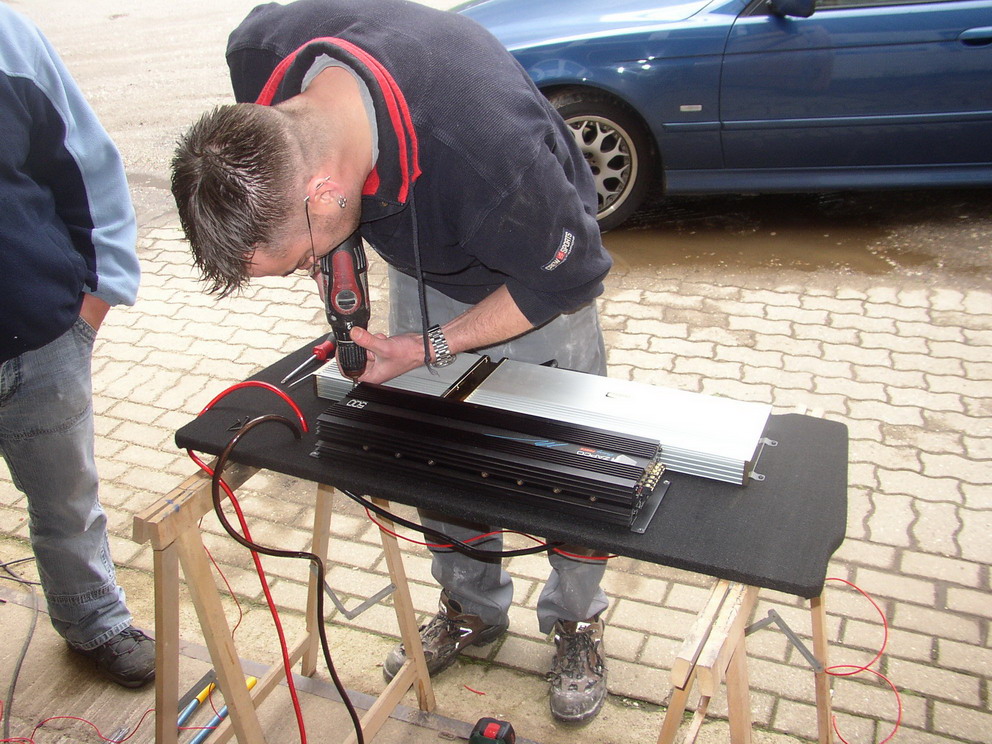

4 AMPs?
I only needed 3: a "Sinfoni 45.2" for the tweeters, a "Sinfoni 150.2" for the mid-range speakers and a "ZAPCO Studio 500" for my ALICANTE Sub.
I am using an Clarion DX-H2 headunit.
And my car is still one of the "best-playing - ARE-YOU-AUTHENTIC" - cars in Northern Germany.
