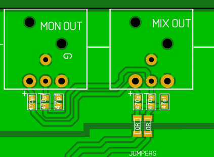

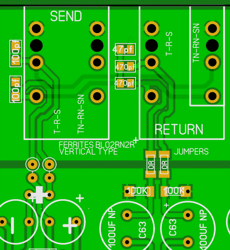

Hi Marce!
Attached is my PCB layout of the rfi protection of send/return connectors and XLR output connectors.
The connectors ground is separated from the audio ground plane by the horizontal cut out traces.
For the half normalled send return circuit i could not avoid placing two traces on the bottom layer of the chassis ground...
The rfi capacitors are 1206 or 0805 size. Those who are connected to chassis ground are connected by a trace on the top layer, not a thermal pad.
Apart of this i would like to know if the RFi layout is ok... and if the 0 ohm jumpers can be replaced by ferrites.. or it is not necessary..
Thank you very much!
