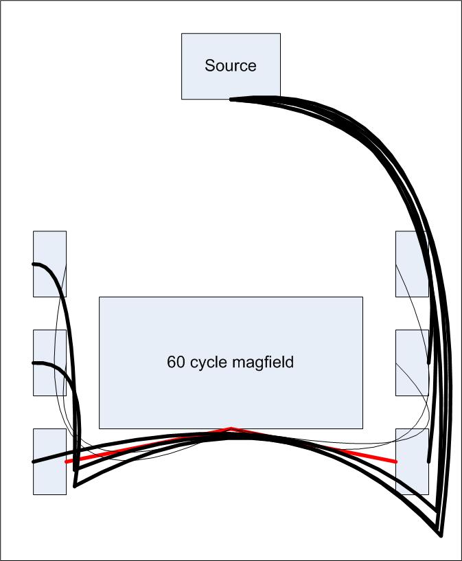

Here is a plan showing electro-physical config of the complete actual amp.
What should have I done instead...two power transformers? ... with primary coils with inverted connections on one transfo maybe :)rolleyes:???)...totally independant PSU and RegPSU's...or something else ?
Finally the math part : Was the gain of noise for 6 channels in relation for each channel, like here equivalent to : 20 Log(6²) or something like this?
Luke

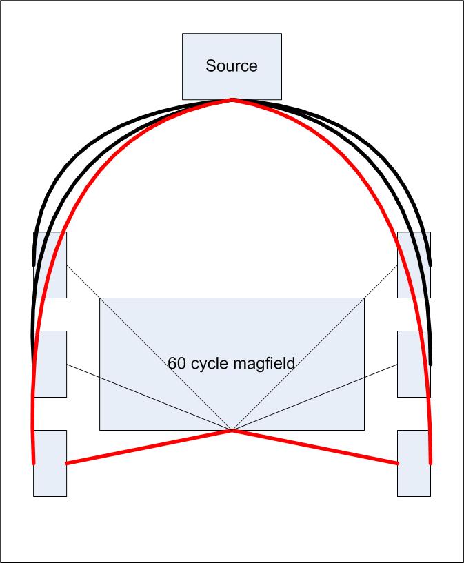

I've drawn up two really rudimentary sketches, so please forgive the "crudity of the model.."
First pic is your design. Note the power grounding, and the input wiring ground layout. I've hilited two input grounds and two power grounds in red. Note the large area formed by that loop.. It will couple to any 60 hz magfield in the chassis.
In the second, I pulled the inputs and grounds with my really crude drawing package. Notice there is no loop area anymore. If you go to my gallery, you will find a drawing of three scenario's with a power amp, a source, the IC, and the power cord. Note that the effective solution to my ground loop problem was to eliminate the loop.
Three components are required to get hum.
1. A source of magnetic field. (agressor)
2. A circuit which is sensitive to the currents caused by the loop (victim)
3. A coupling mechanism.
Source can be the transformer, or the wiring itself. Toroids are good at containing field, but the ac wiring must be tightly twisted, loops in the ac can cause magfield. edit: loops in the secondary and the bridge and the wiring all the way to the power supply filter caps can couple as well, so control the currents there as well by twisting both conductors or 3 together.
Low level circuits are by nature, sensitive to the currents, that's another very large topic..edit: the input pair ground reference as well as the ground ref for the feedback divider are two important grounds to worry about.
The coupling mechanism is the proximity of the input ground loop to the source, and the size of the loop.
