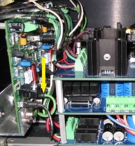

Hello
Well that's it!
No, I did not solve my problem.
But I had enough inspiration from you & related documents to realize that nothing can really improve easily.
I thought I could have an easy solution but it's not the case.
So...let's take out ALL wiring out of this and start back.
I will apply the Star Gnd concept the best I can in the present situation.
So all main points will be star grounded like the picture, below.
Notice that there is two arrows from each sub-star points(the black ovals) on each MainPSU's that reaches to the Copper-bar main Star point.
The reason is that I run two ten gauge cables from the two main caps on each MainPSU.
The inputs will be left unchanged right now but there will be "rooms" for them on the Copper bar...for an evantual Plan B, if necessary.
So here is the new schematic.
Please don't hesitate to comment as tour suggestions are welcomed.
Thanks!
Luke
PS. I'll be back to report when assembled and tested.

Luke, what is that green wire connected to the amp in the picture? Do all 6 amps have one of those?
Hello Pixo
The green wire you're pointing is the amp's output's on-board RC conjugate network that is getting grounded.
Note that there is two ground wire on each amp's boards: one for the Main ground and one for the RC network.
Luc

1. Instead of connecting the ground returns of your amplifiers to the "sub-star points" (the black ovals), take all 6 directly to the copper bar, but continue with your plan to run two ten gauge cables from the two main caps on each MainPSU. Try to keep the 10Ga cables as short as possible.
2. Remove the six ground wires that are currently hooked up from the RegPSU to the amp boards. Instead, solder one thick wire to the Ground point on the RegPSU board if possible, preferably at a point close to the supply capacitors that come after the rectifier diodes. connect that ground wire directly to the copper bar ground.
You can run a separate wire from each amp for that on-board RC conjugate network to the copper bar Gnd. But i don't think you need wires that thick

Hello Pixo and thanks!
1) I thought about this, don't worry about that.The reason I did not do it the way you just descibed is that the three Gnd's shown on the schematic are actually routed this way on the PCB tracks.
They each have independant tracks that end exactly at their own pair of El-caps that ultimately all rest to "my oval point, like on the schematic".
They have been designed to have EXACTLY the same resistance each, whatever their path lenght on board.
Same thing for each Vdc+/VDC-.
And above this the each Gnd resistance is half of each Vdc+/Vdc- tracks.
I don't think that a pair of 2½ inches long of gauge 10 wire will get very far from an ideal Star point connection as far as resistance is concerned, right?
By the way...Yes...each amp are supplied by a pair of caps. So six pairs in all, three per MainPSU card.
And also, the oval point is at the middle pair of El-caps, between the three pairs.
Also the tracks are very wide, typically (±) 200 mils and thick, 3oz/Foot².
2) Pixo...look carefully. You just read bad!
What you suggest is EXACTLY what is in the schematic.
Don't forget that the "little black lines" in the boards are actually tracks, not hard wires.
And the output ground on RegPSU are NOT connected.
Luke
I was looking at the picture of your amp internals where you had it connected it that way earlier. But now you know exactly what to do!
Yes, 2.5 inches is not bad at all
