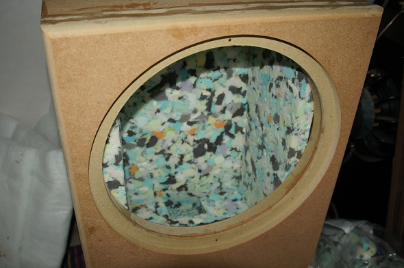

Very nice! How is your enclosure stuffed? How low does the TD15LO go?
Bill
When I measure with RTA in room it reaches 40hz. Bass changes from cardioid to dipole between 100 - 200hz, so I boost 7db at 50hz. Bass still pressurizes the room although it gets more dipole at the low end.
