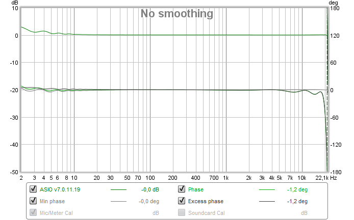

Looks u guys use ASUS U7, can i warn you if OS is Windows you should check via loopback if you on latest driver version for phase distortions.
Here is mine loopback 44,1kHz on latest driver Win7 using ASIO, absolut phase/min phase/Excess phase curves as should be are close in coherence.

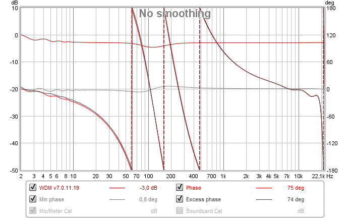

Here is same loopback 44,1kHz on latest driver Win7 using WDM, amplitude is overall -3dB lower plus a bump around 115Hz but it gets worse in it also has build in 1080º excess phase as was there 3 times 4th order XO points finding place. Long ago contacted their support department but all they did was clean up a bit on support page for U7 so in a way they must mean it seriously.
attachment.php
Can't live with above performance myself :mad: so use one of the older drivers to get WDM phase follow amplitude as a real minimum phase device.
