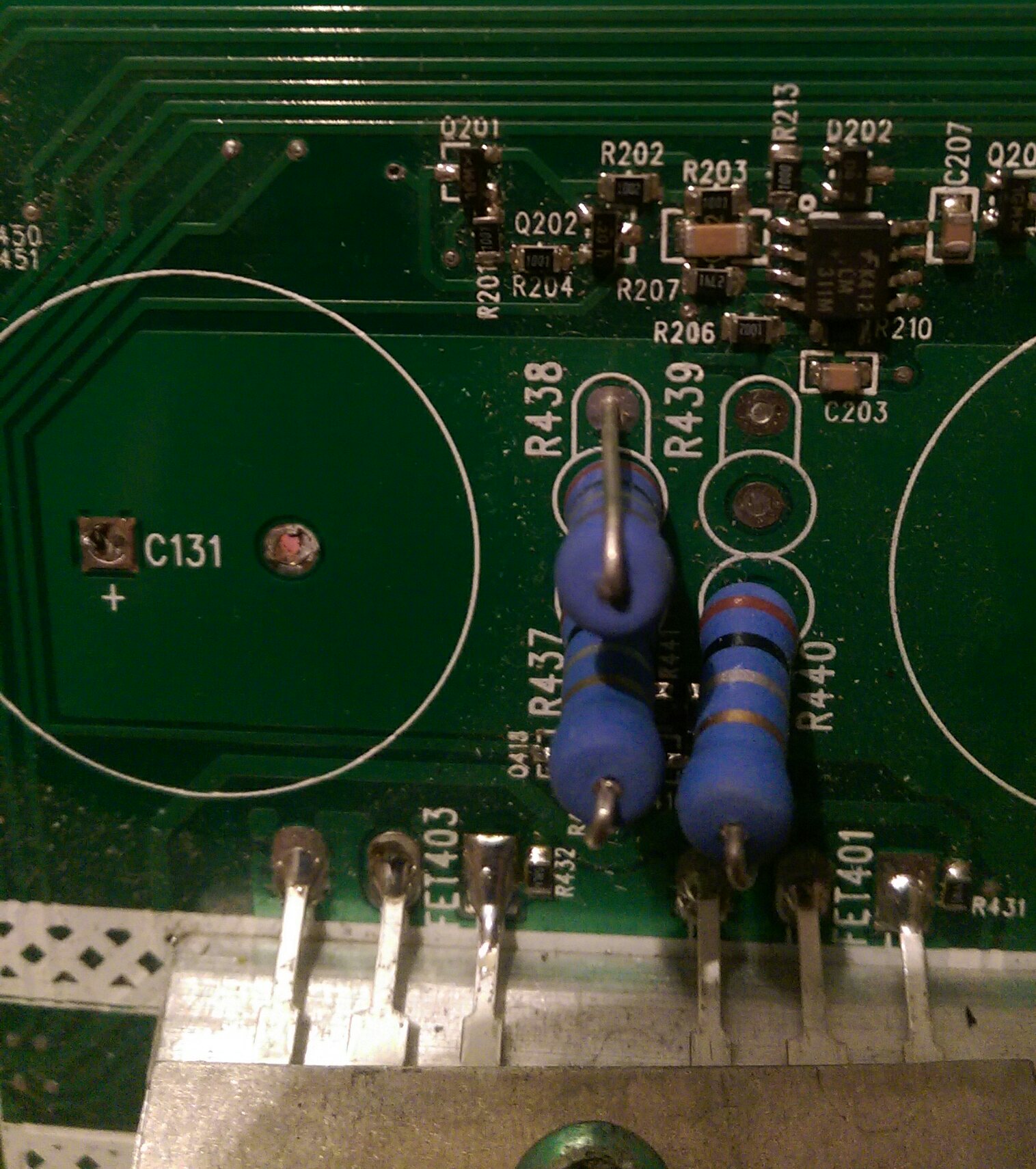

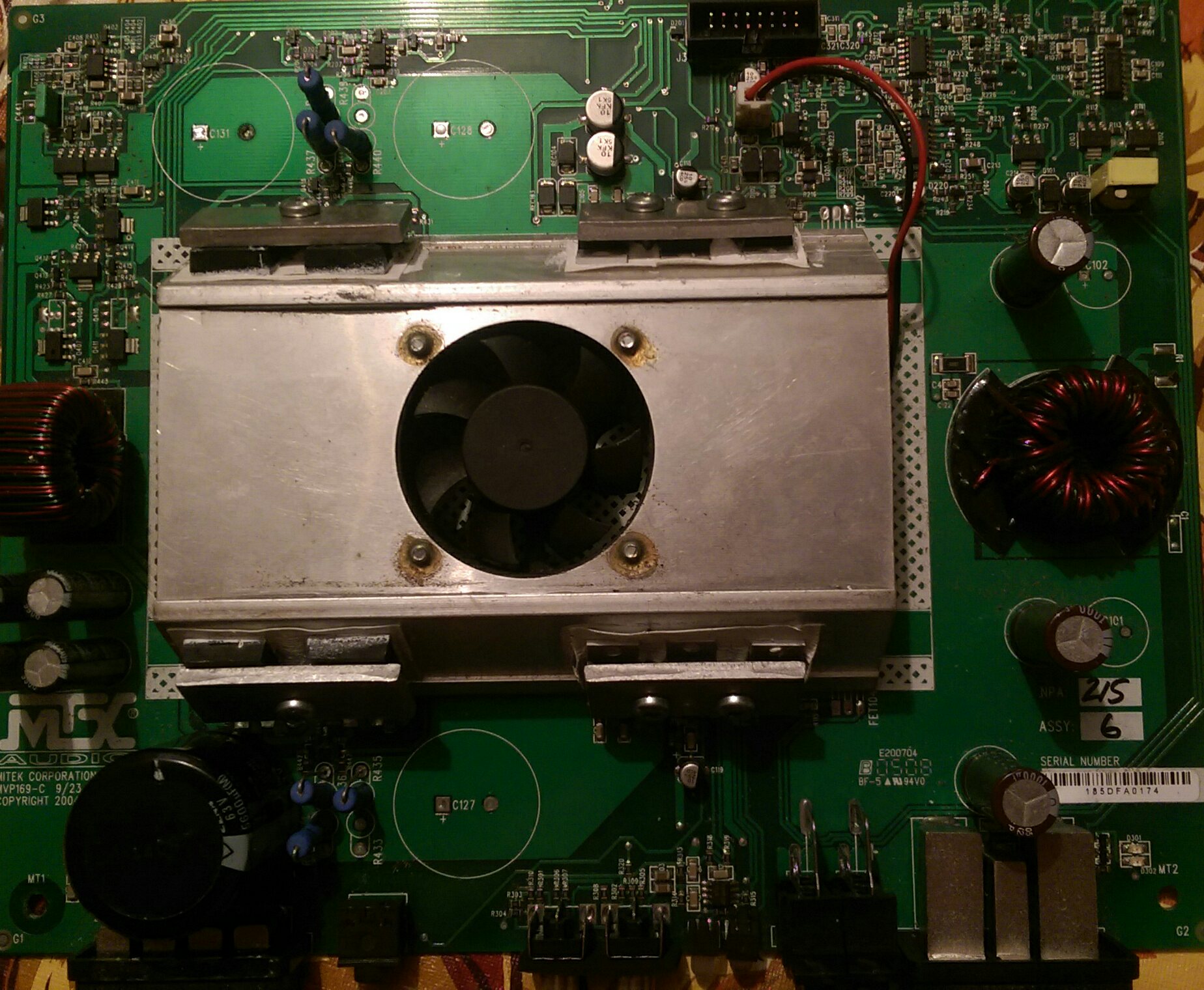

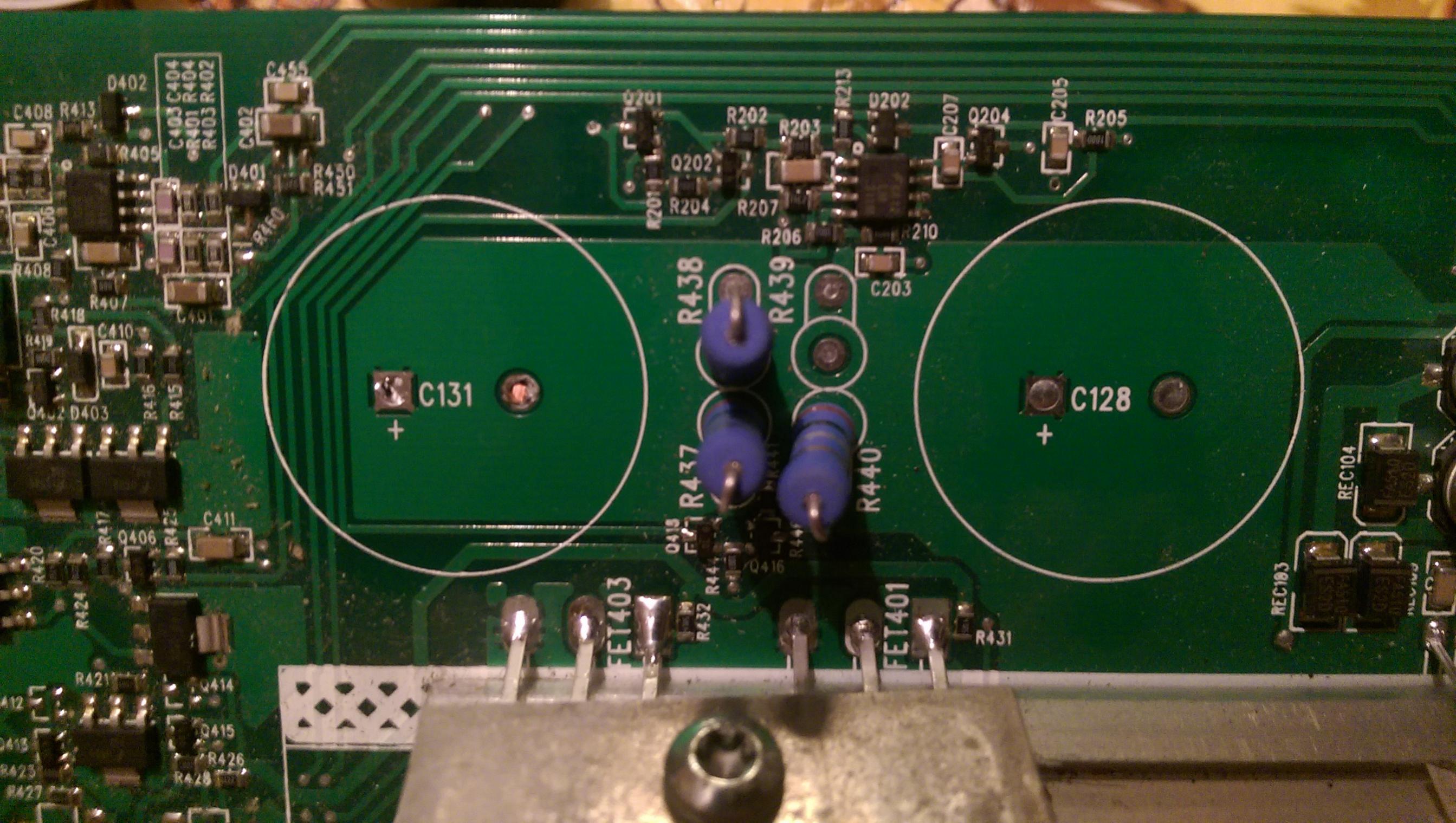

Here are a few pics of the board. C131 was removed to take the pictures. Q201 is where I am seeing the puff of smoke.

I agree. There seems to be no reason for it to cook. I had a thought, though. This one came in with the 2 voltage regulators on the heatsink fried. One was a 317T. The other was melted to the point that I couldn't read it. Do you think it could have been different and using a 317 is causing the problem? I ordered a new transistor that will be here today. I will replace it tonight and see what happens.

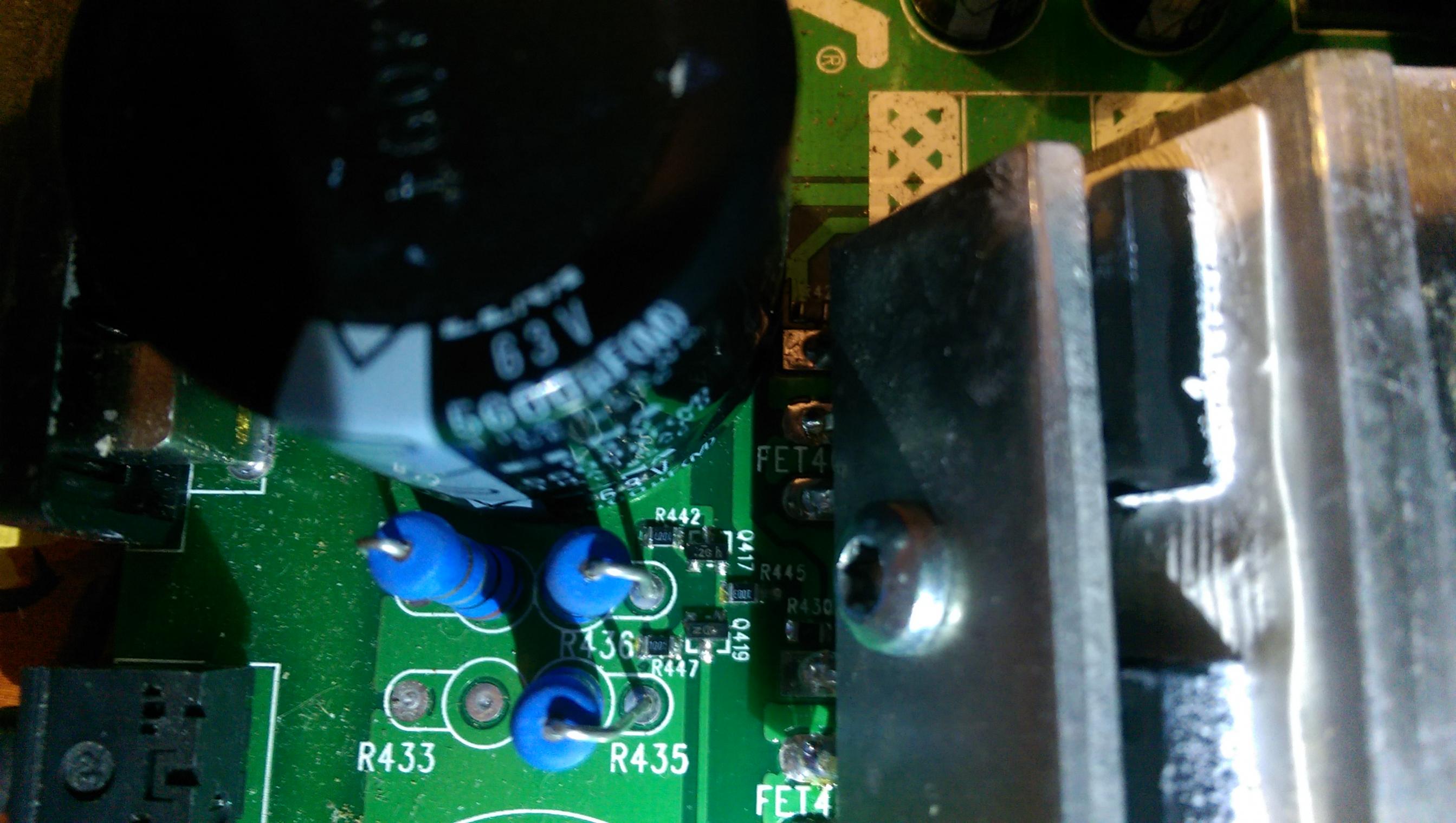

Well it turns out that it was suppose to be an LM337T. I replaced it and the transistor that cooked. Powered it up and another SMD transistor fried. I believe the owner is going to call it a wash on this one. But, just to try, I've emailed MTX to inquire about a schematic. Not much hope for that happening, though.
The transistor that failed is on the opposite side of the board. I will shoot a picture of it, this evening.
