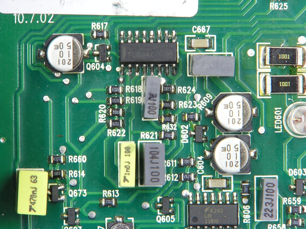

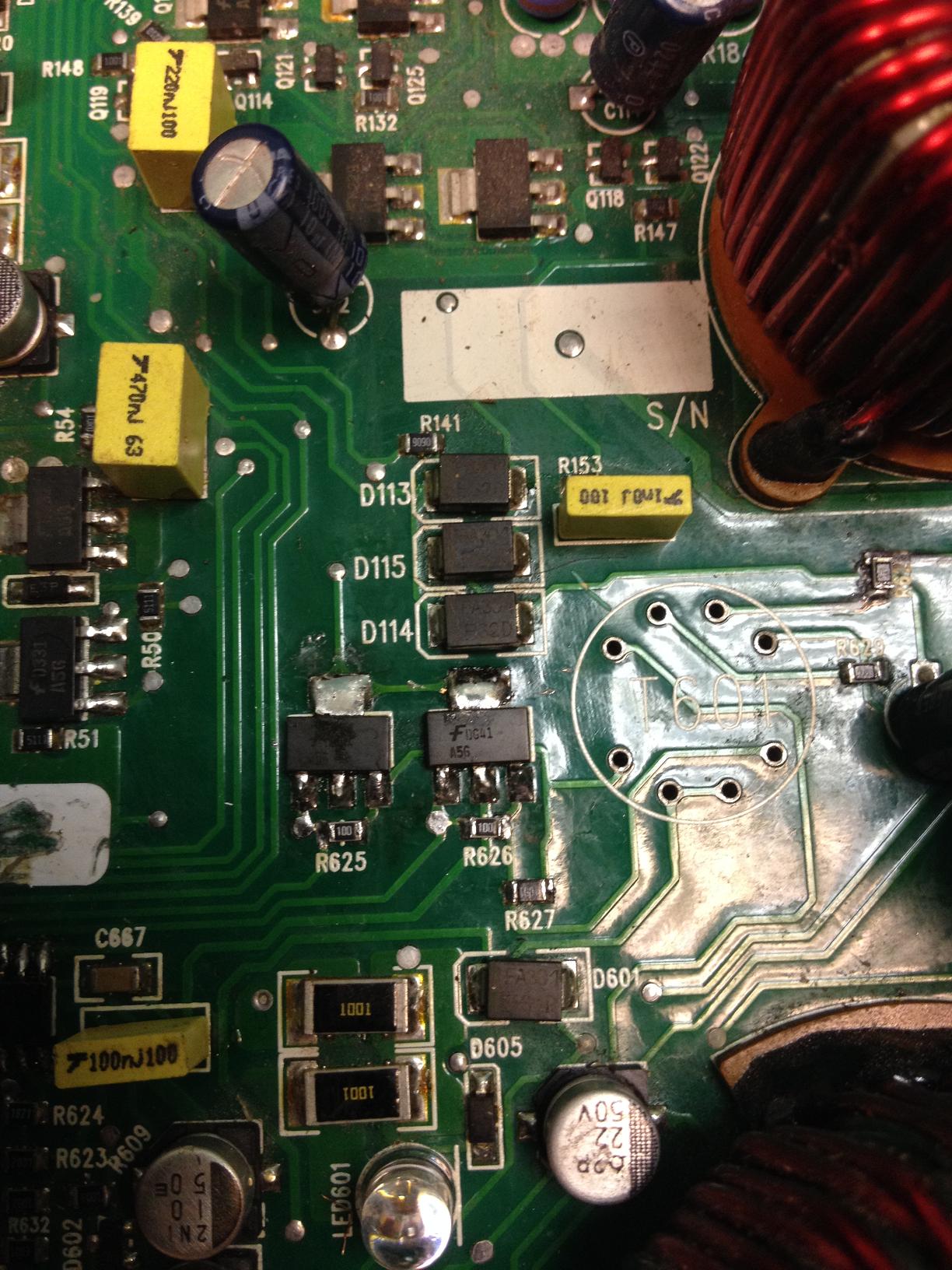

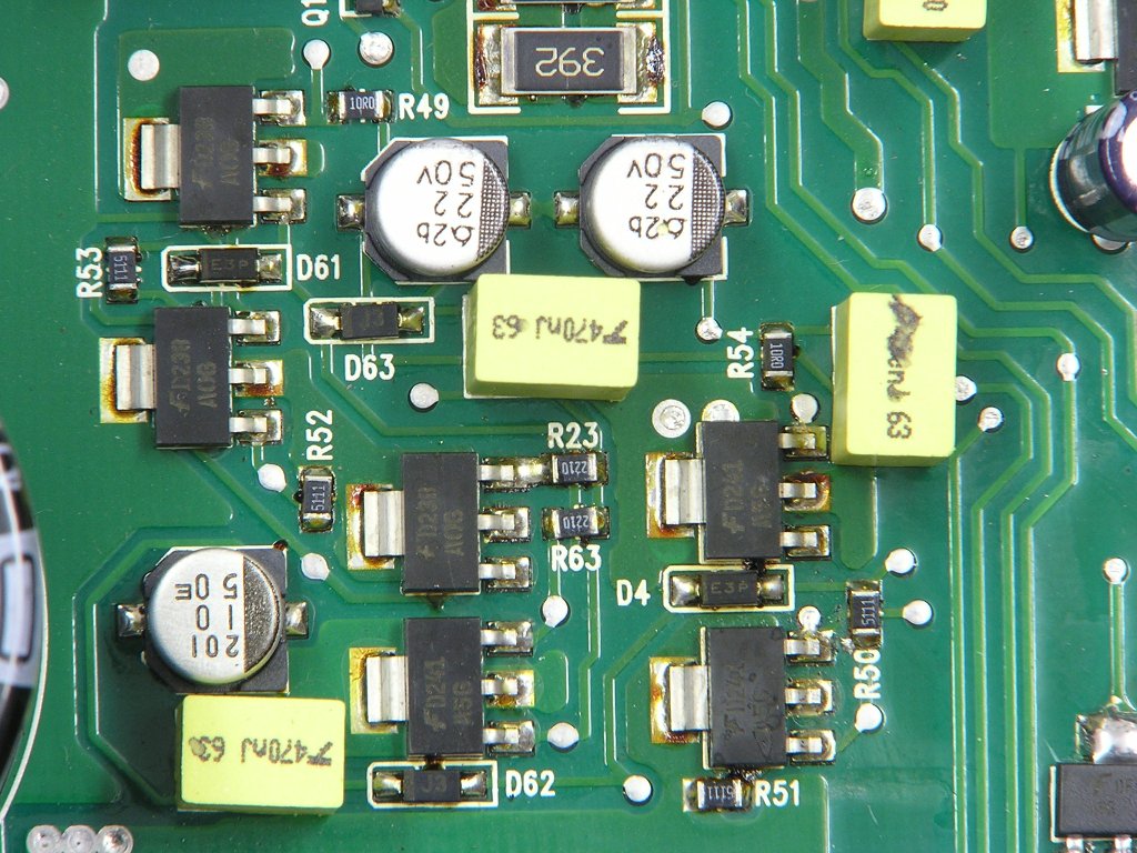

MTX Thunder 801D
Ok replaced the caps,gte resistors,drivers,power supply fets..
Amp will not power up..
Heres what i get on the 494
Pin 1:0.00
Pin 2:4.75
Pin 3:0.06
Pin 4:1..15
Pin 5:1.50
Pin 6:3.34
Pin 7:0.00
Pin 8:0.64
Pin 9:0.00
Pin 10:0.00
Pin 11:1.11
Pin 12:13.26
Pin 13:4.95
Pin 14:4.95
Pin 15:4.95
Pin 16:0.00
Any ideas??
See attached.
If you don't find any other faults, replace the A56s and resistors, remove the driver transformer and connect a 1k ohm resistor from the center tap of it to each of the outer windings (all of this on the side of the transformer connected to the A56s).
To make sure that the power supply FETs remain off, connect 1k resistors to the other side of the driver transformer as well (same configuration).
Do you see a drive signal on the outer legs of the driver transformer connected to the A56s?
