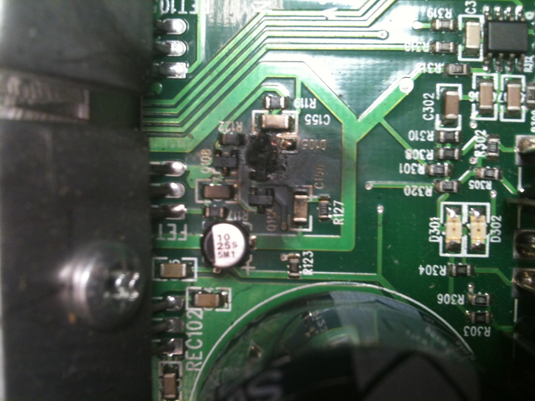

Hello...I have a Thunder 5601 with a burnt part on the board...Just wondering if someone hase a picture of the area, or whematic, so I can tell what the parts were...Here is the area..>Thanks
This is probably one of the 15v regulators. If so, this type of failure often applies high voltage to most of the op-amps and maybe the fan. This can cause a lot of damage.
