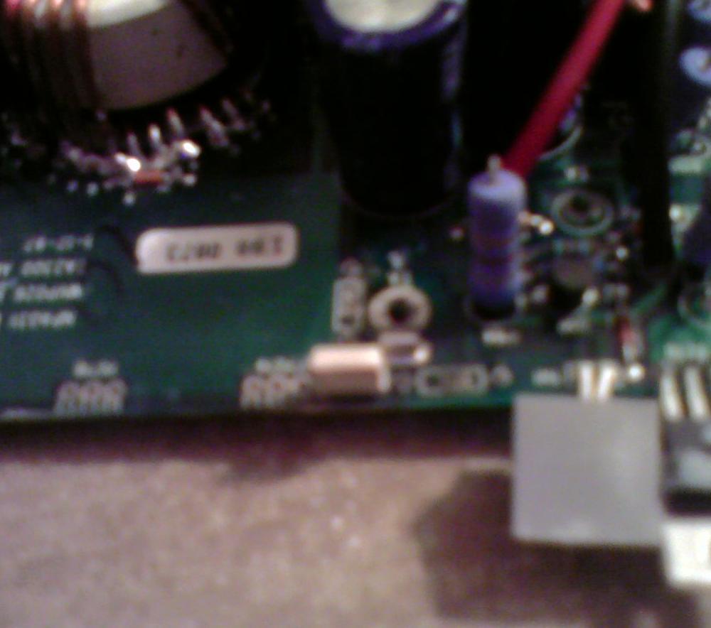

There were a couple of versions. If the amp is like the one in the attached image, the value is 22 ohms.

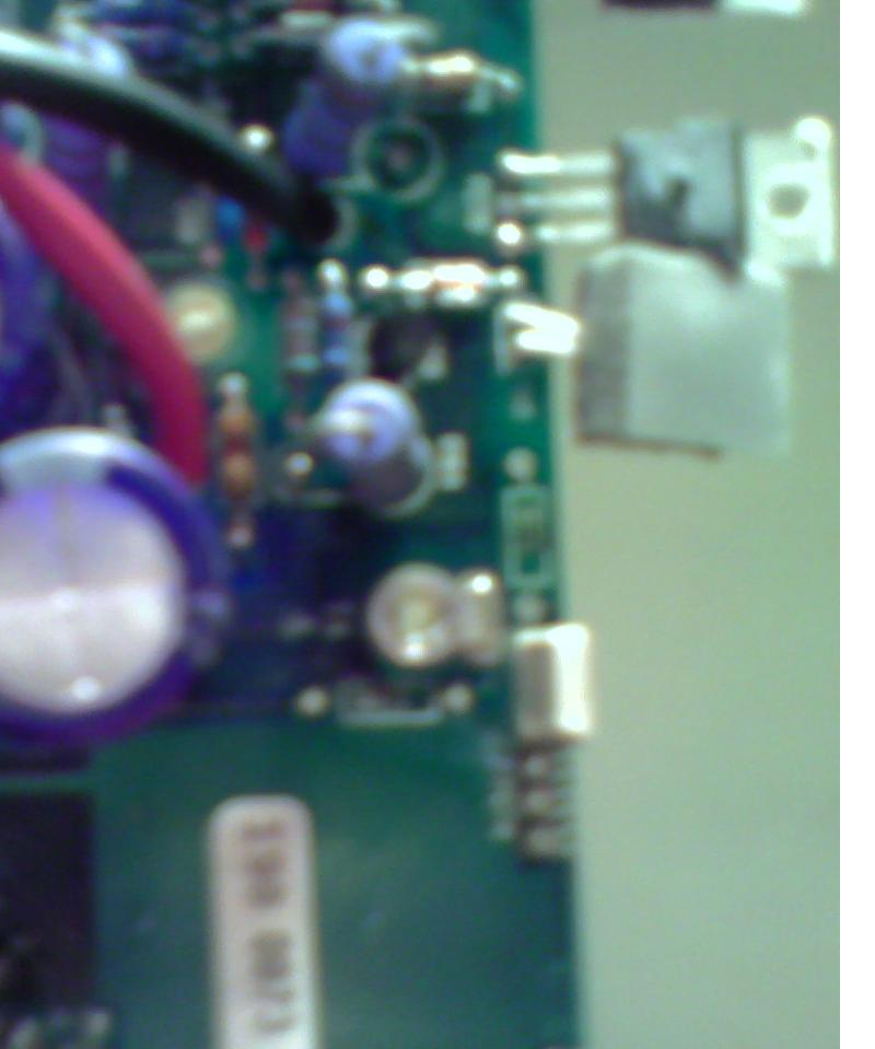

hey sorry for the poor picture its from my phone the 2 resistors i need are r171 and r172 i ohmed them and they both are 19 ohms 1/4 watt i have half watt 22 ohm here will those work? oh and i checked the rectifiers and they checked good and made sure i soldered them in good the resistors are in the pic they are the 2 between the ground screw you shold be able to see them where i took them out cause they was black i am gonna order so irf540s for the outputs ill get a few of them just in case and a few of irf3205s for the power supply. the amplifier blew up when one of the subs it was driving locked up then it just kept blowing fuses i tool it apart and all 4 power supply mosfets was cracked and 2 outputs were cracked. If you guys think of any other things i should look at feel free to respond
Thanks a Million you helped me out alot :)

The 1/2 watt 22 ohm resistors will work but you may as well order the correct resistor since you have to the order the other parts. I'd recommend a flameproof resistor. If you don't use flameproof resistors, mount the resistor ~1/4" from the board to prevent further damage to the board (if the amp fails again).

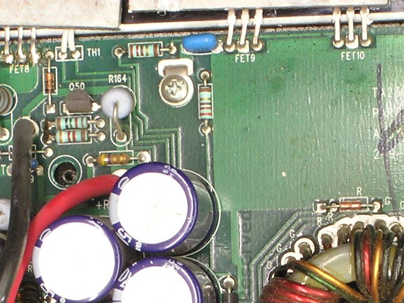

ok i found another resistor that was burnt it is r175 i removed it and ohmed it it says it is like 3 ohms that doesn't sound right, do you know what the value of r175 would be, it is right by the left speaker positive wire in the board

Is it too burrned to read the color bands?
On the images I have here, it looks like it may serve the same function as R164 on the other side of the board (across the positive and negative speaker terminals). If they are the same, maybe you can read the other one. If it is connected directly across the +/- speaker wires, it should be much higher than 3 ohms.
