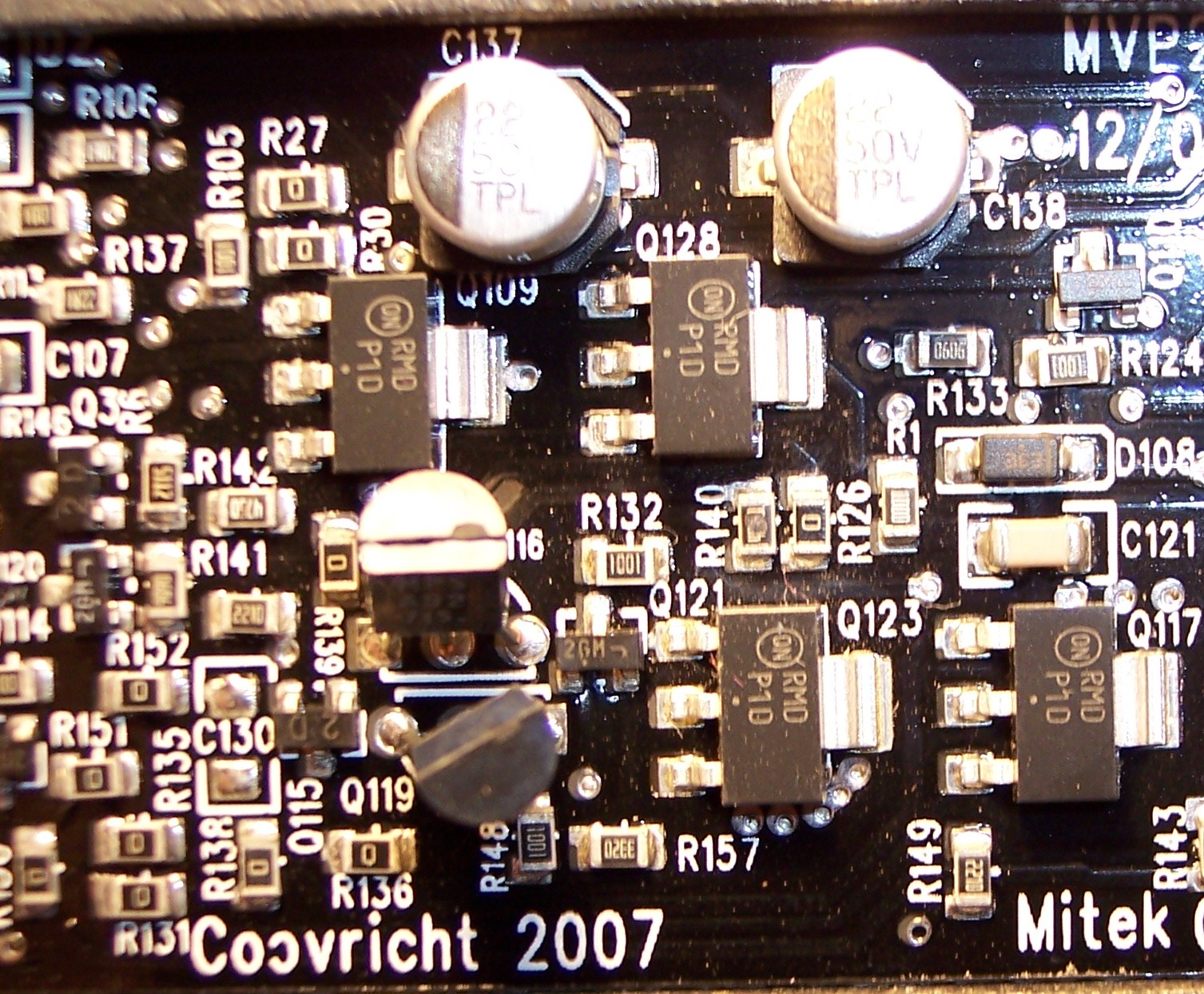

I have nothing at the output gates. While I was checking that, a resistor fell off of the driver board.
I think the equivalent of R118, a 1K Ohm resistor on the Sony print, is also a 1K Ohm resistor, R132, on my board and it is getting hot enough to melt the solder which caused it to fall off.

I measure from main ground, the negative rail, ~-44VDC, on one side of that resistor which is the same as the collector of a MMBTA56 which should be correct. I then measure ~+.850V on the other side which is also the same as the bases of the above MMBTA56 and the PZTA42, my MTX drivers. According to the Sony print I should be expecting ~5V dropped accross that resistor. Neither of those drivers are shorted between any leg and I measure ~0 Ohms between the PZTA42 collector to main ground, which should be correct also.
This now makes a total of three resistors that are getting hot enough to burn and melt the solder and this is without any of the outputs installed.
What should I be looking for next as I can't seem to find defective transistors, but I find higher than expected voltages accross those three resistors?

I am not exactly sure what I did, but today none of the resistors are heating up because they are dropping the expected voltages and I have the correct voltages at the various points I was checking from the above post. I also have my 100Hz signal at the high side gates.
