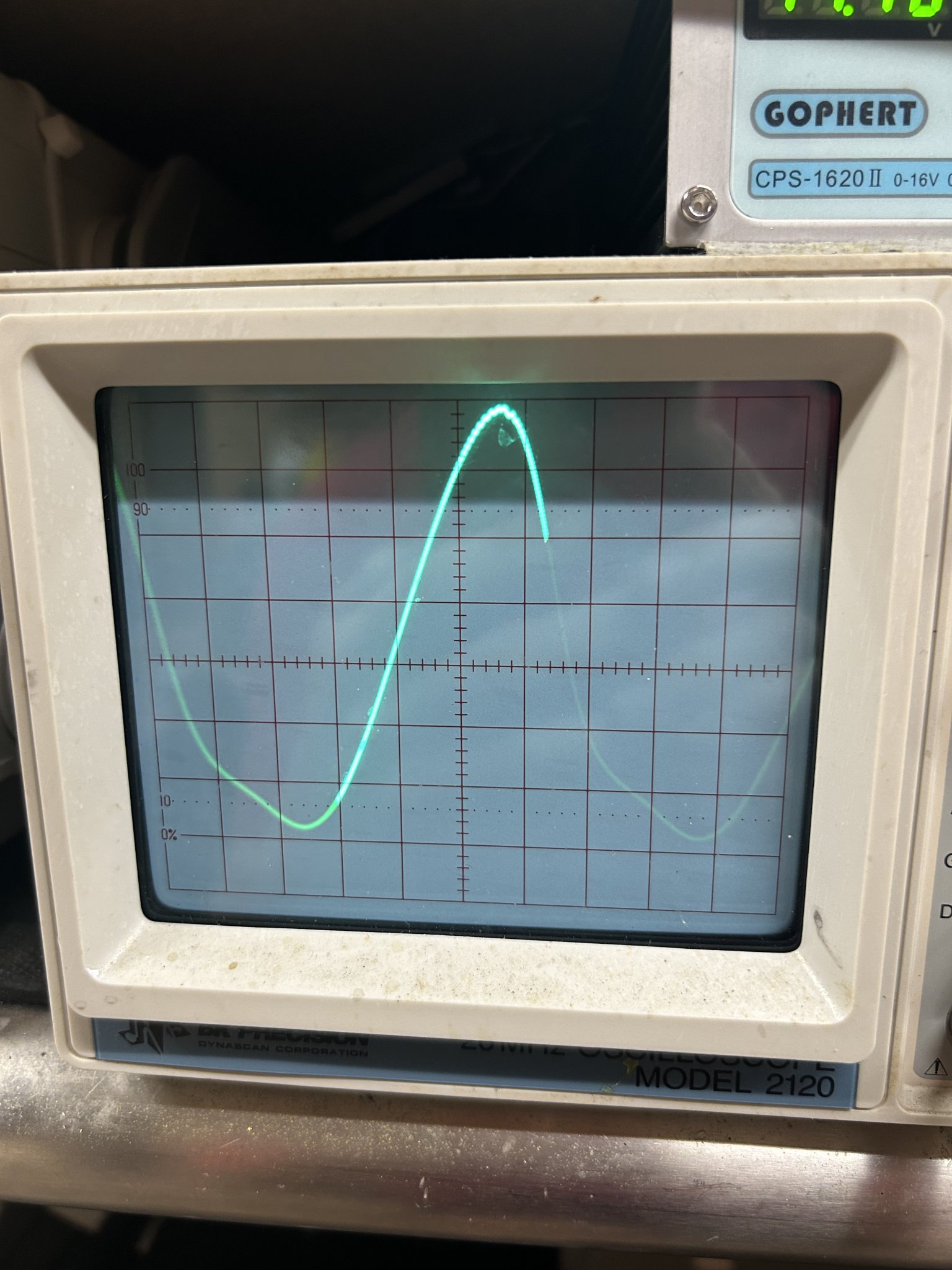

Under load, the amp immediately goes crazy with any kind of increased signal I cant even get the amp to pull more than 3.5A current before it goes berserk. Its not stable at all.
With no load, I can tell the output has a real problem. Heres a photo of my scope at 20v/Div, 1ms with a high voltage 75hz inputted sign wave. The bottom half of the output is messed up.
