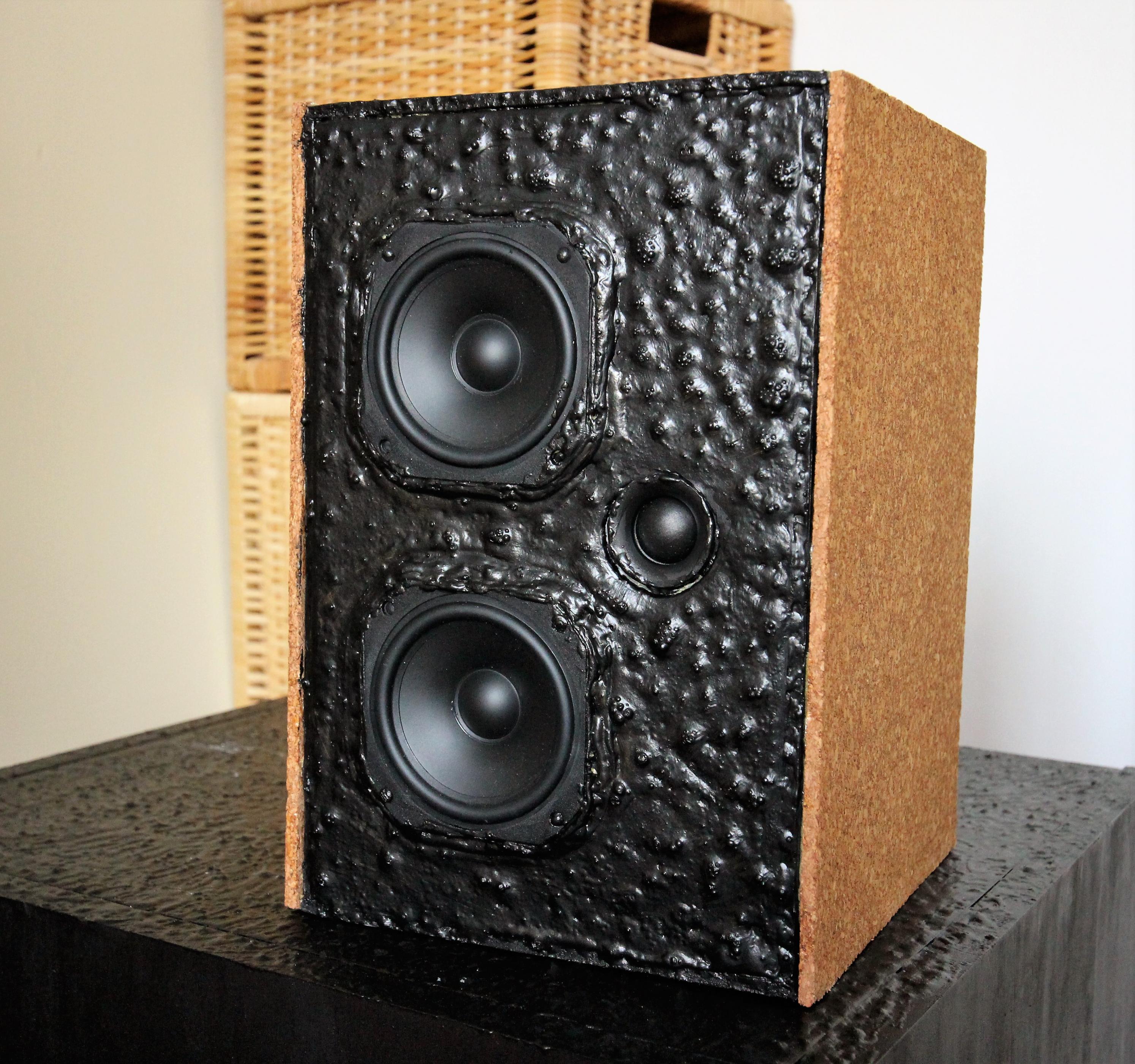

As i have the 4 TCFD9 drivers and about to mount on the boxes( which i have not glued pieces yet) was wondering if for nearfield listening position( 3 or 4 ft way) in my desk with subwoofer under my desk( to max 140 hz i beleive), .. if a tweeter is needed, or just toe them in to my listening position and if i should mount the drivers symmetrically on top of each other or non symmetrical as you suggest. i will be putting the cap between the lower and upper driver. should i make the while thing open or continue the bottom closed to have a bit of body or mid bass as i like rock too? should i put another cap before the first driver(?? value) to cut off lower frequencies to the both drivers in each speaker so they are more relaxed or go as original design, full range bottom driver, upper with the.20 uf cap? as i'm about to do this, might as well take your cues to improve the design for desktop application...Thanks again.

Is tweeter needed? Well, that is up to you. Have you read my first post? Answer is right there. I built Nola and I did not like the result. Even you use cap on one TC9, still you got two drivers projecting heights...is it ok with you? Only you can know. For me that is big no-no. So I built MTM, hence this thread. You can built what I offer, as close as to what I described, or you can built Nola, that is up to you.
It seems to me that an open back enclosure with sides all around would have substantial resonant cavity effect on the rear output... regardless of how much padding you put in the box. Was this not a problem?Yes, I did, few times!
If you mount 2 TC9's in the same box, and put a cap in series with one of them, you will have significant phase cancellation issues, because reactive elements (caps and coils) cause time shift or phase shift (same thing). You will have created a comb filter mechanism. That only works if you also put a coil in series with the other TC9 (for a full crossover network). But that would be foolish too. If you're going to put 2 TC9's in the same box, I'd wire them in parallel (I hope you bought the 8 ohm versions), and add a tweeter (the ND20 twtr is very good) and a crossover that has a crossover frequency at about 6kHZ. And I don't recommend an open baffle enclosure. They require substantial active EQ to work right, or you'll have very little lower mid and bass.Thank you,

If one puts a bipolar electroytic capacitor of say 160 uF to 200 uF in series with the parallel combination of the TC9's that should trim off the low frequency response and help to alleviate the cavity resonance produced by the open back cabinet.
You would have to experiment with the capacitance value in order to get the desired result though. It's worth a try.

Simple answer is no. I see no such thing on fr response. I measured response numerous time while I was optimizing crossover. No resonant cavity effect. I have no stuffing in the back, its fully open.

This is what i would recommend...0.2mH

So, go with the .20mh?
And do you have a preference between .33 and .47 uf cap?

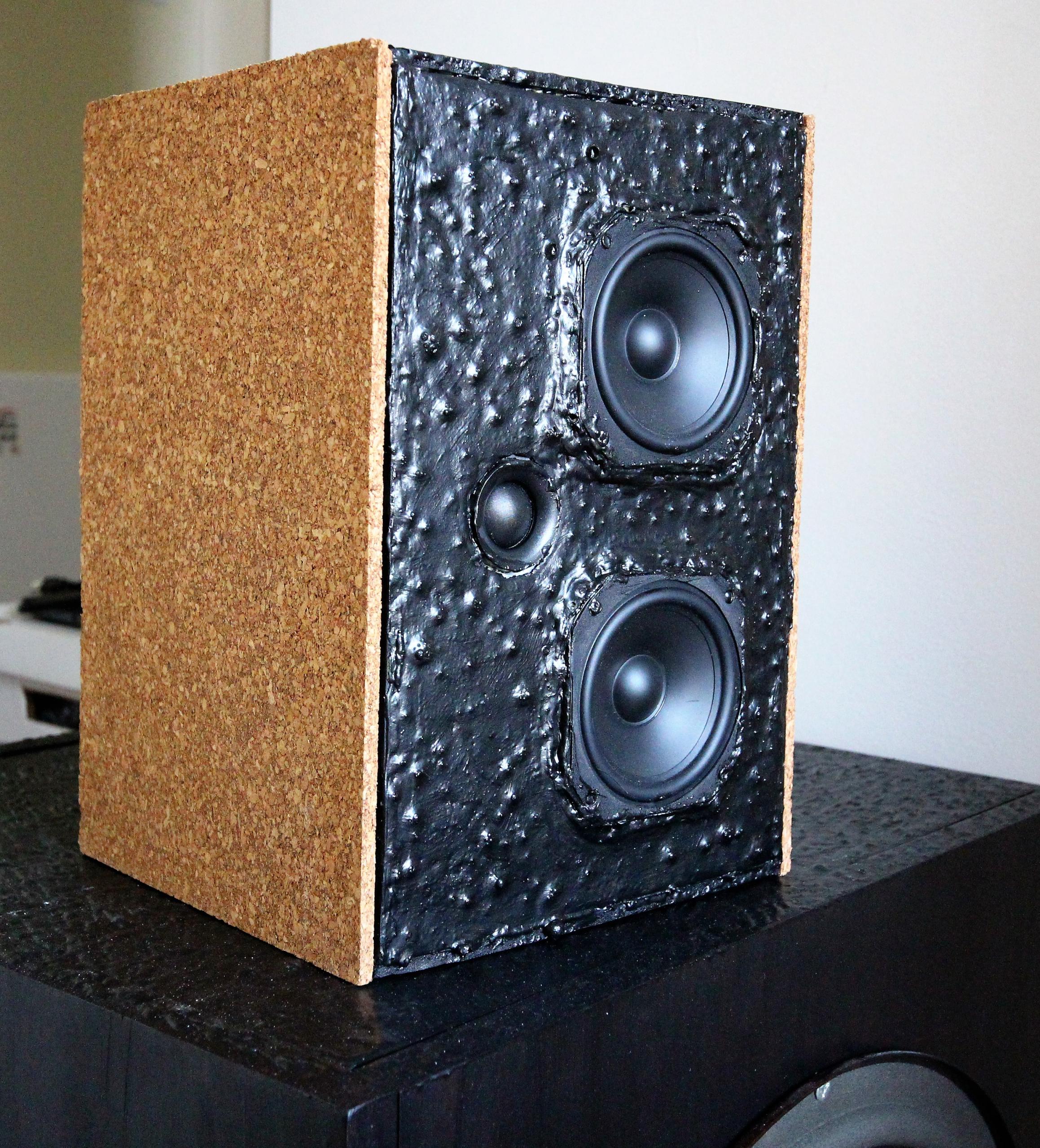

Yes, if you keep back open, it helps to place it further from the wall. I think it helps speakers in general, no matter what construction, to keep away from walls.
I use speakers without backwall, because I do not need the box to extend the low end, I only use them 160Hz and up...
