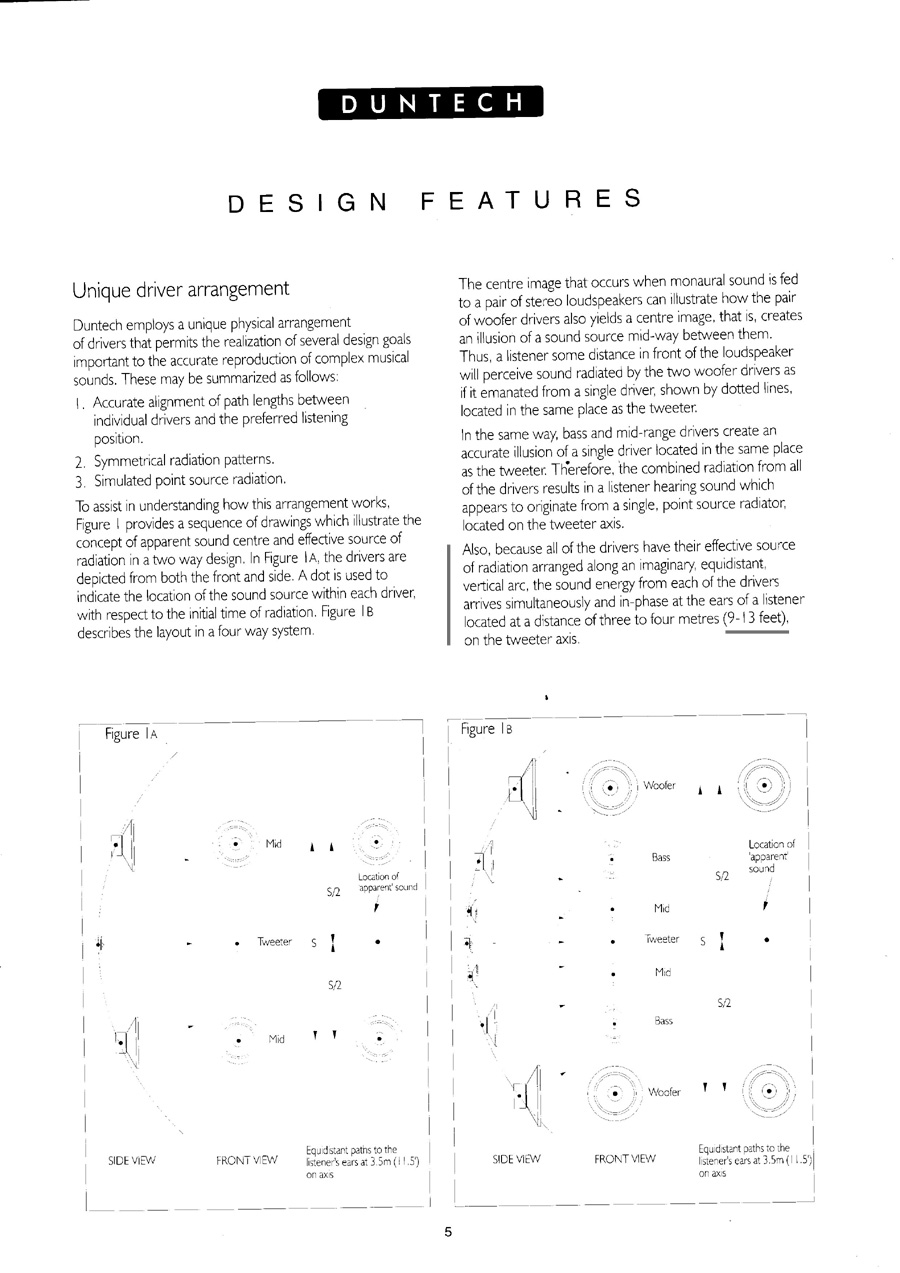

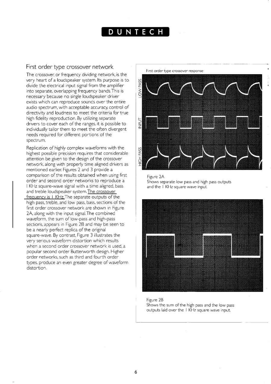

John designed these speakers, Duntech Classic Series C500 - attached excerpt from the user manual. I am original owner for 23 years now.
MTM, drivers are 2x vifa p13wh-00-08 and seas excel t25cf001 tweeter.
Tweeter is phase reversed, XO is 5uF cap to the tweeter, mids run full range (there is some small value of series resistance <6ohms).
Document mentions 1kHz XO point, and 9-13 feet with 11.5ft considered as optimal (for this speaker).
Transparent, dynamic and easy to drive.
Hanze

That's a 5" driver crossing at 1khz, recommended 9 - 13' away.
I don't think a mtm with 6.5's would work well sitting at 7-8', even crossed @ 1,300hz.

Do you know why the tweeter was reverse phase ?
I thought it would need positive connection to woof and tweet on a 6db filter..........

As to why, I dunno - but I did connect it up in phase an it sounded too bright. Guess it just 'works better the other way'.
Also, reading back - I'm unsure as to whether the XO is 1kHz for purpose of his example (in context it could read that way), or with regard to the actual speaker itself. Never the less, these drivers have been around for a while and someone more inclined than myself (I simply dont know how, but would be interested to know...) should be able to work out the XO frequency based on driver spec and the detail outlined above, as before its just a 5uF cap..
Cheers, Hanze
