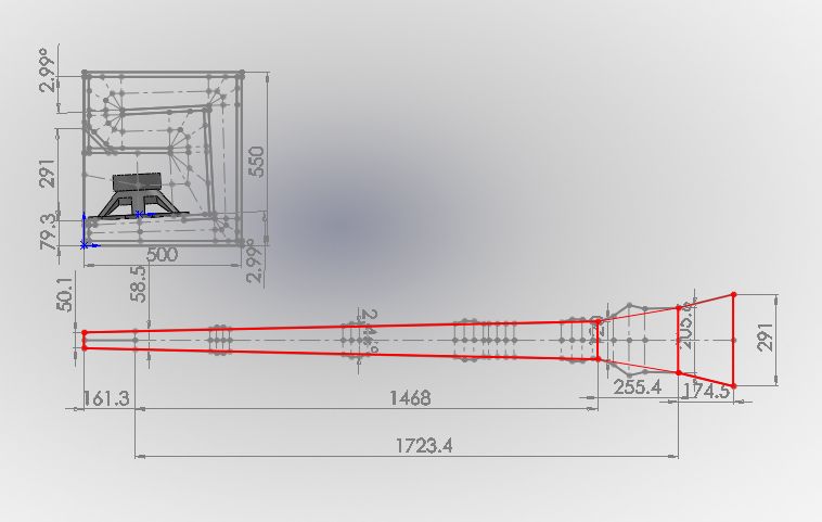

The Tham 12 is tiny.
On Martinsons blog the Tham12 is shown with a sim of over 88 litres
This is despite the actual internal volume being 74.3 litres without any bracing or driver!
The path length is also shorter than shown on the blog.
With the PD 12SB 30 I would expect 98db at 75hz in a 2pi sim

Ah, that might explain the difference. I haven't seen any measurements of actual THAM12 builds, only variations on the design similar to what I've discussed.
Hi Xoc1,On Martinsons blog the Tham12 is shown with a sim of over 88 litres. This is despite the actual internal volume being 74.3 litres without any bracing or driver! The path length is also shorter than shown on the blog.
With the PD 12SB 30 I would expect 98db at 75hz in a 2pi sim.
I agree with your model. Based on measurements of the Tham12 I found on another forum I made a re-model. The measurement was done with a 18Sound 12LW1400 driver which I used to re-model it.
