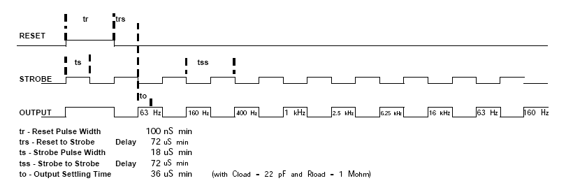

Feed the 4017 from your clock, using glue logic to have that reset after count 7
Output from the MSGEQ7 is time division multiplexed analogue, so you need to separate the 7 outputs with 7 sample and hold circuits, one for each driver chip, enabled by the count from the 4017.
Signal input to the LM3915 on pin 5 is high impedance, so your sample and hold circuits may need to be just a fet, a diode and a capacitor.
Alternatively, you could ditch the 4017 and do the count in binary, then use a HEF4051B (de)multiplexer, with a small cap to ground on each output, feeding the LM3915s

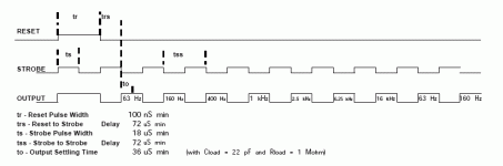

Don't forget that you need to provide a reset pulse as well as the strobe.
