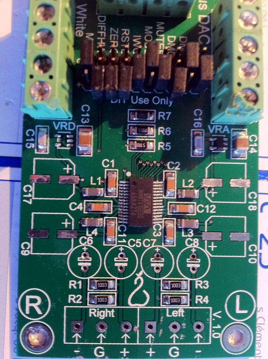

Hi
I've bought some times ago a second Opus module to a DIYer.
He practiced some experiment on it : no more output caps, bypassed, VRD chip missing, SMD caps saddly hurted...
BTW I'm looking for some advices/hints for the missing part :
1° - Replacing VRD reg : is it 3.3 or 5V chip ?
In both cases, could I swap NS chip with Ti one's ? (same SOT-23 package)
I've got some left from previous USB/DAC.
2° - Output caps : 22uF/16v D:5mm - Lead : 2 mm
Are ELNA OS-Con suitable vs Elna ?
I'll soon add pic of the board ; unexpected, but there's a WM8741 on it

VRD is 3.3V. The ti part will probably be fine, as long as it is low drop-out.
These caps will have a big impact on the sound, as they are directly in the audio path. The oscons are fine, technically, but your ears will need to decide on the sound quality.

Ti's part planned as replacement for VRD is TPS79333DBVR (sot-23).
I confirm it's a low drop-out LDO fixed reg 3.3V.

Are you talking about C9,10,17,18? Those can be organic-compond (oscon) caps (what I ship with now).
I was refering to the output caps C5-C8.
No problem for me for using Oscon at C9,10,17,18
Is 16V is a minimal value for all of them ?
22uF/25V (C5-C8) & 100uF/16V (C9,10,17,18)
C 5 - 8

AS in the title C 5- 8 . Why don,t you go for the 10 uf. 35 V ?
