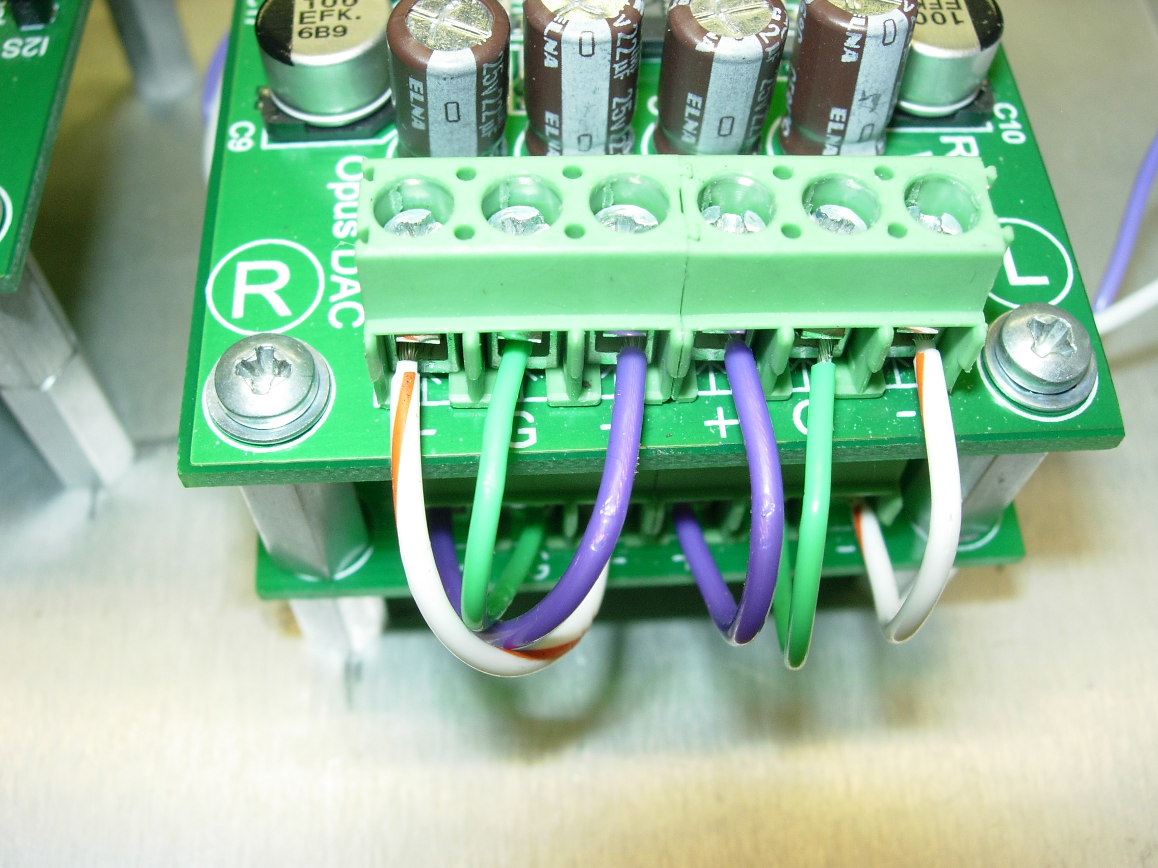

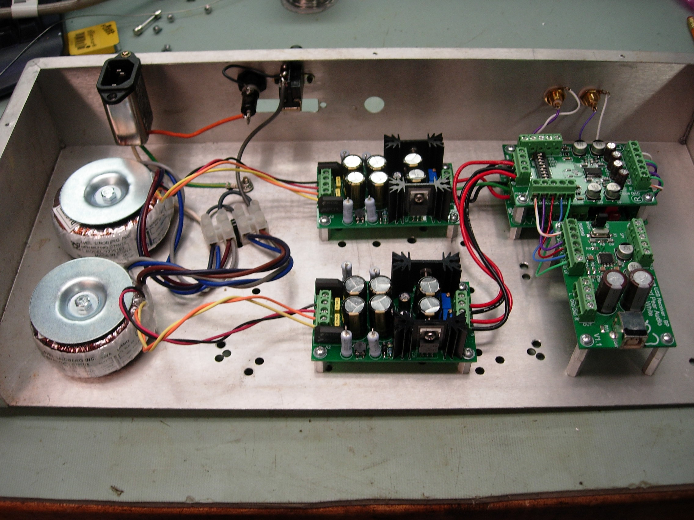

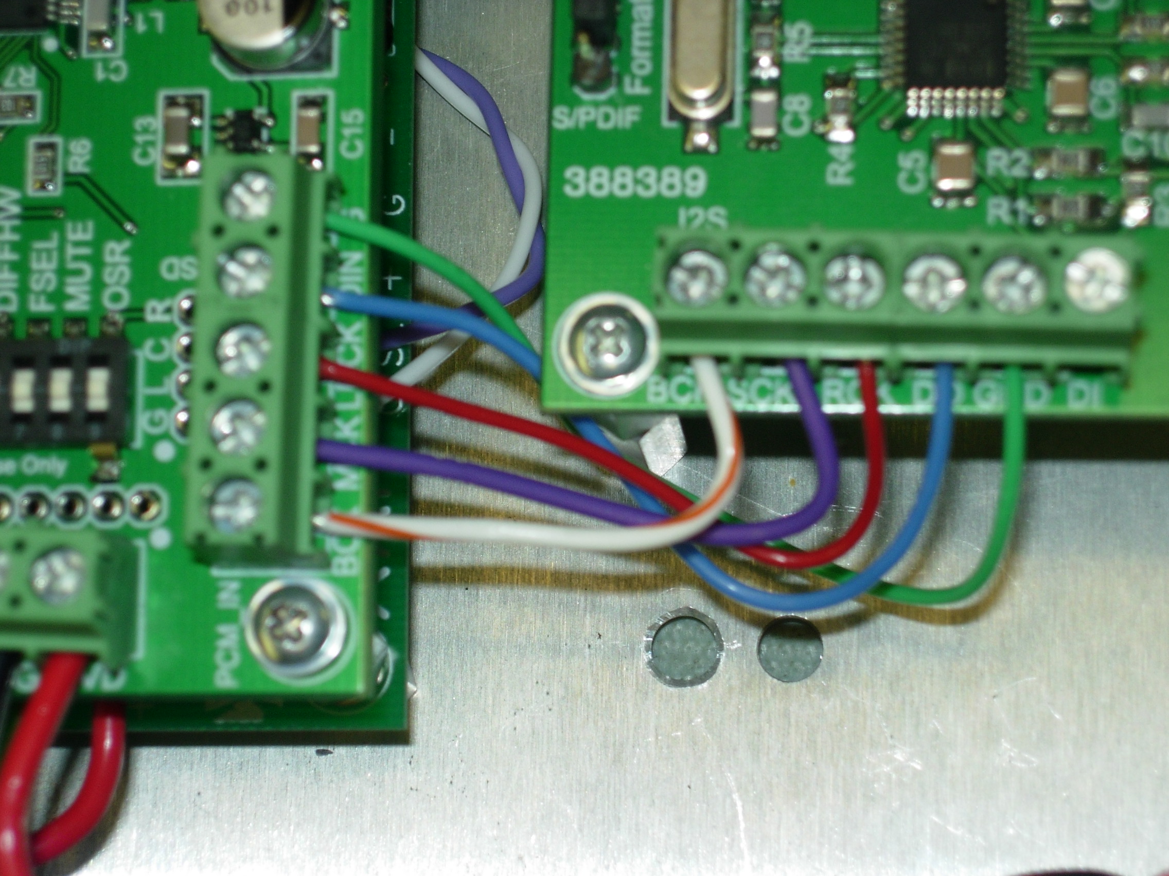

After letting my Opus DAC sit in a drawer for over a year I finally decided to put everything in a temporary chassis. I purchased it as a dual mono with Ivy, however I am currently running (trying) it in stereo mode with only 1 dac board.
OK, so I ordered transformers last week from TP and got them 2 days later.
Thanks for the quick service Brian
Everythig went together with no problems, I set the voltages to 15V for anolog and 7.5V for digital. Plugged it into a windoze xp machine, it was recognized right away, I thought WOW that was easy.
Not so much. I have hardly any volume, with my ear against the speaker and volume maxed out I only hear a very faint hint of the music.
I have attached a few pics.
Any ideas on what I screwed up?

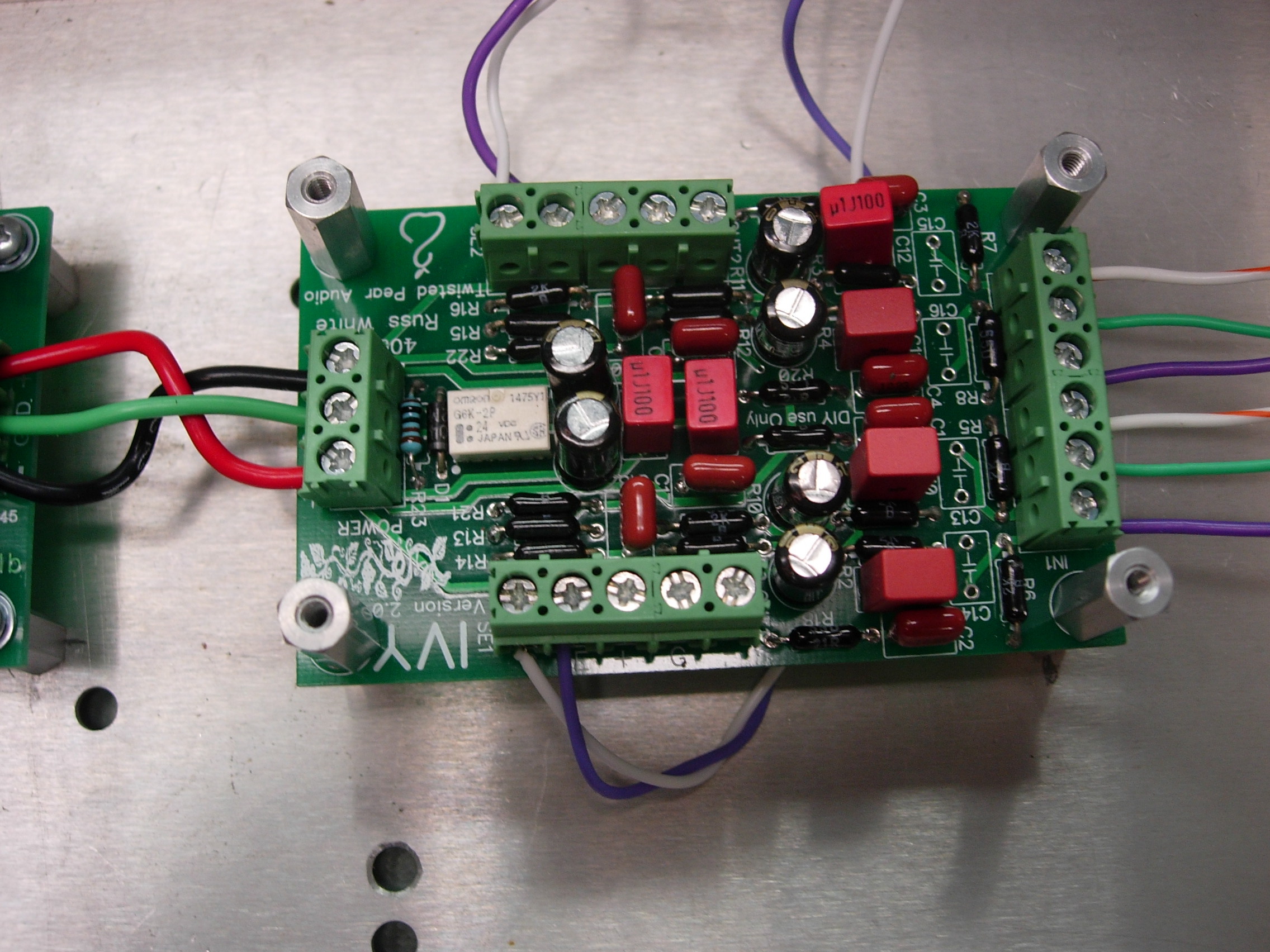

I would look at the IVY. Make sure the relay is activating. The the voltage into the IVY is too low the relay will not activate.
Also check the that relay is not in backward.
If it is not your output will always be shunted to GND.
One other note. When using the IVY you can short the output caps on the Opus. I usually omit them and just use wire jumpers from clipped resistor leads or such. You will get better results this way. I highly recommend it.
Also you could try taking +OUT and GND from the balanced output. If this gets you sound then the issue is with the BAL/SE side of things. Very likely the relay.
Russ, Thank you very much for the quick reply.
I took the signal from the balanced output on 1 channel and it has volume now, however it only had about half the volume of my cd player.
The relay is installed with the text opposite of the pcb text. I have attached a pic
I will turn the voltage up on the Ivy(1-2V) a bit to see what happens.
If I had a balanced preamp I would probably just go direct from the Opus.
Thanks again, Jim

OK, I will do that in the morning, and post what I find. My eyes need a restOk, The next thing to check is the area on the bottom around IC3.
Again thanks for your help.
Jim
