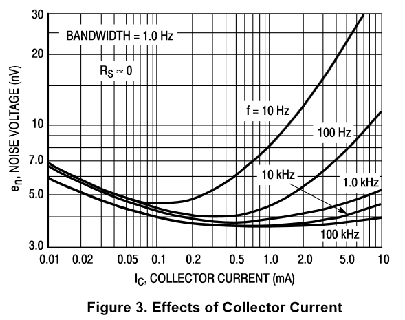

Here's the MPSA18 datasheet http://www.onsemi.com/pub_link/Collateral/MPSA18-D.PDF
I guess you're talking about Figure 2. Looks like noise bottoms out at 3.6 nv rt hz which is equivalent to an 810 ohm resistor; is that your estimate of Rbb?
Oops, yes you're right! I posted Figure 2 of the MPSA18 datashseet, but Figure 3 might be closer to what member rayfutrell had in mind. Interestingly the "bottom out" point is about the same, approx 3.6 nv rt hz, leading to the same estimate of Rbb, 810 ohms. But 810 ohms seems awfully high.The figure you posted shows the noise voltage increasing with current rather than decreasing.
This 2N5087 spec sheet gives a better example of what I am suggesting. See figure 12 of En vs Ic.
http://www.fairchildsemi.com/ds/MM/MMBT5087.pdf
I think the calculated MPSA18 Rbb is about right. I have some measured data I will try to find. I recall that the MPSA18 Rbb was not very low for a supposed low noise transistor.
