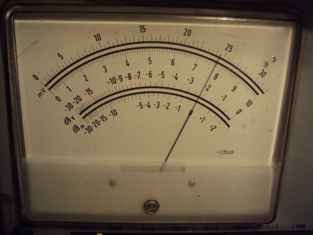

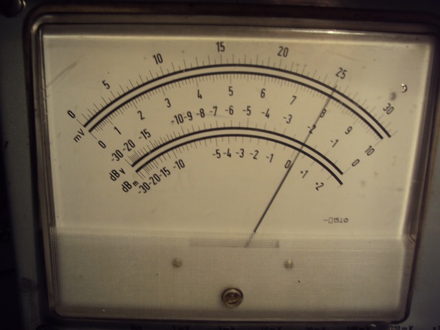

Anyway lets explore something i found. Feeding in a sine, triangle or square into the bypass and then into any of the 4 caps i installed i found a small jump in level athough the shape of the signal was not visually altered. I then checked the level difference with my tube meter and found that the bypass gave around 0.2dB more level. I checked that at 1kHz, 100kHz and 1MHz and it was always the same. I whould have understood that better at lower frequencies when the high pass action comes into play. So the straight bypass may not be a good refference because the ear has a tendency to prefer the louder signal. How well level has to be matched seems to have changed over the last 40 years. I learned in the 70th when i studied Telecomunications that 3dB is "just well audible" and 1dB is " barely detectable". When i now read for example the literature about the Heron Phonostage or trust what Siegfried Linkwitz is currently experiencing with his Orion 3.2, then the threshold is currently identified at better then 0.2dB. Where does that lead us ? Is that again the old argument about easy detection of small differences in LINEAR distortion ?

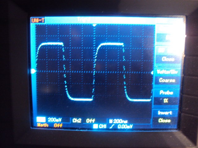

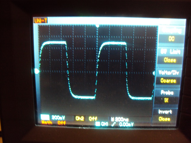

Anyway, here are the scope shots and the meter readings. Bypass, cap, from left to right.

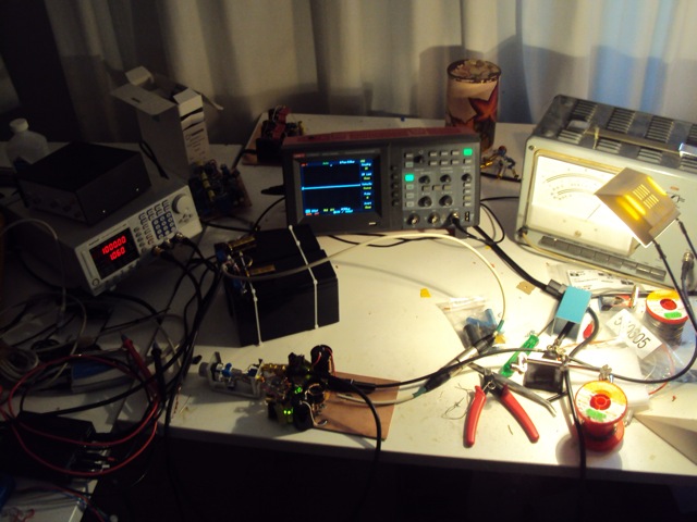

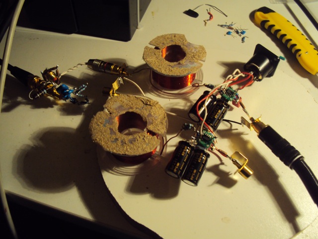

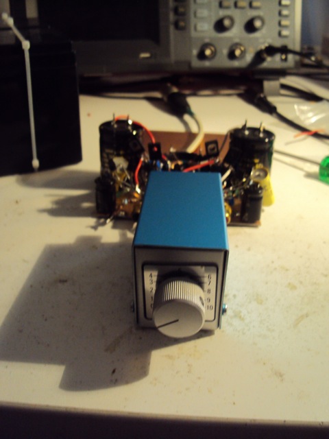

I build the input stage of the Simple Inductive Passive RIAA. I decided to do the mid-bass equalization right in the inverted input stage. The 1kHz gain is setup as 30dB and i will add a second inverted stage with 30dB of gain. Yes i know, it looks like Arte Powere in the High End Emergency Room but i did not have a fitting case for the rather big coils so i build it right in the open on a chip board plate. Heck, the ETF begins in less then a week and i whould like to show something unusual concerning phonostages. I measured it and it amplifies and i could squeze out a half decent squarewave at 1kHz. The level though is very small because i modified my invers RIAA to have an output impendance of 6.8Ohm. That way the input signal is very small and the aplification is only 30dB.
Lets see what happens when i add the second stage. If it works, i will publish a schematic.

Back to my Simple Passive Inductive RIAA, i ran into some offset problems. I am using the ADA4898 at the input because it likes to drive low value resistors. "Conventional" Phono Clone topologies use a feedback resistor not much smaller then 1kOhm but this whould give me too much gain in the input stage. The DC gain of my circuit is around 300 and the input offset voltage of the ADA4898 is specified as 20mV typical and somewhat over 100mV maximum. I landed at around -8V so this is in the ballpark. I will try a compensation resistor bypassed by a big Elcap. I could use a servo but time is short to ETF and this is only a prove of concept. If it humms i have some MU Metal sheets but i will not go into any length to win a new world record here in the few days that are left.

The idea to do the mid-bass EQ in the second stage works. The offset i get is 0.3V now and a good cap at the output is all i needed to manage that. The 1kHz square wave looks only half as bad as i expected. A very slight ultrasonic overshot and a response that leans just a bit to deeper regions. I can live with that without tweeking. See the schematic. I also will post a screenshot later.
Why is R13 so small you could ask ? First it does not contribute much noise that way and second the ADA4898 can swing 40mA clean so is able to do 6V into 150 Ohm and i think that this is more then enough considering that the signal is down ca.20dB @ 20kHz by action of the input coil. The second Opamp is an OPA134 i rescued from the waiste bin. It is not my absolute favorite but i think in this inverted configuration it is fine and being a Fet input amp, offset is low.
