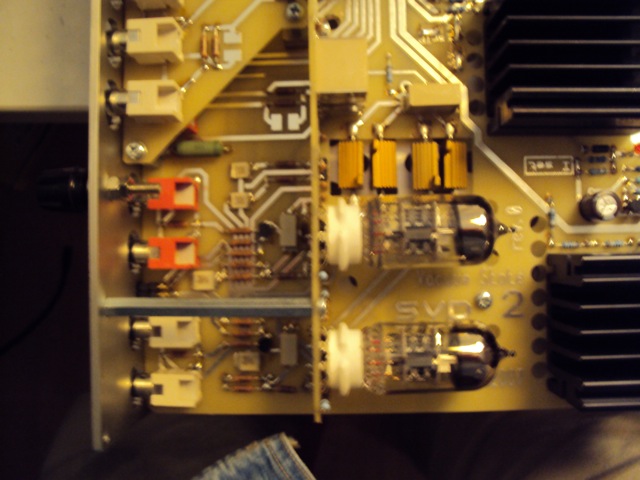

I will listen tonight to Allens creations. I have also the small preamp at home now and i will maesure it. The big one is a little bit too big to put on my bench thogh.
The first thing i did is making basic measuements on Allens small Pramp. It is beautifully made, inside and out. The phonostage that interests me most has a Fet ( 2SK10) - tube cascode. I spotted some very modern SMD caps. I asume they have a PPS dielectric.
See the photo of the phono input.

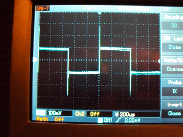

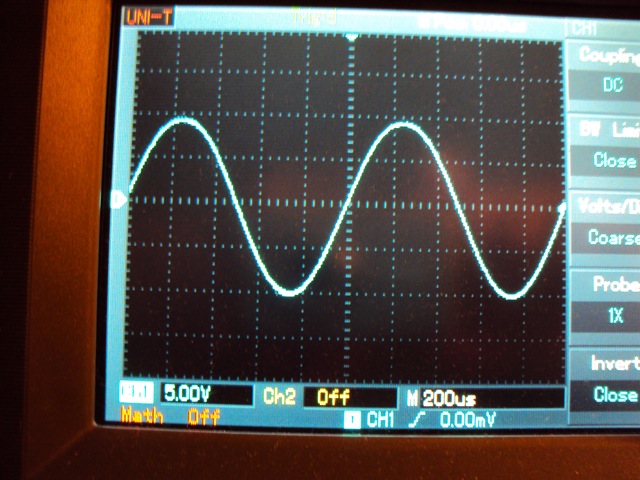

I measured RIAA precission with my RIAA encoder. The squarewave looks nicely square but has more overshot then the JG-Self. Allen implements the Neumann Pole, so i asume that comes from that. See the picture taken from the output of the line stage.
Maximum output voltage before clipping is + - 10V.
