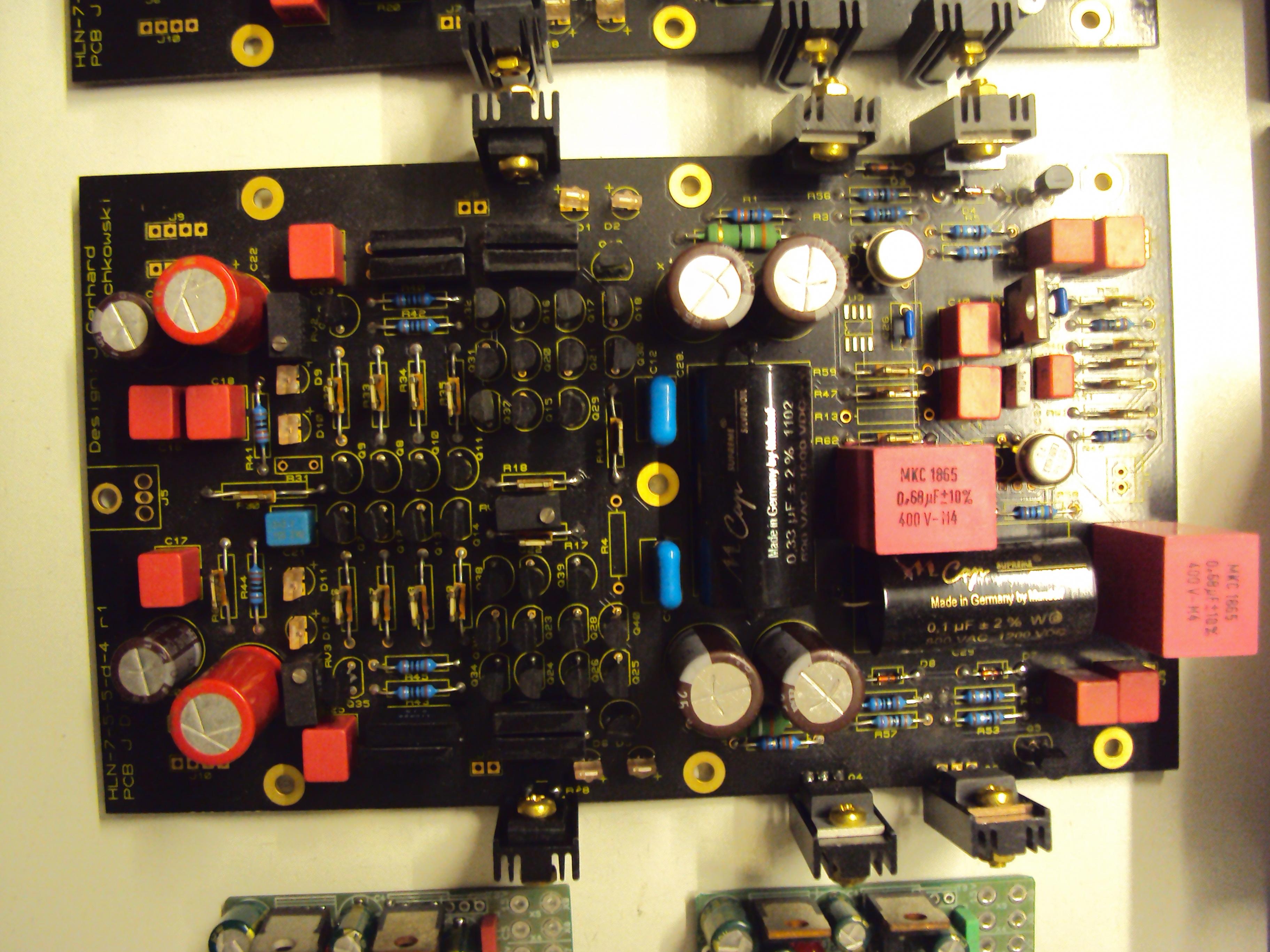

Hi Joachim,
I understand a double cascode, but why a triple cascode in this case? I assume the pot is to achieve low DC offset?
The loading before the buffer looks complex. Was this a circuit designed in simulation? From what I know of similar circuitry, this can be mighty fast.
-Chris
The upper transistors form a CCS. That gives more gain.
The loading are the RIAA components. They form a frequency dependent voltage devider.
We have discussed this option in the Paradise circuit.
What i like with this circuit is that distortion falls with frequency and level.
I call that monotonic. It is a bit like the ear.
High negative feedback circuits are kind of the oposite although distortion in an absolute sense can be extremely low ( Opamps ).
Usually with a folded cascode w/CCS most of the gain is lost through the C-B junction, not through the emitter. So adding another cascode would just mean the gain is lost through the new cascode's base. A Hawksford or Baxandall cascode would perform that function better.
The C1815/A1015 simulator models are probably not any good.
It looks like R20 makes R18 act like a 2200k resistor.
The problem with the Hawsford and Baxandall is that you run into DC offset.
A small mismatch makes the supply patently clamp to one side.
Maybe the circuit can be bettered but it works very well and sounds good with a real simple design.
When we made the Paradise we ran into the same problem :
A " too good " mirror made the circuit nearly imposible to stabilize.
I made a version of the Paradise called Opus Magnum. It was DC coupled and had a Gilbert 2 I mirror. That mirror can be ( theoretical ) set to infinite output impedance.
We needed several years with 4 engineers to stabilize it. We had to give up much of the output impedance by modifying the circuit, even with servo. That teached me a lot of what is desirable and what is managegable.
i found some pictures. It is a complex animal.
