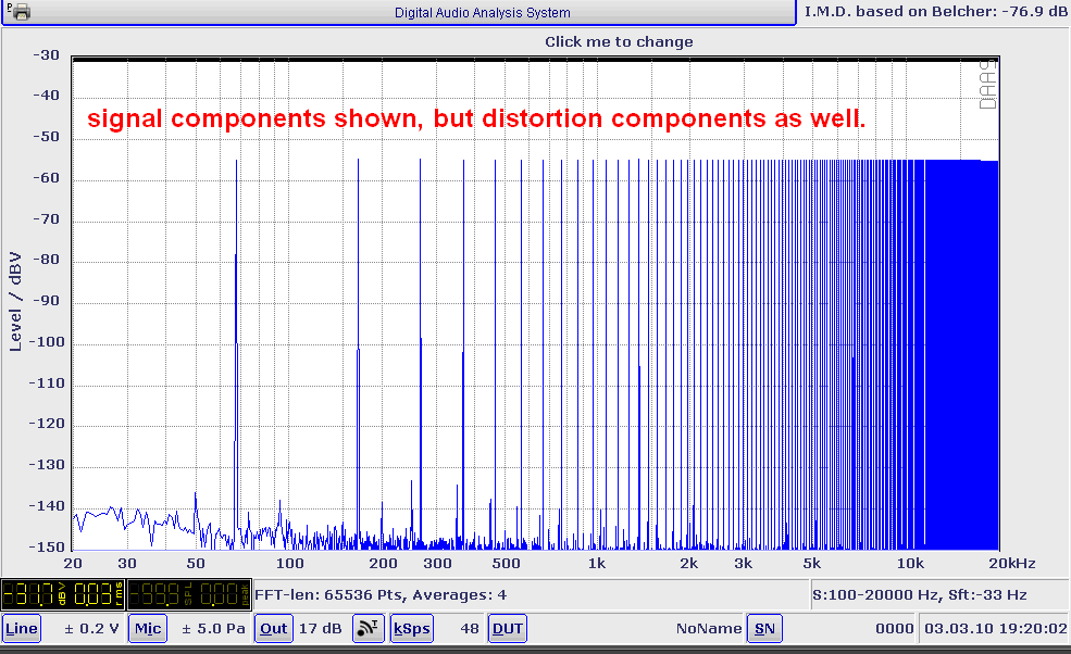

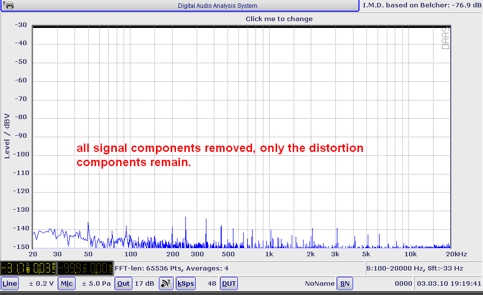

Belcher test is the one suggested by R.A. Belcher. Here is a rough explanation (Belcher.pdf)
Measurement is shown in the pictures Belcher2.gif (with stimuli shown)
and Belcher2.gif (stimuli removed)

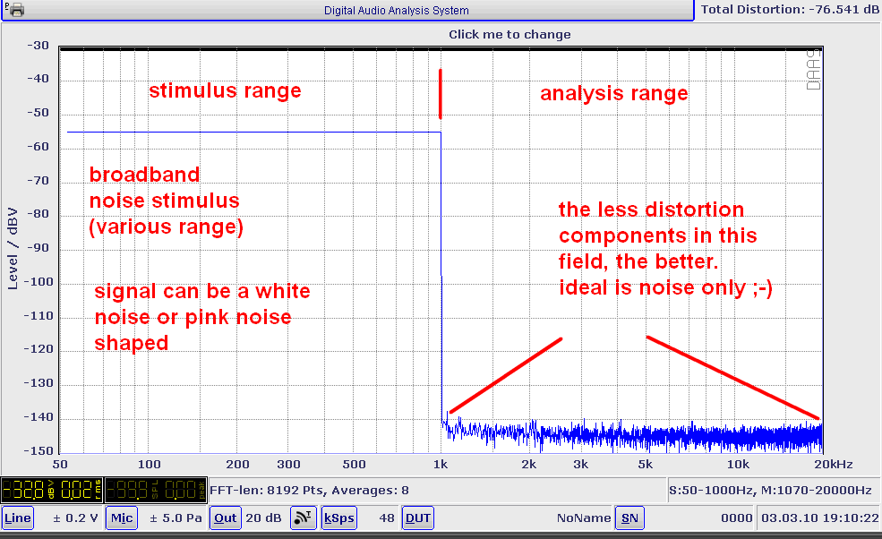

One of my favorites is the noise distortion measurement ( it is even more sensitive to distortions )
It is a kind of THD measurement using a band limited noise carrier as test signal. The level outside the noise carrier band is measured and related to the total level. Stimulus and analysis range are separated by a kind of brick wall filter with Kaiser window (highest side lobe damping).
The picture noisedistortion.gif shows the measurement.
I hope all data are legible, this board is a bit tricky, not sure if it works.
