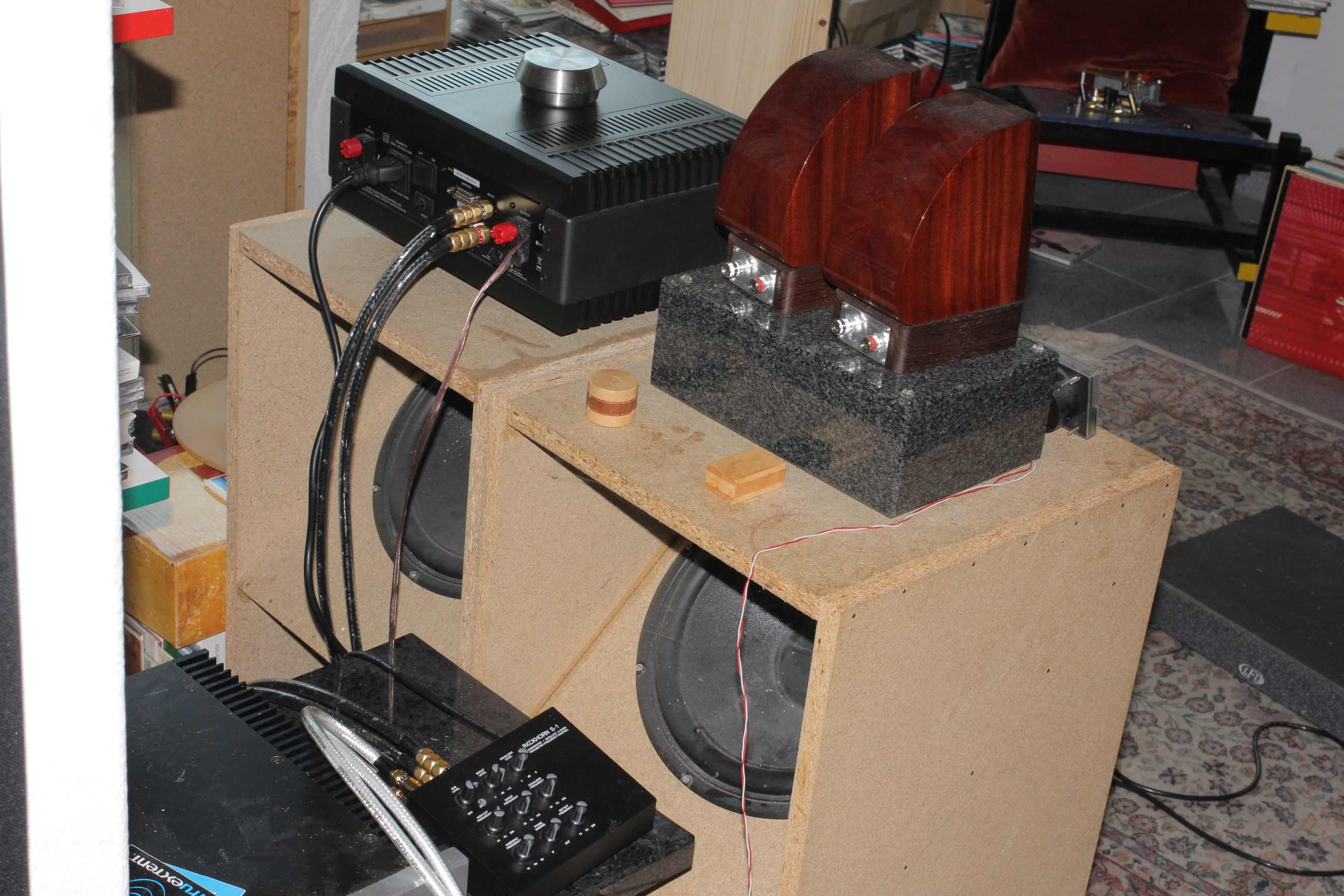

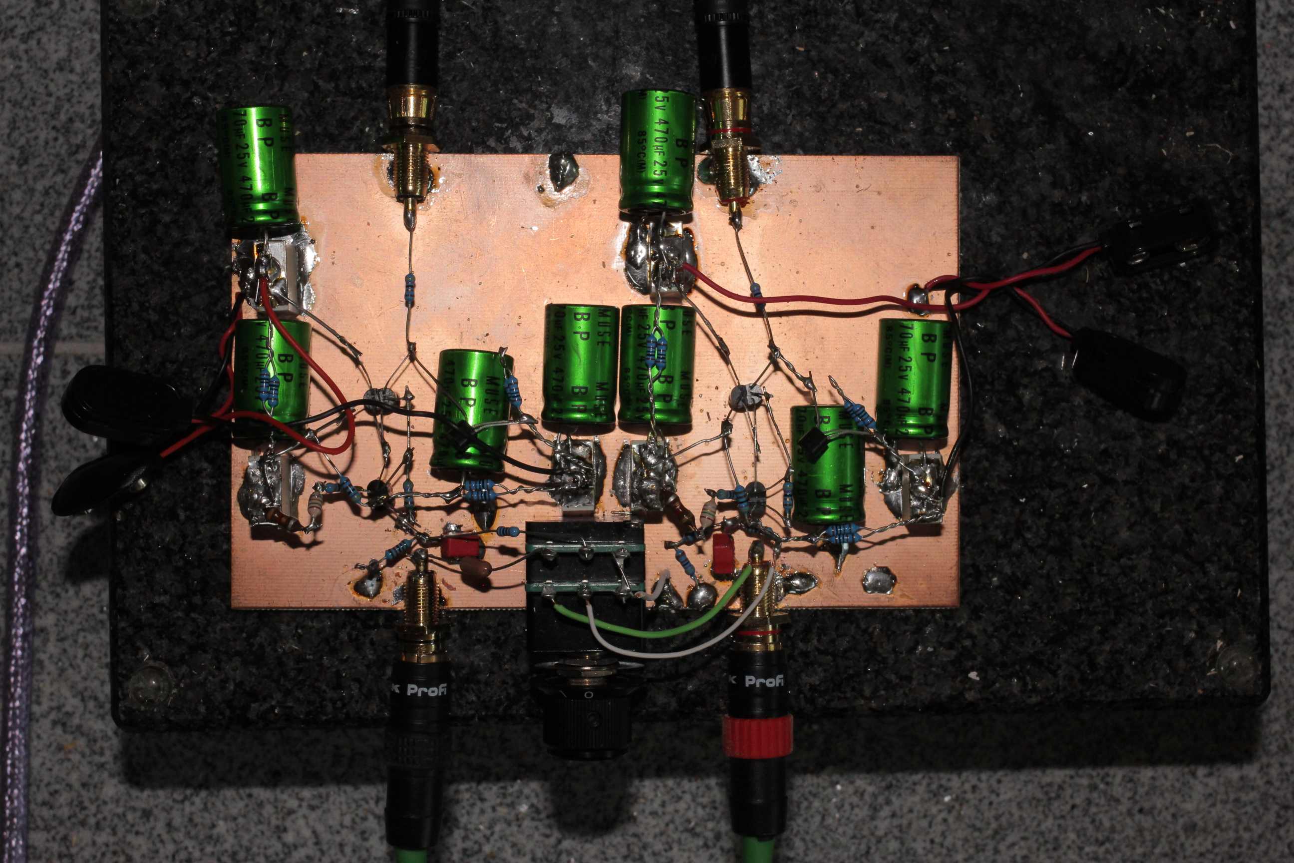

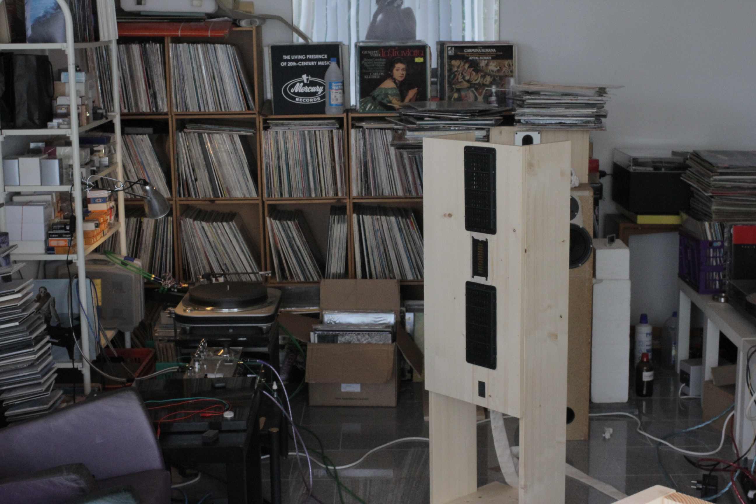

Today is Keantoken buffer day. That buffer really bugged me. At first i had several HickUps. With the first version one channel went bust. I repaired it by changing the transistors ( i thought ), it worked and went bust again after i had switched the batteries off and on again. Then i build the latest version. It worked. Then i made a small change to the layout and it stopped to work on both channels ! I exchanged some PMs with Kean.
I was prepared to send it over but i got it working again. I think i have it stable now.
I did not change much, only a little different wiring around the 2uH coils. I switched it on and off several times, no problem.
I had only listened to the buffer with digital so far. With my Forsell Air Reference CD
player and with my MacBook Pro, Amarra and Curryman DAC. Amarra sounded considerably better so my Forsell will retire even more. After 20yeras of hard work it deserves it.

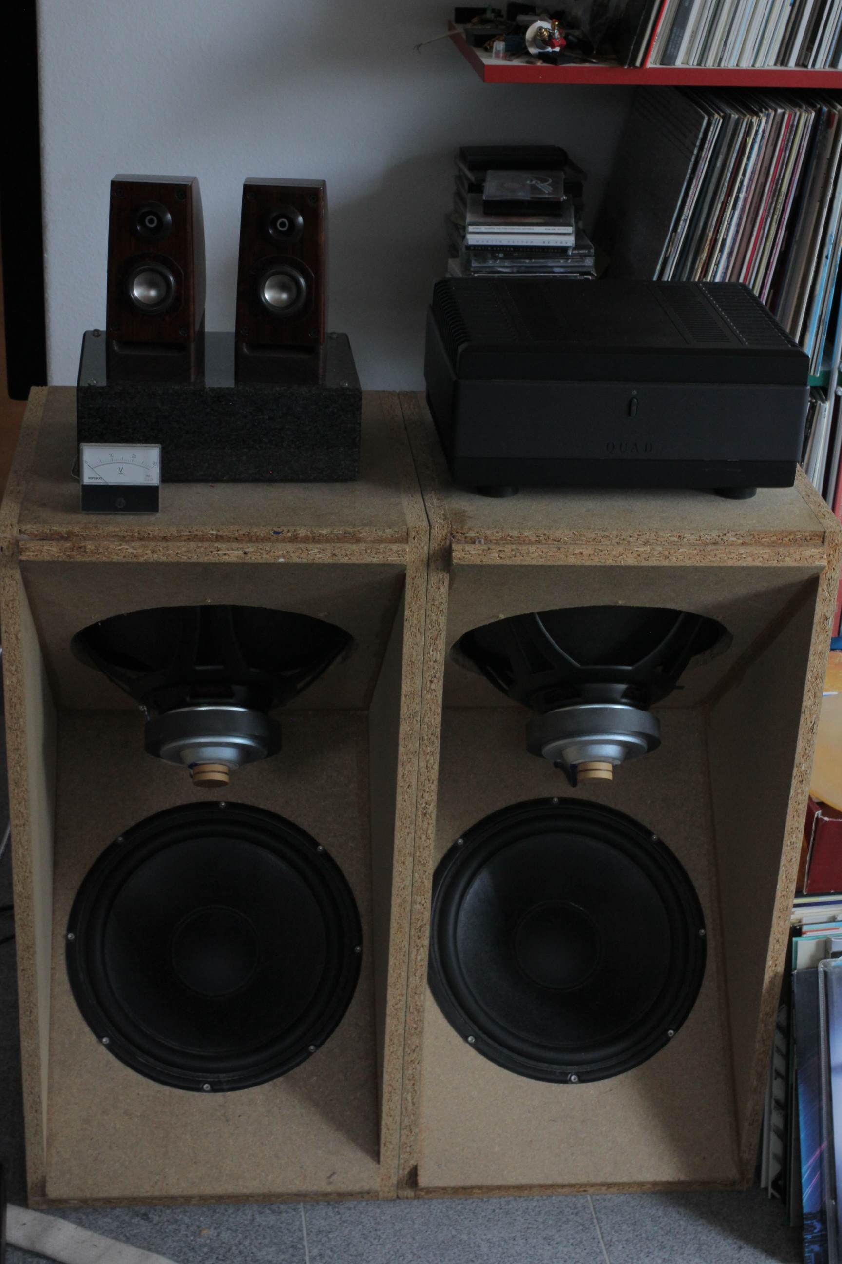

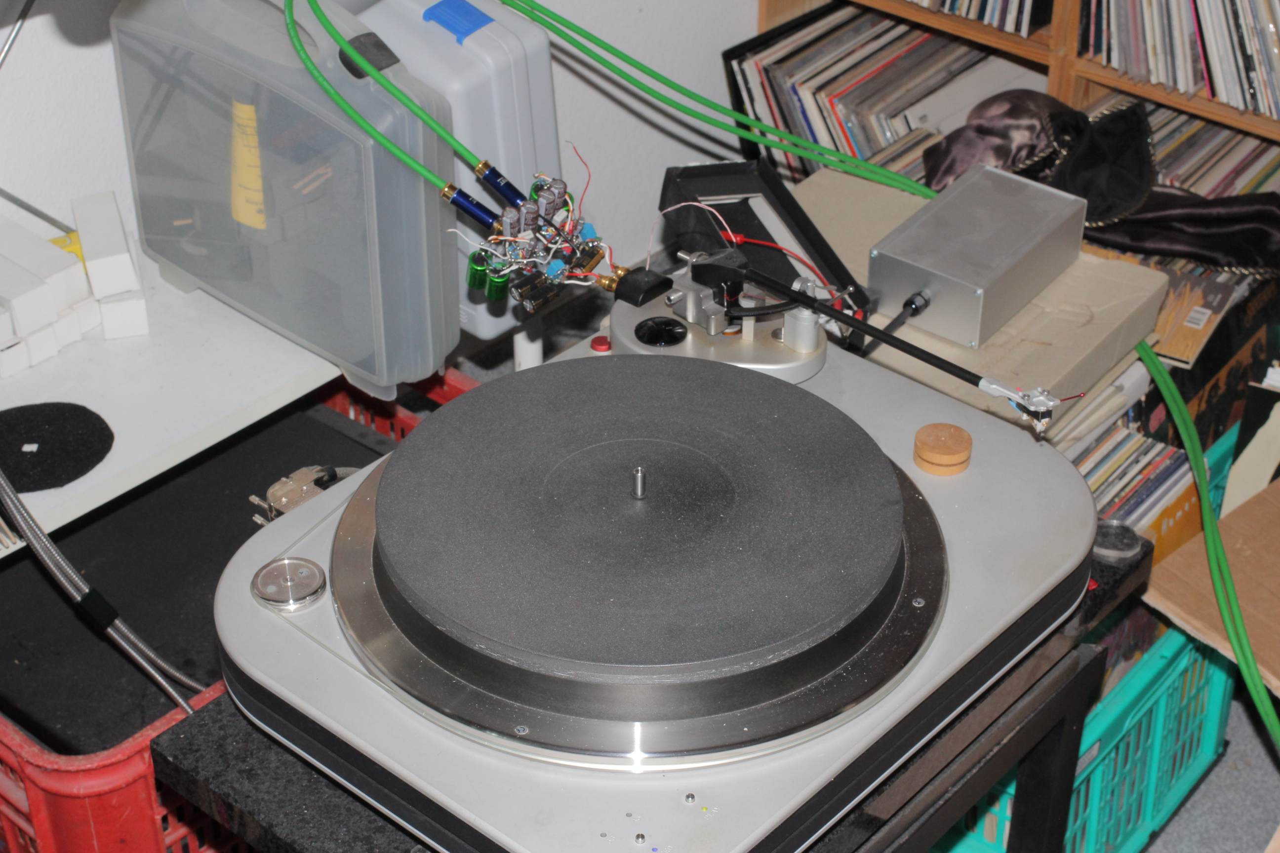

Today i set up my vinyl system and i put on my magnetostatic panels with active M-Dipole sub. At the moment i am listening to a phono stage that has no name. It is meant to be mounted inside a Bauer Audio turntable to safe the phono cable. That stage has a very tight and dynamic sound and that came over with the buffer. I have still to listen to some other recordings but i already get good separation and focus. Maybe the sound is not as "high" as i am used too but perspective is natural. When i am through with this phono i will switch on my tube phono that has a warmer and bigger sound but is also quite detailed. What was very interesting with the noname phono that it is two possibilities to connect the PSU, in this case two center tapped lead acid batteries. In can play floating, that is not connecting the center tap, and also "conventional " with a plus-minus supply.
It sounded much better with plus-minus. Sweeter, less hard, better fleshed out.
The buffer brought out that difference easy. The setup is a bit hard to explain so here first come some pictures.

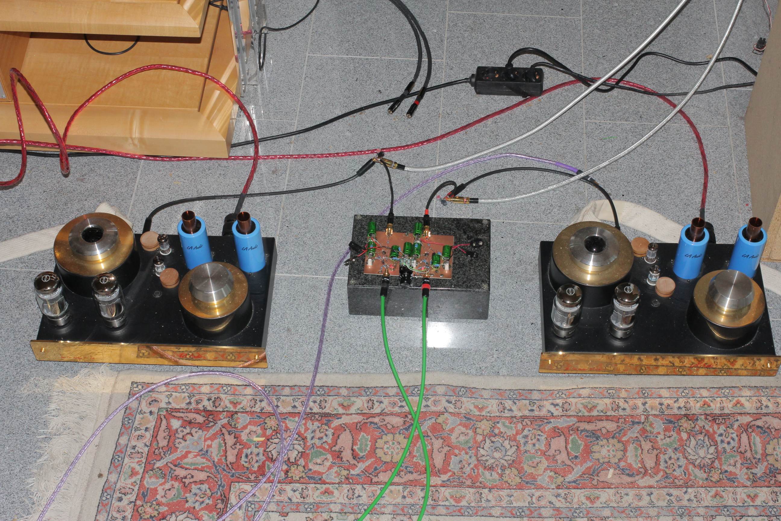

I am listening to music. I found the magic combination.
I changed the opamp based phono stage to a discrete JFet stage.
It is known as " The Hulk " because of the many green Leds.
Some call it " Crystal" because Martina put a big crystal on the Leds at ETF in france some years ago. The very slight hardness is gone and resolution and dynamics are even better.
I have no questions, i am satisfied.
This version of the buffer is a more or less open window to the sounds of this world.

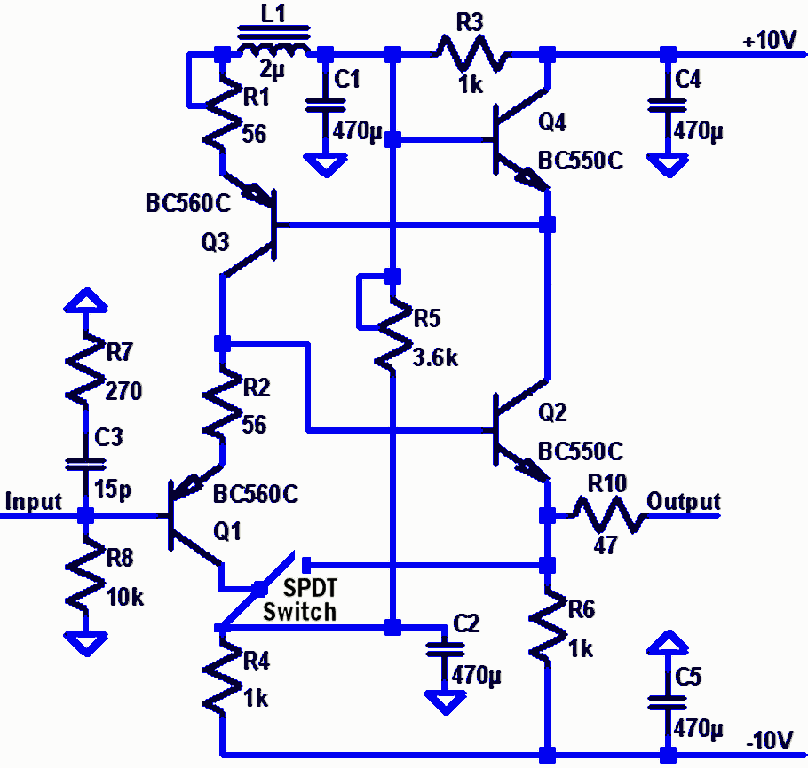

Kean's Kuartlotron Buffer, H2 option switch
On a documentation spree again, here's Kean's Kuartlotron Buffer with the switchable sonic signature option installed. Kind of like tube swapping except much more convenient. And instead of changing a lot of other equipment around or buying a different source for a sonic signature matchup, you may be able to just flip the switch on the buffer. See attachment.
Since the effect is mild and does not decrease resolution, it may be so mild that some people wouldn't notice, especially inert on systems that might not need a buffer.
Switch position shown in the schematic is "effect cancel" for normal operation.
A DPDT switch could be used to switch a stereo pair of buffers.

There is no telling what will happen when you flip that switch. While it is unconnected Q1 will be in deep saturation, input and output will clip to the positive rail. If your source impedance is small, or a headphone amp, it may not be an issue. If you have an input cap, output will clip more slowly. If nothing is connected to the input, it will be a very violent transaction.
I have been thinking about how to make the switch with minimal problems for those interested in the effect. You could use a switch which is momentarily shorted rather than momentarily open, but this will need to be tested in real life and may cause problems as the switch fails.
