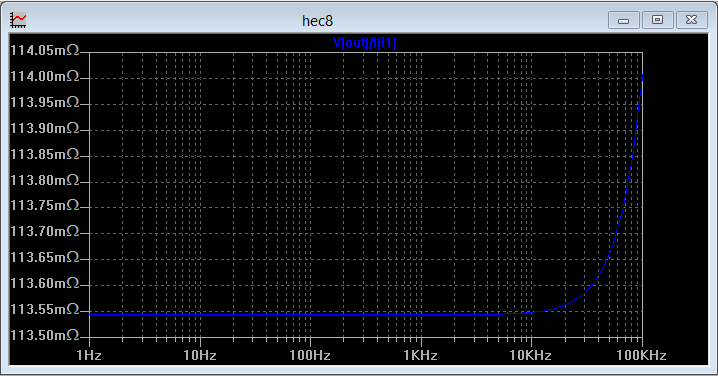

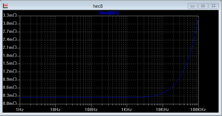

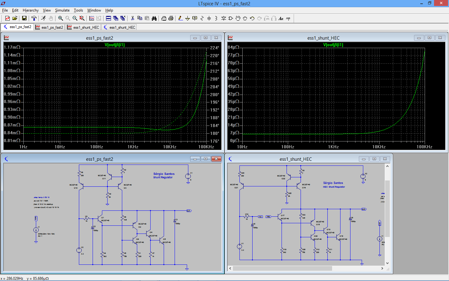

But I will post some graphs than can ilustrate the benefits of hawksford error correction .
the graphs are the simulated measurement of the output impedance of the power stage of the amplifier.
1- NO feedback and No HEC
2- with feedback only
3- with HEC only
4- with feedback and HEC

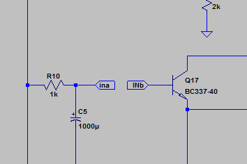

Ok. First attempt to a HEC shunt regulator.
The shunt from the right is equal to the one at left, the only difference is the added connections "INA", "INB" in Q17 base that will connect to the HEC circuit (that I do not show, sorry ). INB is where the error correction current from the HEC will be injected. The HEC circuit is totaly external , so the feedback loop from the original shunt regulator is not affected. My HEC circuit use 8 discrete transistors, no opamps.

Now show us what is in-between the two labels/connectors
Yes I agree, In practice that can be very hard , if not impossible. ofcourse one can use a sense connection, and that helps to maintain the impedance low.

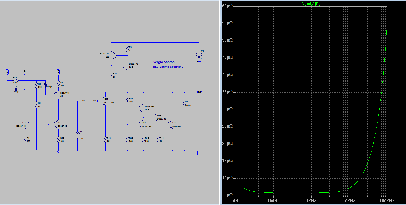

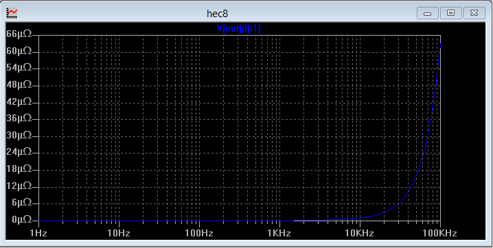

another HEC shunt , based on fig4 of the HEC paper, not the circuit i use in the amp. This time, all the circuit.
This implementation is not very good , but it serves to demonstrate how simple is to implement the HEC.

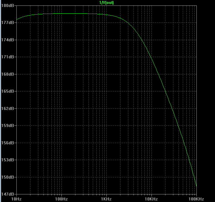

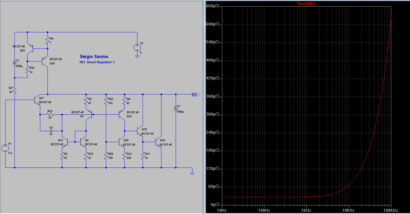

HEC shunt regulator 3
A more practical regulator, the final version will be something like this.
Very good PSRR.
R13 can be tweaked to lower the output impedance , but i like the way it is now.
I think it remains a simple circuit, what you guys think?

Joachim this is for my ES9018, this dac needs very low power supply impedance so the output voltage is 3,3Volts 100mA.

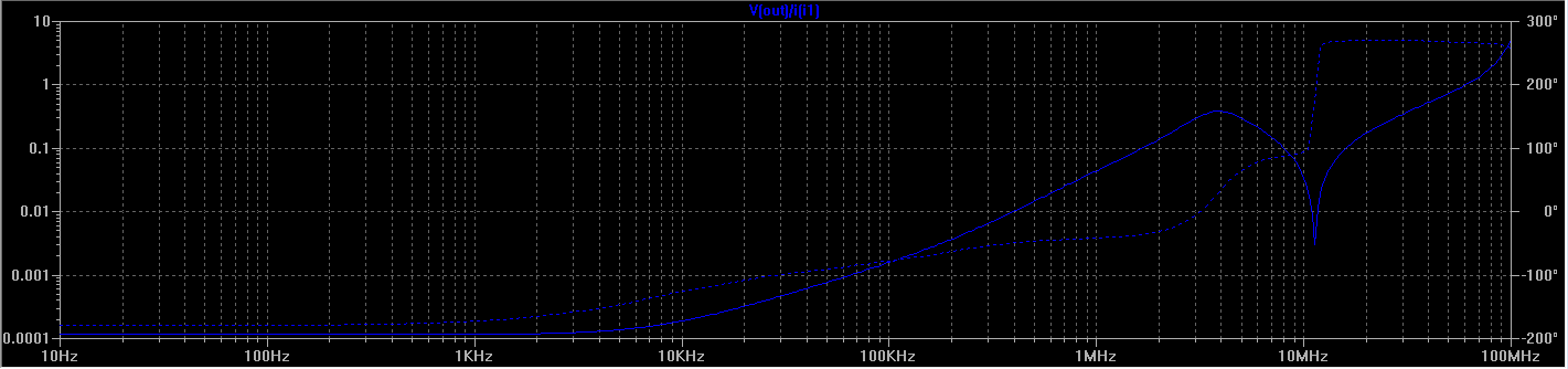

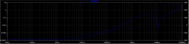

That is along the lines of what I was messing with, but here's the problem. When you lower the output inductance below that that the output device would normally have, you necessarily get a circuit which amplifies RF resonances and is intolerant of series resonances. Why don't you plot output impedance on a decibel scale including phase, to at least 100MHz?

I do not see great similarities, apart from the fact that both are shunt regulators.

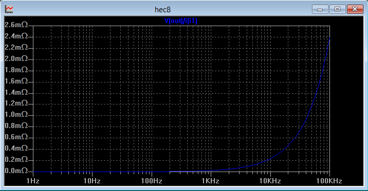

I see Zout at 100KHz has risen to 2mR.
Is the current source oriented properly? It should be pointing into the output of the regulator, not out, otherwise your impedance will be measured negative, or phase shifted 180 degrees.
Are you sure it's not oscillating? Your transient sim command, from what I gather from the schematics you don't banish it from, has the minimum timestep set at 1mS. This is like setting a sampling scope to a 1KHz samplerate. Try setting it to 10nS or so and the current source to 1MHz at 10mA and see if you get oscillation. Also add this:
