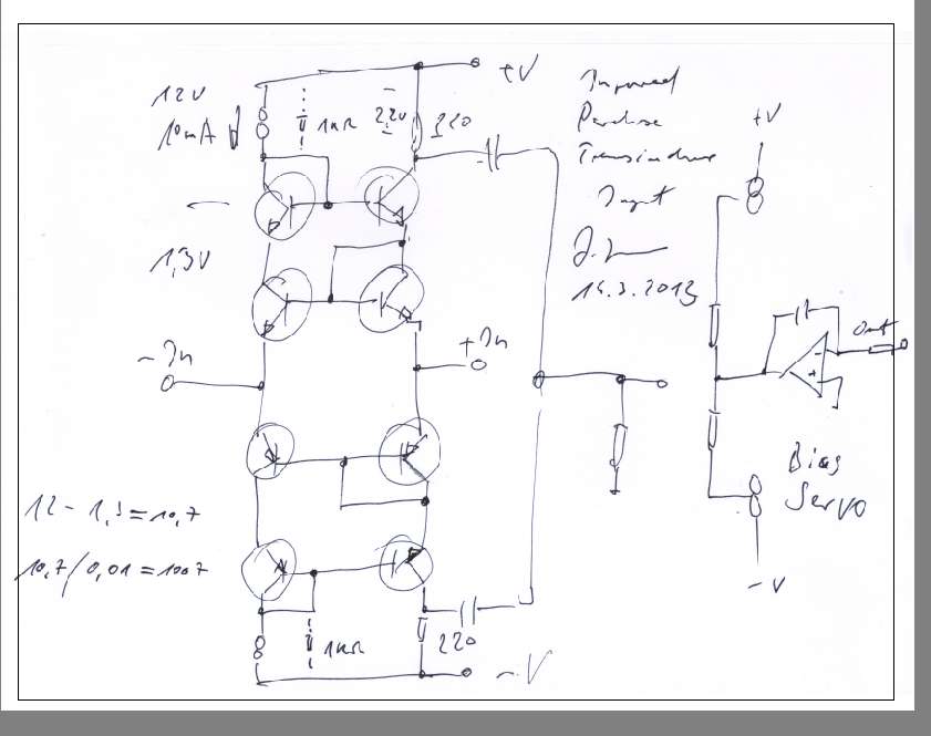

This is the balanced, transimpedance version. That also solves the input offset problem.
Now all falls in place.....
Would you post Foolish Diyer version of SCH so even I can have a go and try please
I am working on a balanced update for the Paradise.
I am planning to put together a kit with everything necessary, including noise screened and selected transistors. I really would like to avoid the trouble we had with Hfe matching and wrong components and delay in the group buy.
The implementation is pretty easy.
The biggest problem is how to setup the servo. We can not use the same method then in the R3 paradise because the biasing is so different.
Here is a more elaborate circuit ( scroll down the page ) that is in principle based on the same idea then mine.
You can also see a lot of similarities to the Paradise.
The input is level shifted and combined by mirrors.

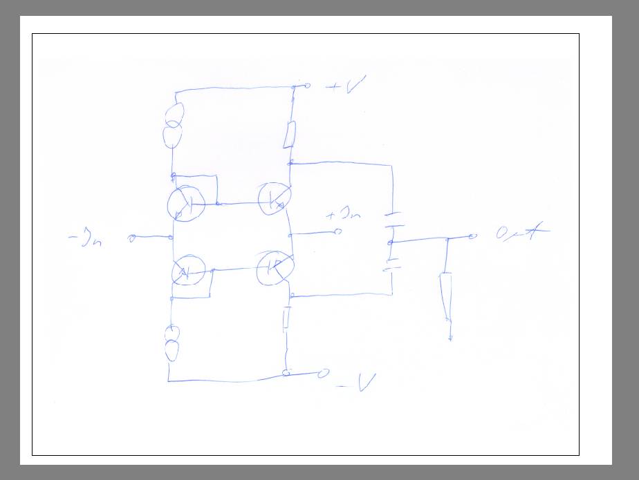

I can not help, i will post an even better circuit where everything is cascoded.
There is still an unnecessary high impedance point between the top transdiodes and the output transistors. That is the beauty ones you understand topology.
That topology can even be improved by earth referenced or floating current sources
Without the current sources the helpers can only drive 1V, no matter how i set the idle.
