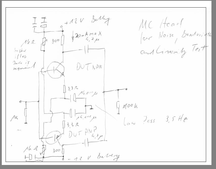

I now got the Peak Atlas DCA75 Pro curve tracer. It is really cool and will allow me to measure the early voltage in BJT transistors. I also started to build a measurement setup for Rbb`. This two measurements will allow me to identify BJT transistors that can be used in low noise, high speed MC input stages. The reason for this is that the super low voltage noise Japanese BJTs from the 70th and 80th are no more. After ROHM and Toshiba, Hitachi Renesas has also given up to produce them. We can of cause parallel several medium noise ones like our BC337 and BC327 but some think that only one pair sounds better. With the curve traces i can also find out if NPN and PNP are truly complimentary. I have designed a simple MC head where i can try the candidates in praxis.

A problem in medium and high power BJTs can be low Hfe. When a common base stage is used that is not much of a problem because a common base stage has zero current gain. In common emitter though high Hfe plays a role to give the circuit a high enough input impedance and minimize base current or we get DC offset into the cartridge.
Hfe linearity will then also be important to make the circuit low distortion. High early voltage is good too to make the circuit fast and low distortion in the treble. Also Cob makes a contribution so output capacitance should be low. That may be the reason that i heard from seasoned designers that often transistors in a small case sound better then their bigger brothers. Anyway, i have drawn a simple parallel symmetric MC head circuit without any current source or cascode that will bring out any flaws in the chosen transistors. I will use the same circuit and only exchange the transistors. i will then measure bandwidth, distortion and noise.
Here is the test circuit. No cascodes, no mirrors, no constant current sources.
The gain is quite high and the idle can be adjusted. This circuit without safety belt will bring out the best and the worsed of the DUTs.

First tests have shown interesting results. Our classic BC550C, BC560C pair shows very good linearity of Hfe and a high early voltage up to 2.5mA. More then that the PNP and NPN go astray and the transistors get slower and dissimilar. I would say a decent MC head can be made of 4 pairs running on a total idle of 10mA.
The now for secret Sanyo medium power video transistors show very high early voltage up to high currents. I can not measure more then 12mA though. Unfortunately they do not match well in Hfe but that can be selected. Lets see how they fare on the noise and bandwidth test.
The super low voltage noise Hitachi-Renesas do great up to 10mA but there i also experienced a Hfe mismatch. Again that can be selected.

Yes, Salas, the new Altas gives curves of idle current over CE voltage over base current.
Maximum idle is 12mA and maximum voltage is 12V.
The straighter the curves, the higher the early voltage and the better is the BJT as a current source so it is also a measure of output impedance.
