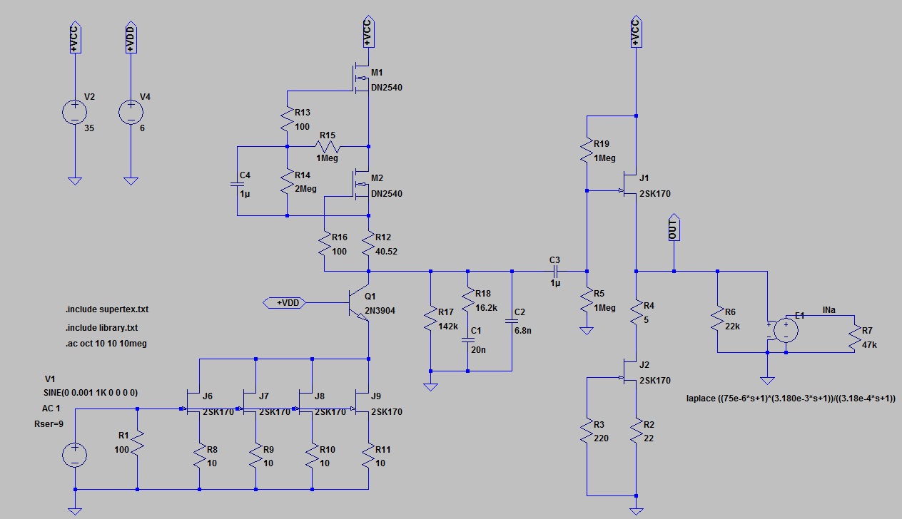

Ok, here is what my simulator spitted out. Gain is 57dB and good riaa compliance with increased shunting resistor from 130k to 142k. Typical nice SE harmonic distribution for 1Vrms out with H2 dominant. There was missing bias resistor for buffer, added that.

I tried to simulate that with LTSpice but it doesn't seem to work.
In attachment the circut I am simulating.
Do you see anything wrong with it?
Model for the Mos are taken from the manufacturer's website.

I think R19 is not necessary.
You should get less gain with this circuit because the 2SK170 are less steep then the BF862
( less Gm ).
I am building the input gain cell at the moment in it´s most basic form, so lets see if it works.
Stafano, you should also raise R12 in value or the voltage over the CSS can break down.
It is better to make the CSS a little bit weaker in current supply compared to the input stage
then the other way around.

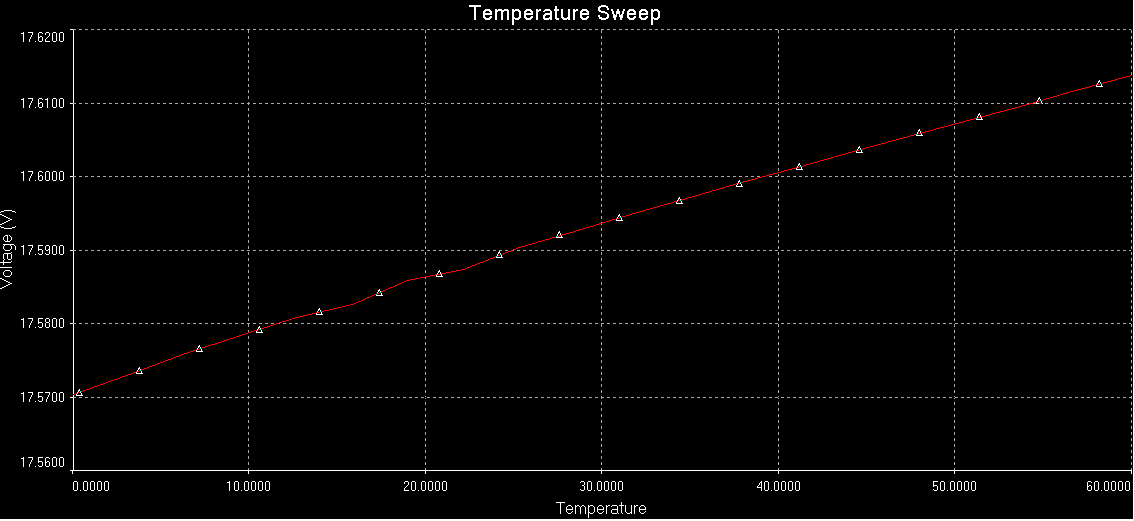

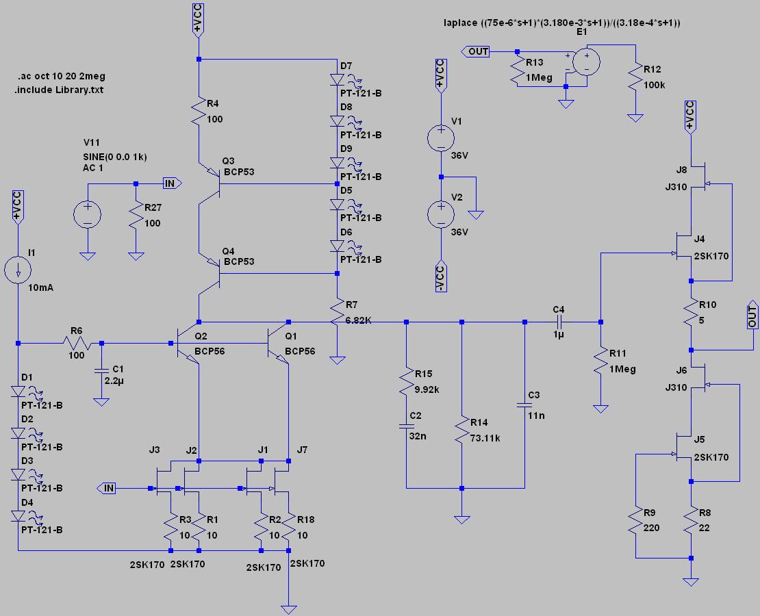

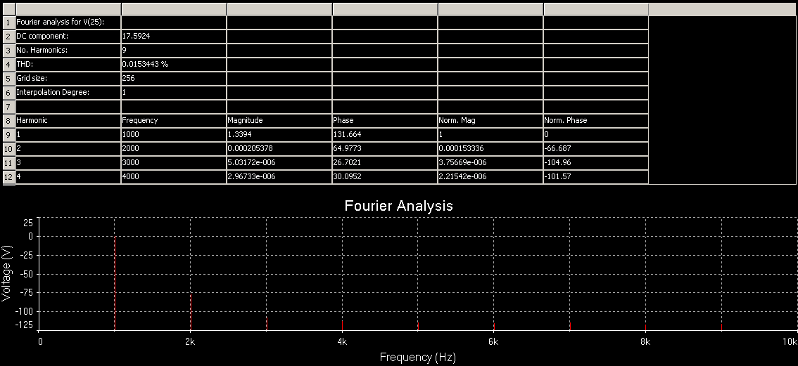

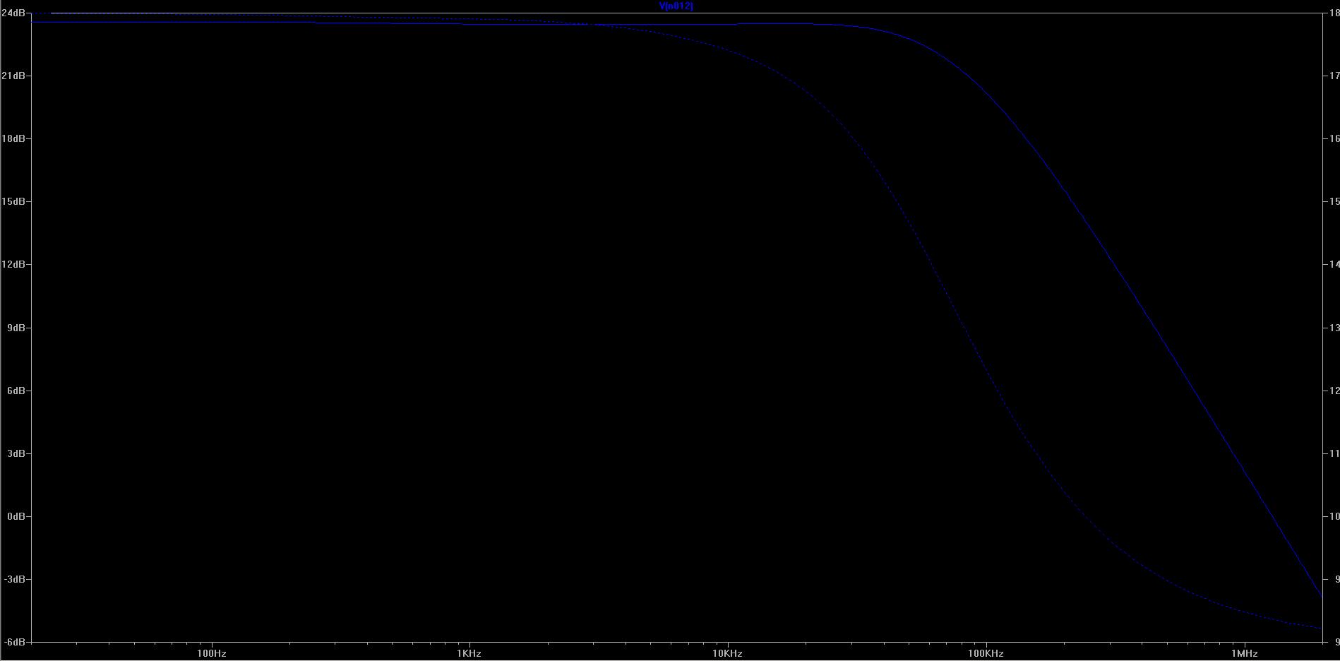

Good, let's see what a real world throws out. Meanwhile I have done some homework, that may apply hear if DN2540 ccs misbehaves. One solution would be mosfet gyrator, that would do some self biasing. Zetex makes nice HV mosfets with very low Coss, so we get a good improvements in BW and THD, as parasitic capacitances are main source of non linearities here. Spice tends to agree with me (see attached). Don't know about noise though, it's always uncertain with mosfets. It could be a surprise in both ways. I think this could be made all smd with mosfets and bjt in sot223 and jfets in sot23. I'm starting to like it :)
What JG said, try to step. R12 and plot Q1 collector voltage for ~18V op point.

Well, the depletion Mosfets are not the solution anyway. I may try my original BJT design.
When the thermal drift and the noise from the CCS is in check this may work.

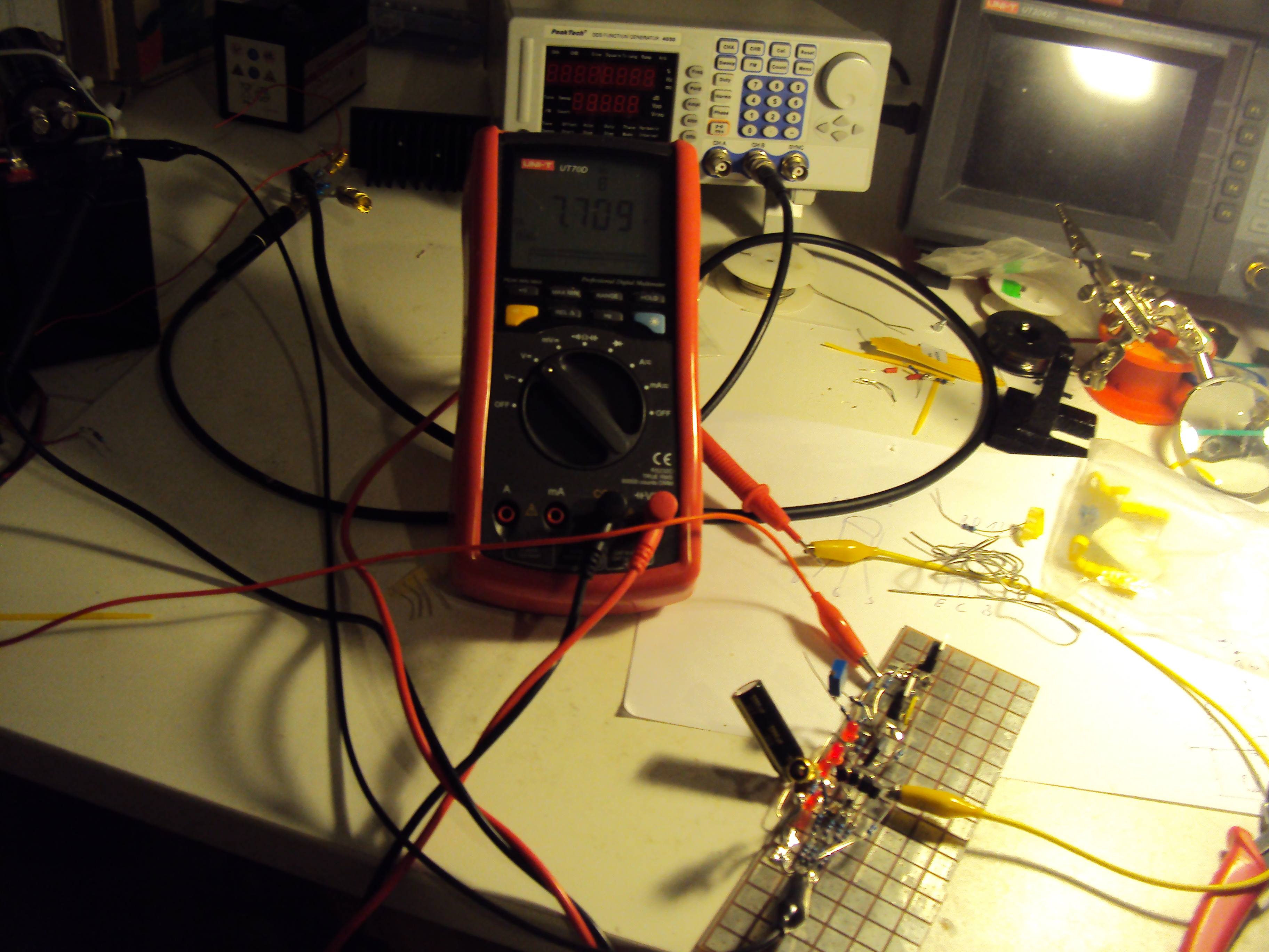

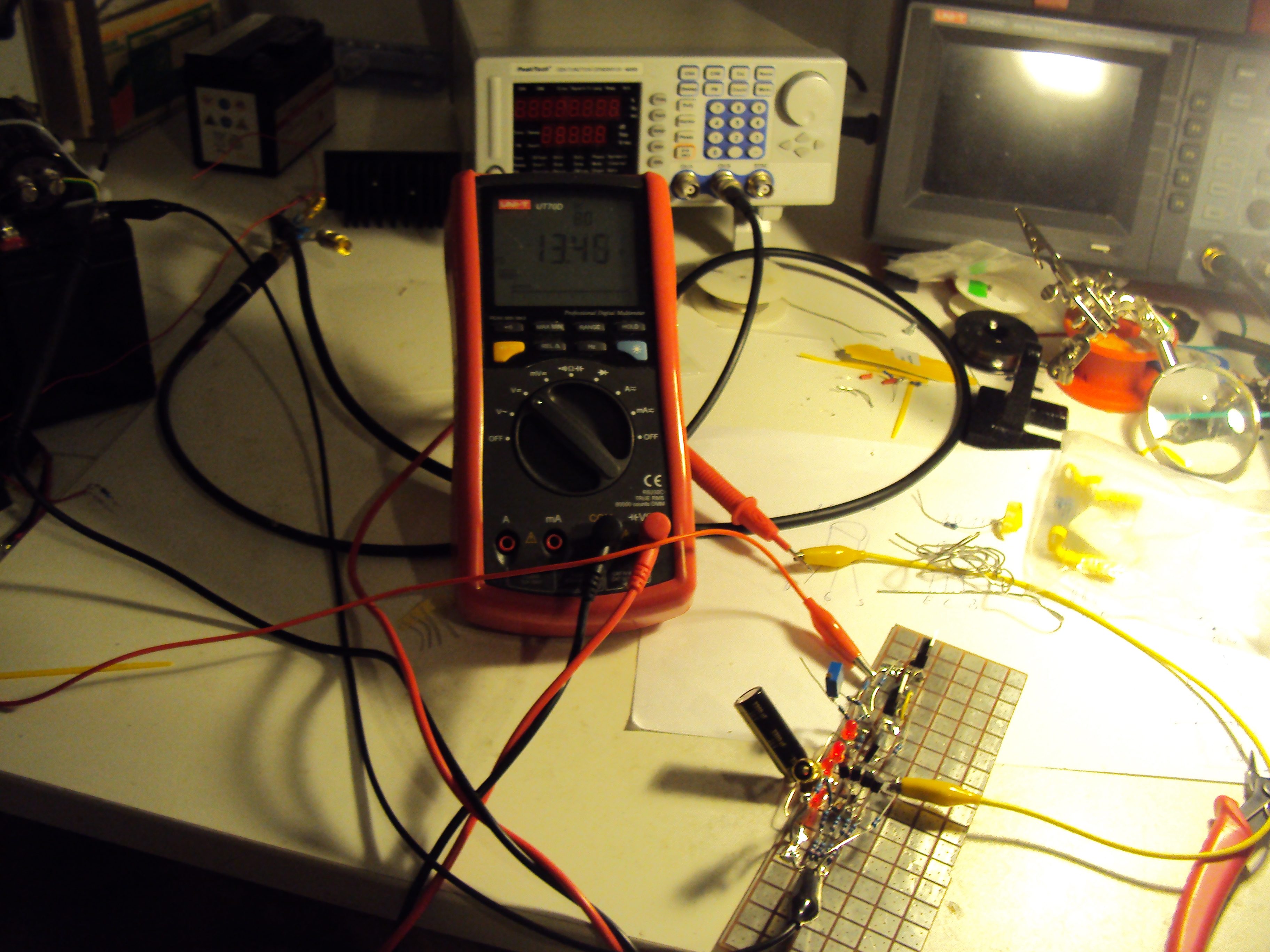

I just checked out the thread: have you built the circuit simulated by sampler?
Have you measured the gain it it actually boosts out about 60dB?

Post 7760 is the original design.
Concerns are low noise from the CCS and little thermal DC drift of the input stage.
I already know that a one stage RIAA is theoretical possible.
My tube RIAA comes close but has some gain in the output stage and that with only 8mA in the input. Here we have 50mA on tab so enormous gain in one stage is the attractive idea. So far i have only build a prototype of the input stage but my tube RIAA supports the theory.
