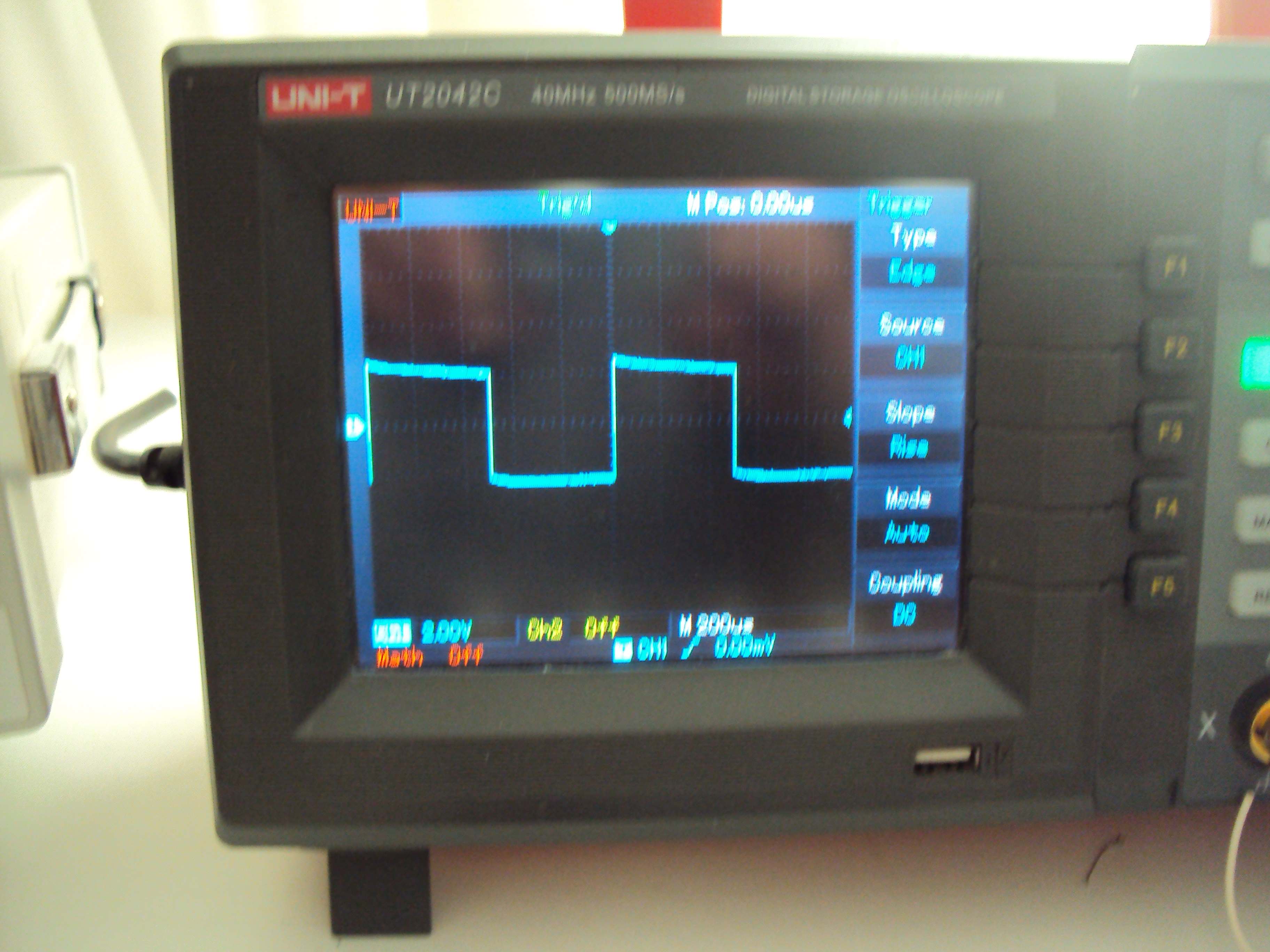

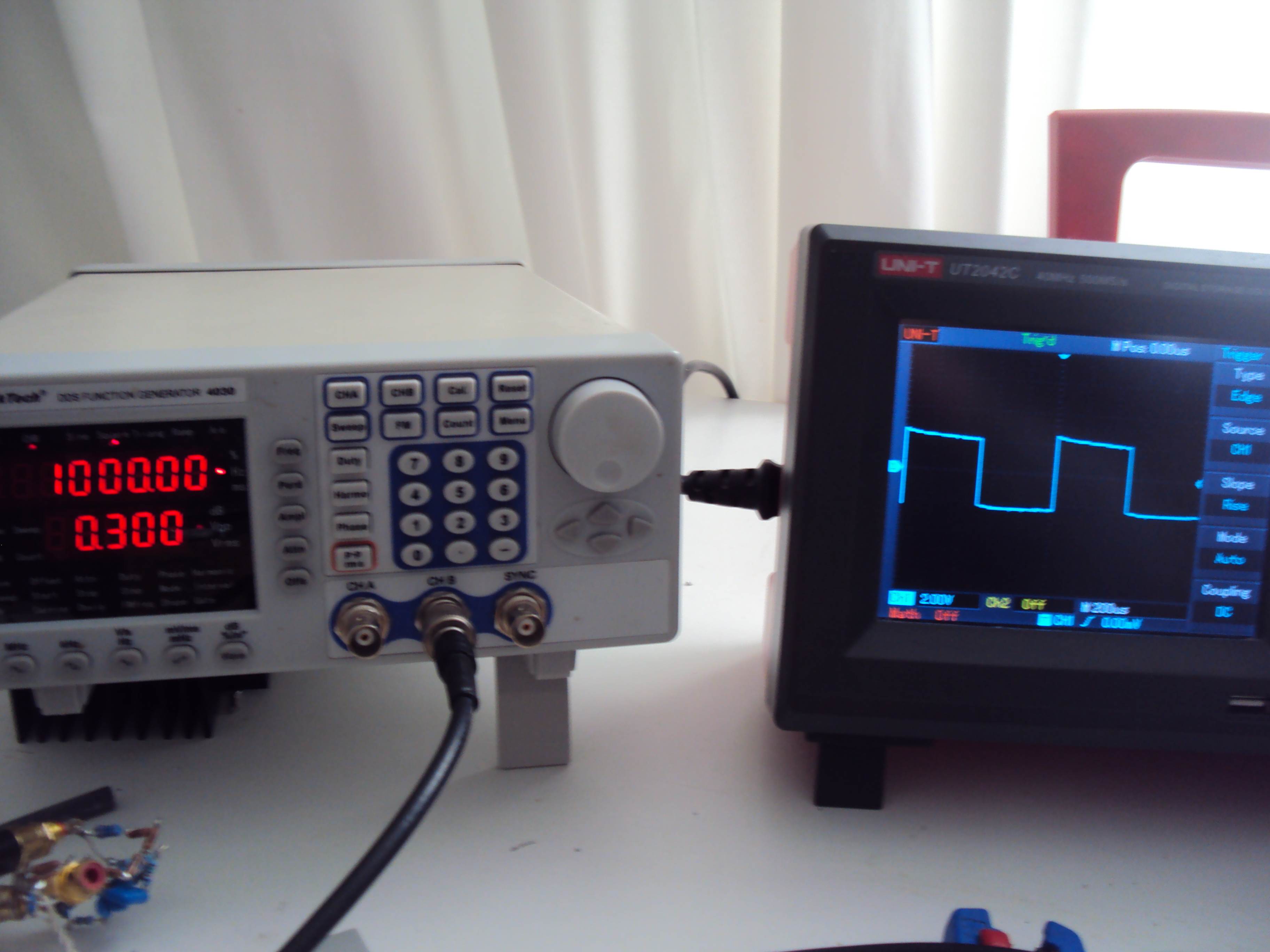

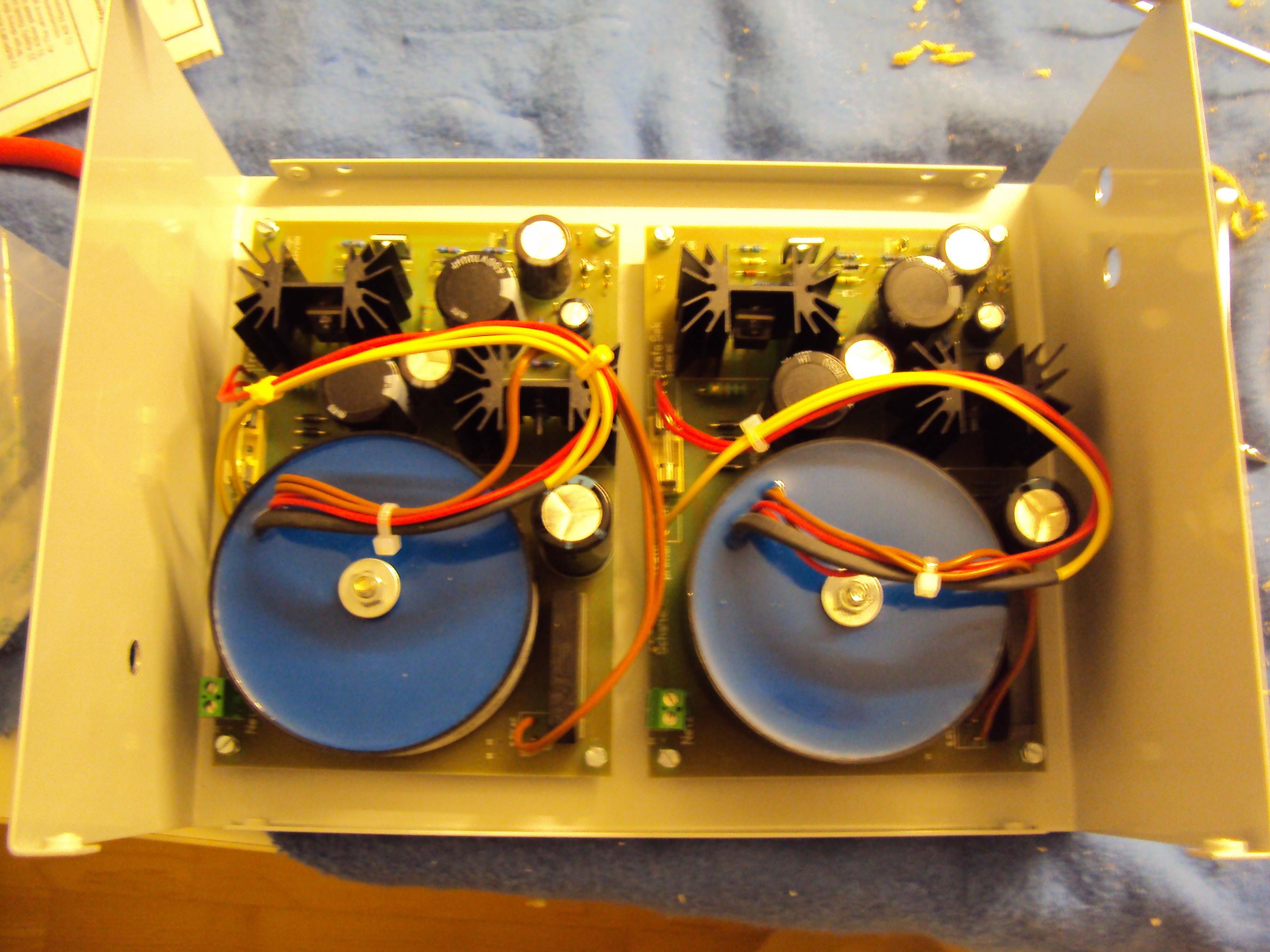

The second channel of the tube phono for ETF is working !
I only have to do some mechanical work ( put the PSU in a box ) and then i can test it in my system.
The square with Anti RIAA look decent. I have a slight subsonic filter under 30Hz so the top is not totally flat.

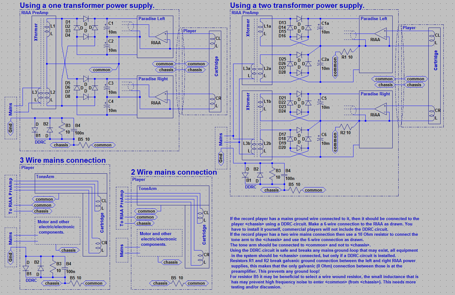

Grounding
A few weeks ago Rcruz asked some questions about having one transformer for both power supplies of the Paradise, his main concern was ground loops and ground induce noise. For this reason I tried to create a grounding scheme that both is simple and ‘fool’-proof.
Attached is the schema that I came up with (after numerous discussions with RCruz), there is one ‘new’ idea in the schema and that is to introduce one ‘extra’ wire in the connection between the record player and the preamplifier. Conventionally a record player is connected to the preamplifier by 5 wires +L, -L, +R, -R and ground, this scheme uses 6 wires (more must be better :)).
As I see it, the problem is the ground wire (in the 5 wire ‘standard’ scheme), there are 3 possibilities, the ground wire is connected to the tone arm, it is connected to the chassis or it is connected to both. In my opinion all three solutions are bad. The first leaves the chassis floating, the second leaves the tone arm floating and the third connects the chassis to the tone arm (and that includes all HF and ground induced noise that is picked up by the environment, mains cable, mains ground etc.).
The best solution seems to be to connect the chassis of both devices, the player and the preamp, to each other, but this will create ground loops via the mains ground and audio signal cabling (so it needs to be un-looped). Also the tone-arm should be connected to the ‘clean’ ground of the preamp. The schema, as attached, removes every possible ground (clean or mains) loop and at the same time removes all touch induced noises.
The schema for single transformer has been build and tested by RCruz and works as expected (total silence :) no hum’s). The schema for two transformers (is preferable) is even better, it makes sure that the only place where both channels are connected (zero ohm) is in the line amplifier.
Let me know what you think of it, do not hesitate to ask questions, and please report your experience if you did implement the schema.

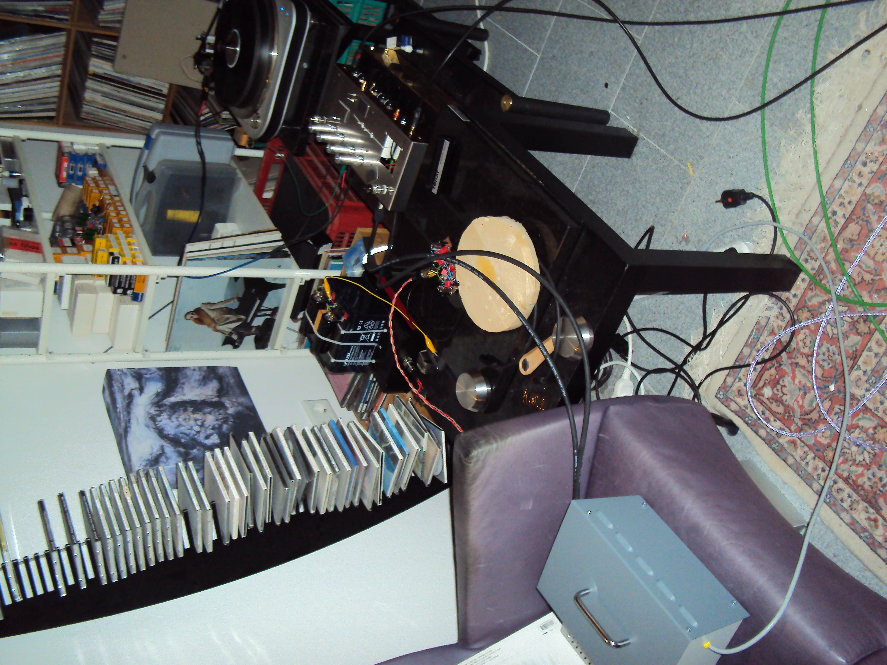

A miracle happened, it works ! With a Siemens E188CC gold pin in the output i ran into wild oscillation, with a JJ E88CC it works just fine, strange.
Noise is not as low as my solid state designs but listening with MC ( Lyra Titan i ) is possible. Gain is ample. One channel is lower in noise then the other etc.
More to come.
