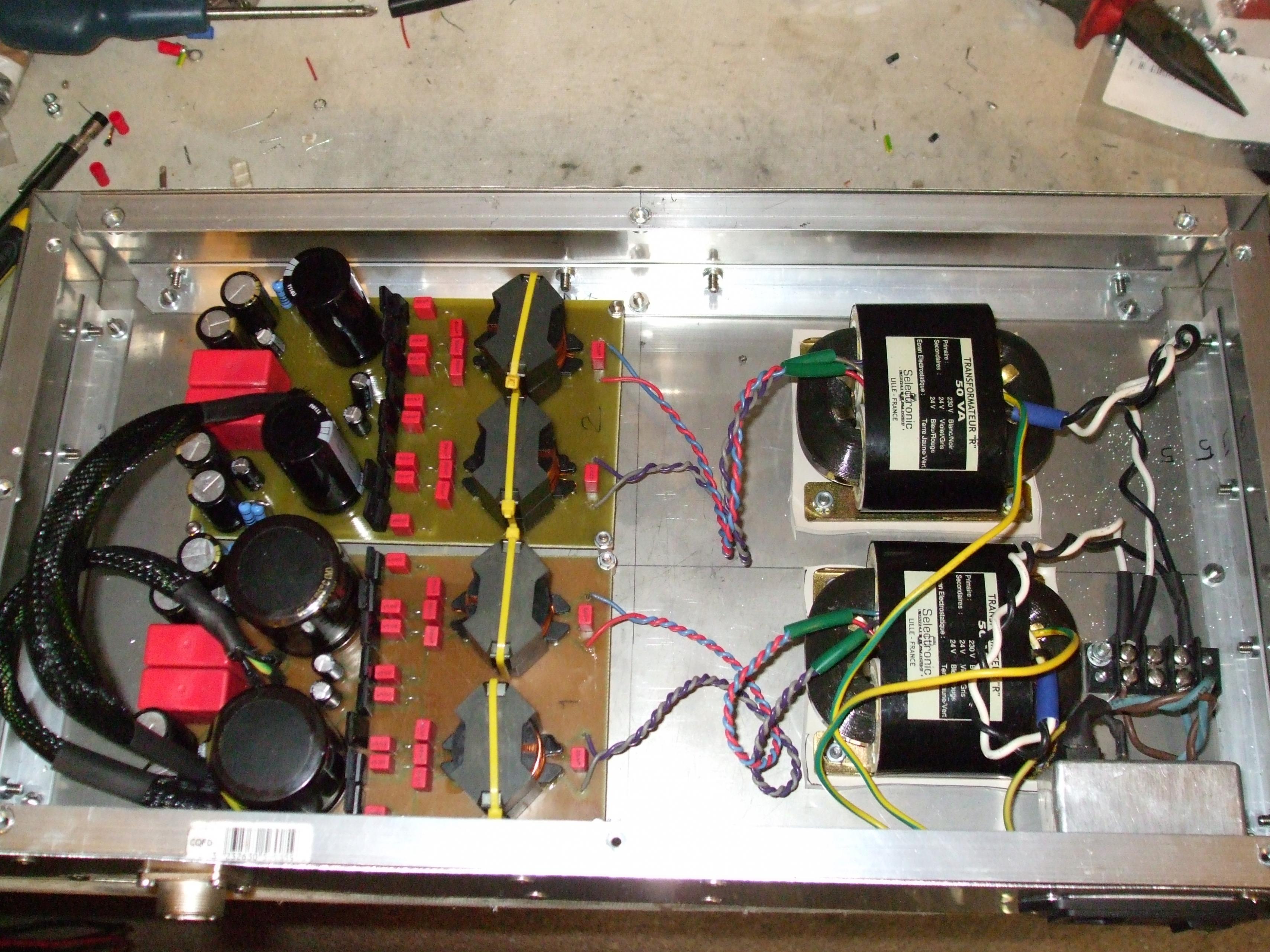

Look more carefully at the attached schematic, and the way caps and chokes are used. Only part of the schematic before LM 317/337 is important for raw power supply. Common mode chokes have parasitic differential mode inductance and are decent 120hz ripple filters, of course less effective than Hammond inductors. But they are much better at HF common mode noise.
I tried it as a raw power supply with my high quality phono stage with integral voltage regulators , and subjective impressions are very good,
If i ever build Paradise I will use it with Borbely voltage regulators. No-feedback regulators are a part of audio myths.
You are free to do, as you like of course
But have a look at post 7343 that is the last post in which the pre-regulator SCH was posted there was earlier in the tread a fair bit of discussion about the development of this circuit.
About the LM317 my personal experience is that they do strange things especially with large capacitors at the output or further regulation furthermore they are not needed as the existing on board PSU do pretty well.
Again I wuld look at FDW contributions earlier in this tread.

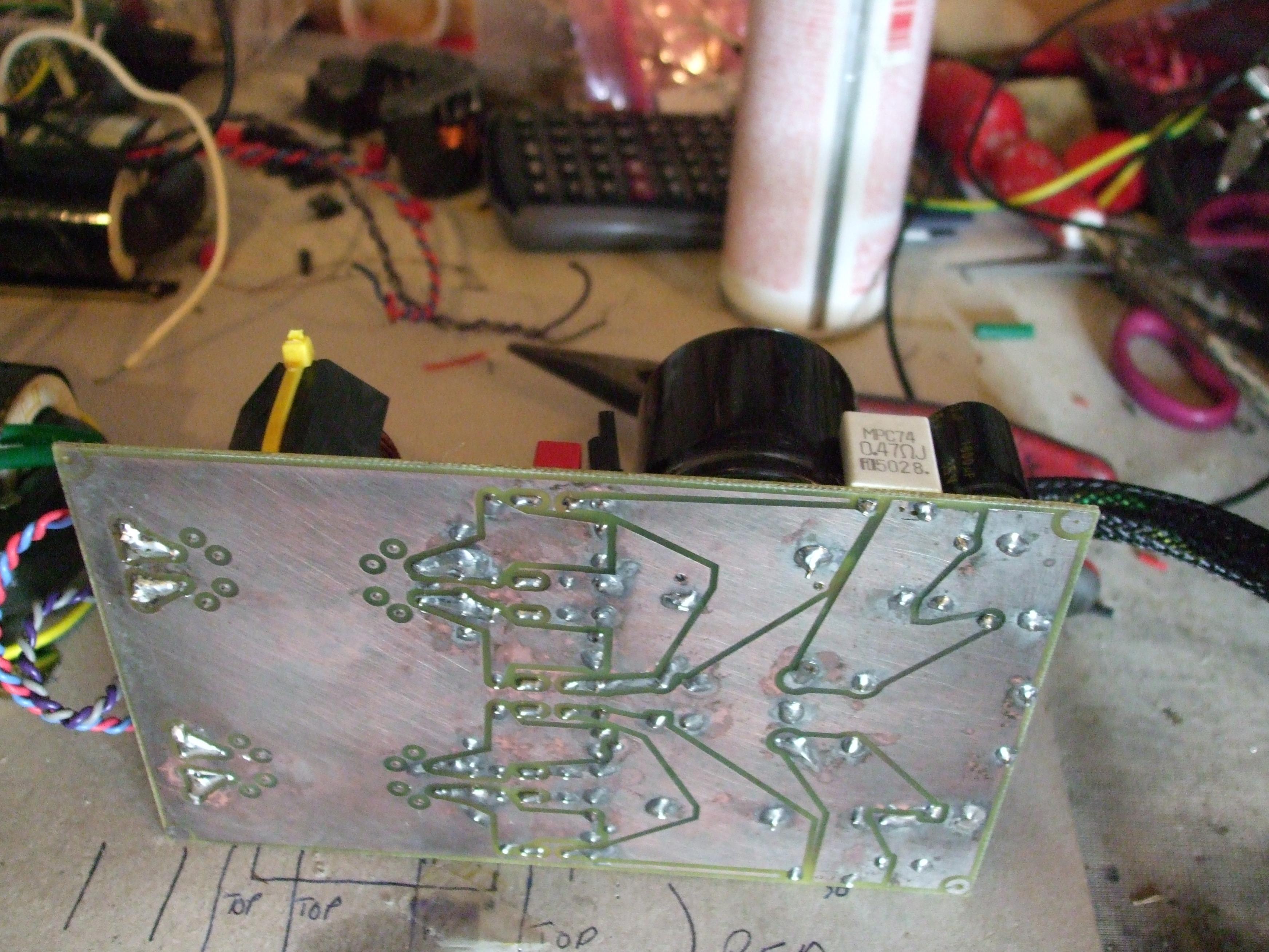

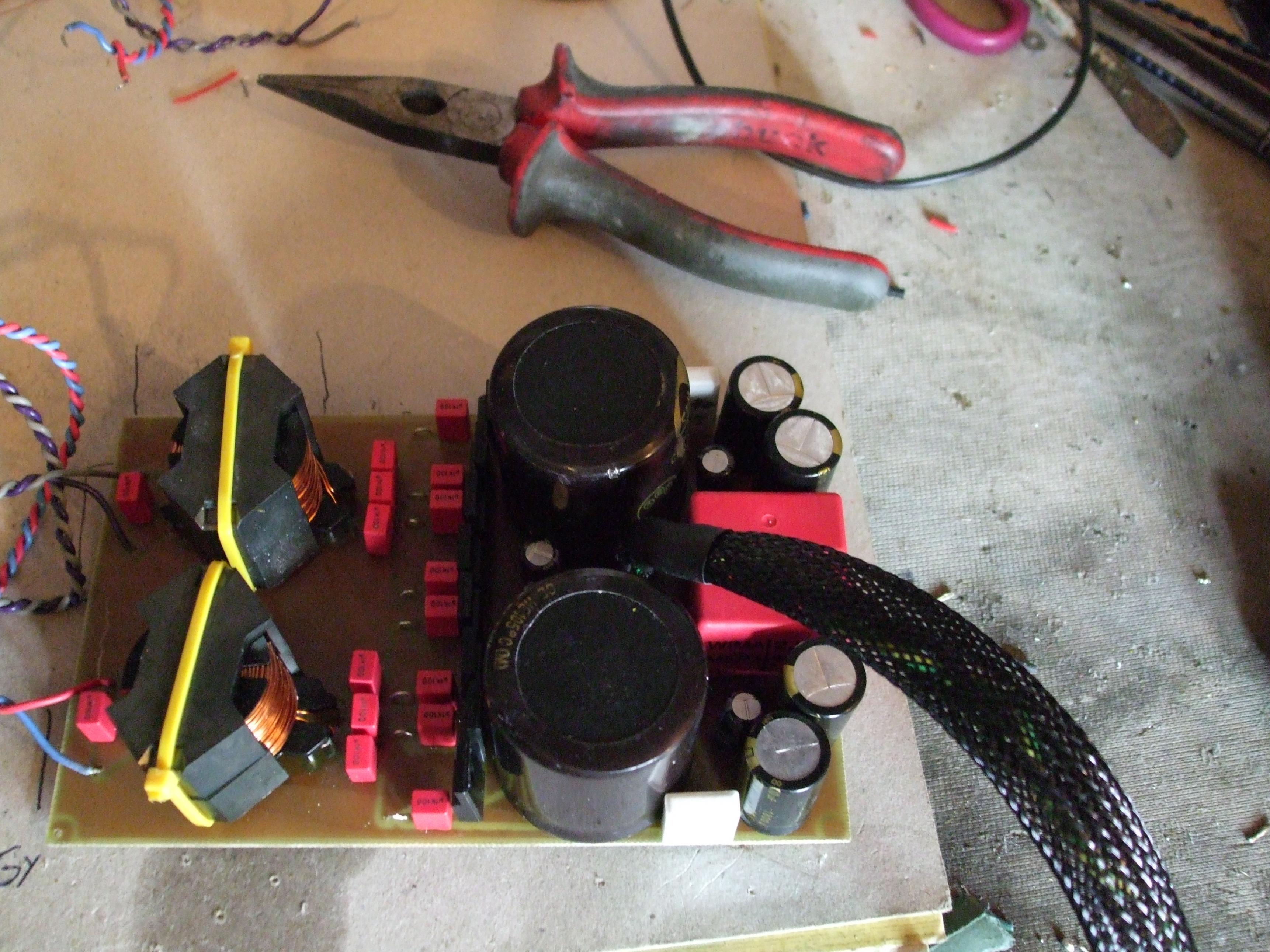

The pictures are of what I am listening to at the moment
Home brewed common mode cokes and PCB with very short and fat tracks
On the third picture the Futaba resistor (Now replaced by 5 Homs Holco 15 PPM) is strategically placed to allow for cokes to be out board.

Do not try to feed the CVS of the CCS of the shunt :) with a regulated power supply, there is a good possibility that one of them (or even both) will oscillate.
Of course the team highly recommends a passive filter using a common mode choke as discussed before, and a board was designed by Bksabath see http://www.diyaudio.com/forums/analogue-source/154210-mpp-438.html#post2861497 and later.
See also http://www.diyaudio.com/forums/analogue-source/154210-mpp-445.html#post2864700
And http://www.diyaudio.com/forums/analogue-source/154210-mpp-468.html#post2872390
Maybe this make things easier to understand
