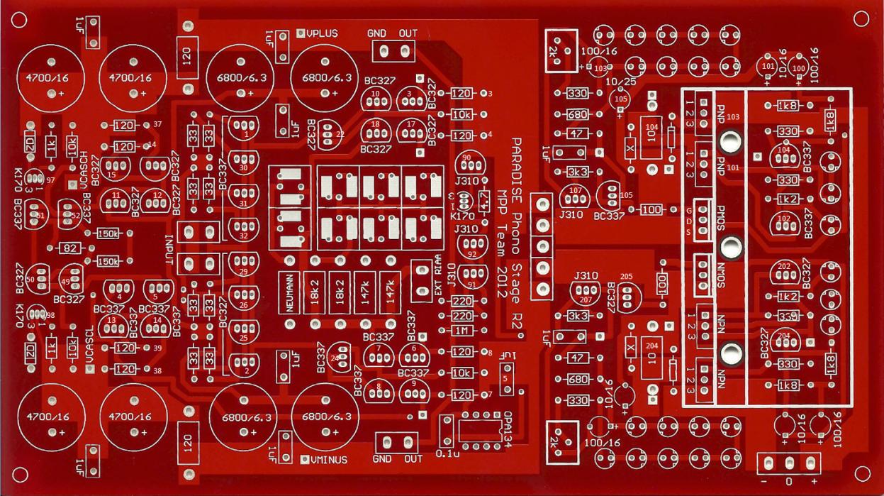

The CCS basically provides a constant current that flows into the load. The CVS (constant voltage sink) portion of the regulator makes sure the voltage at the load is constant, and it does so by absorbing more or less current. When there is no load, the CVS will absorb the entire CCS current. The higher the load current, the lower the power dissipation in the CVS.
So much for the basics, how to increase the CCS current: spot the resistor marked "X" next to the 10 Ohm resistors. If you put a resistor here (which really is in parallel to the 10 Ohm resistor that sets the current in the first place), the CCS current will increase. Frans has given the equations in a earlier post, but its quite simple, if you put another 10 Ohm resistor here the current will double (watch out for the power dissipation in that resistor though, there is a reason we used a big resistor there).
On the CCS current vs load current: If the CCS current is too low to keep the CVS "alive" all the time, you'll see some nasty stuff happening. Best to run the CVS in a sweet spot where the load variation it will see is small compared to the (DC) current it is running already - just like class A amplifiers..... So more is better. Most comments at least I have heard are that you should target roughly double the load current for the CCS, which I believe is the case here with the Paradise R3.
CVS power dissipation is 18V * CCS current * 2
(Thats what the heatsink can accomodate easily, a couple watts more should not be a problem. Remember to have ventilation in your case - if completely closed, it actually may overheat!!!)
Power resistor dissipation is (CCS current) ^2 * resistor value
(this will give you the dissipation in both resistors together, the current will split according to the resistor values)

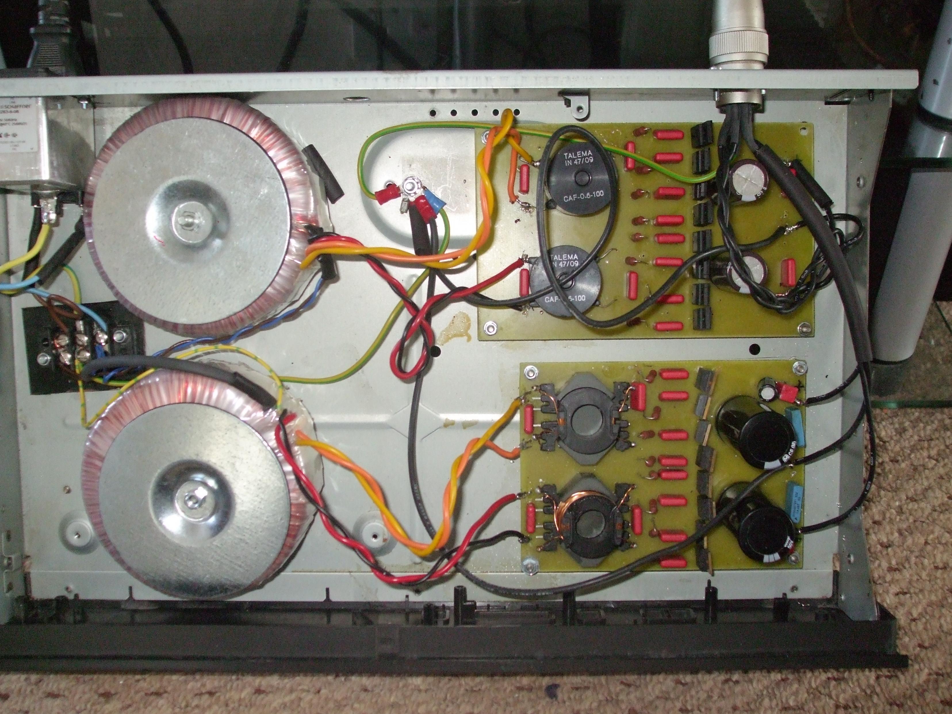

I tried to supply Paradise with Zen Mod shunty and as FDW said no point doing so besides the on board supply WORKS
I am using a single pre rectifier board to supply the 2 Channels and this was causing same hiss to be audible after adding a further common mode coke on the output of the pre regulator hiss disappear and al is well.
So for V3 New box and I am going to use separate transformers and pre regulator boards, as those are home brewed I will make provision for the second common mode cokes.
I am not sure if those are needed with 2 separate supplies.

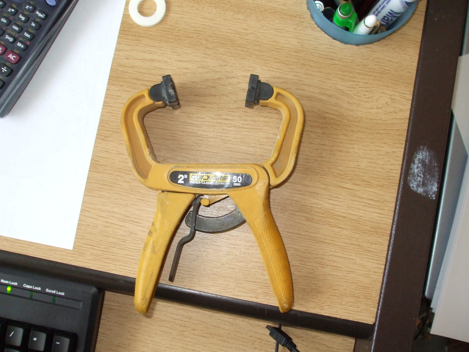

If you are just starting to follow this tread this is virtually the first time that I play with BJT and apart from one capacitor placed the wrong way they worked straight away as I said before the hardest part was clamping the transistors to the sinks but with the clamp this became child play easy peasy.

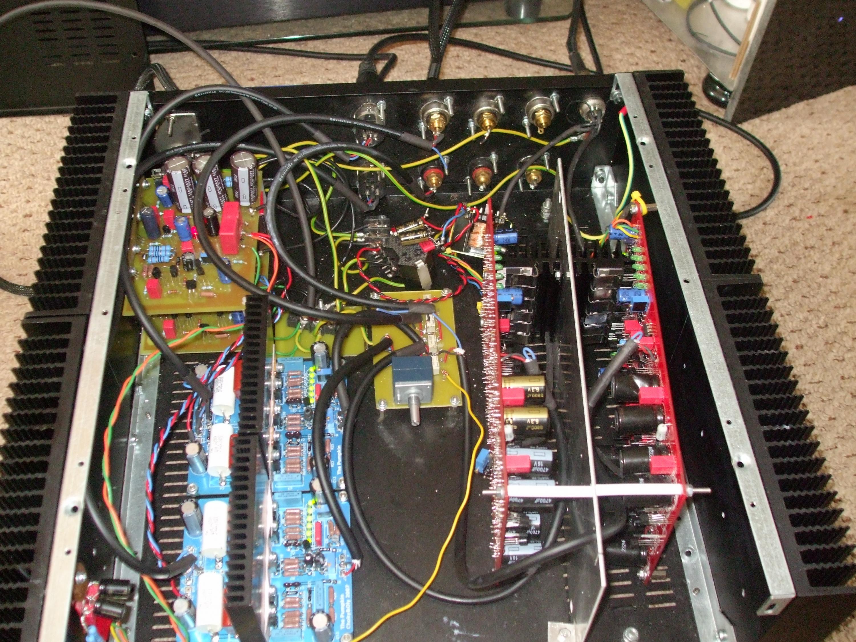

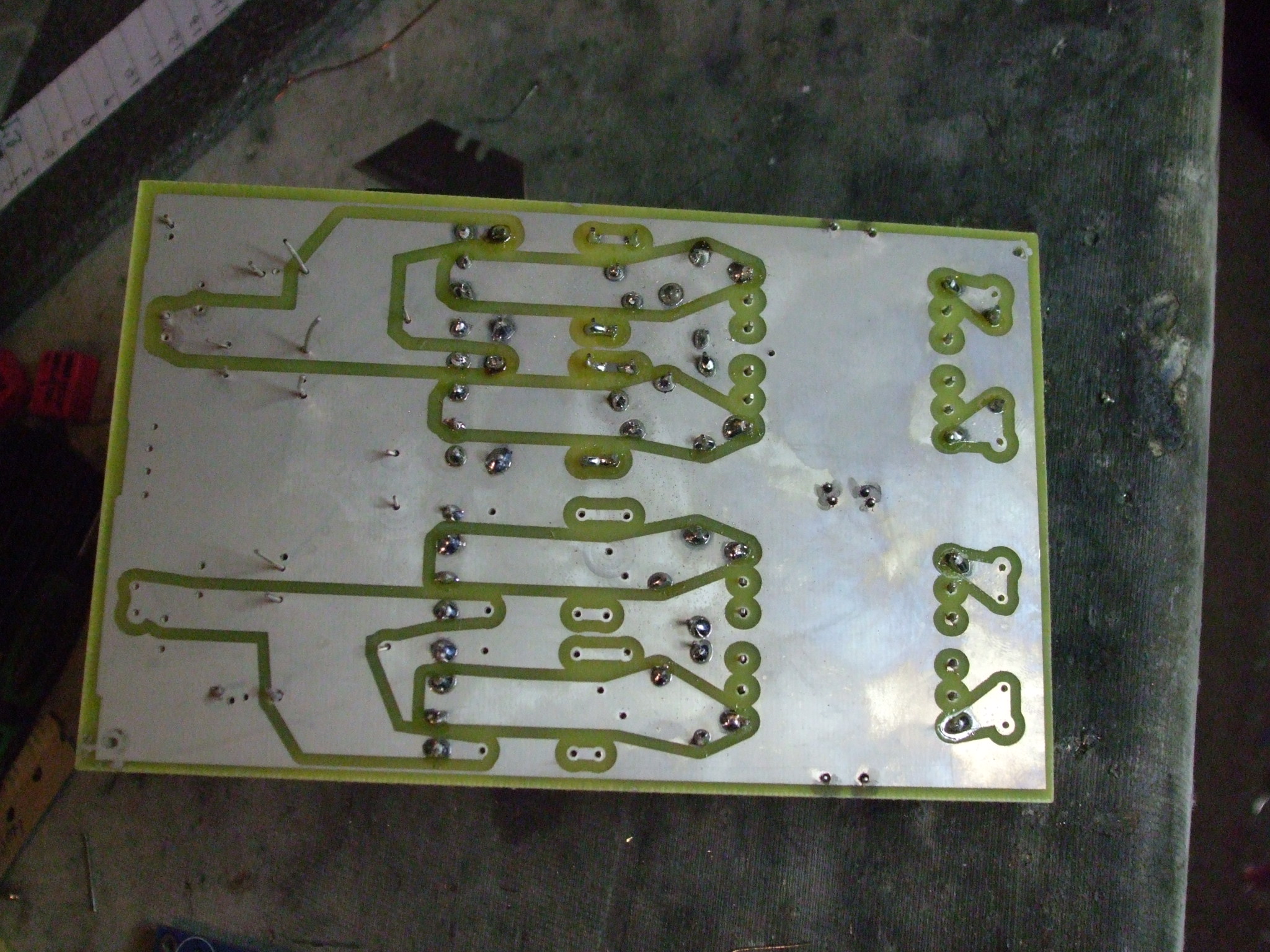

On the pictures
This is Just beta (rush build as was eager to listen to new FiFi toy)
Pre-Regulator boards
Current enclosure shared with Pumpkin
Current supply (enclosure shared with supply for pumpkin) top has Joachim cokes, botom with home brewed.
If needed I am quite happy to either get pre-regulator desig finalised and provide full drawing for professionaly made boards (design is propiety of MPP Group), or make enquiries for price of small run of boards.
Magic clamp
