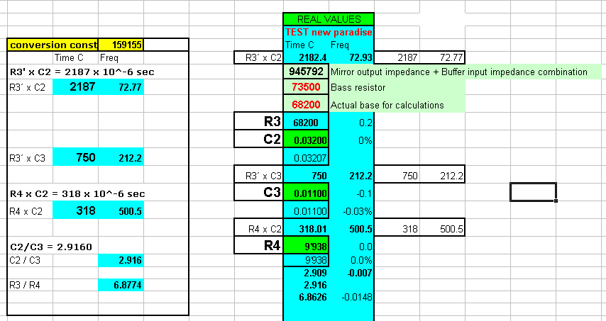

Anyway....of course...I will post the final simulation for yours/ everybody's enjoyiment.
Thank you so much.... As you can see, my calculations give similar results to your simulation :)
