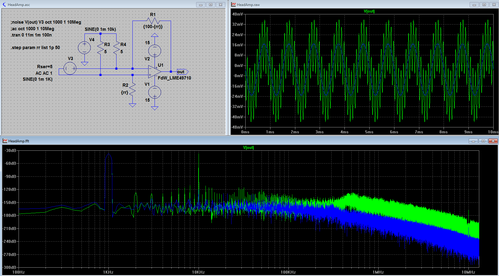

Joachim, why not VF2 direct to pin 3, then disconnect pin3 from ground, add a 100 ohm resistor to ground (from pin 3). It should improve common mode noise picked up in the cartridge and cartridge wiring. Can you give it a try? And a 100 nF between pin 4 and 7.
And because 'a picture tells more than a thousand words' :)
