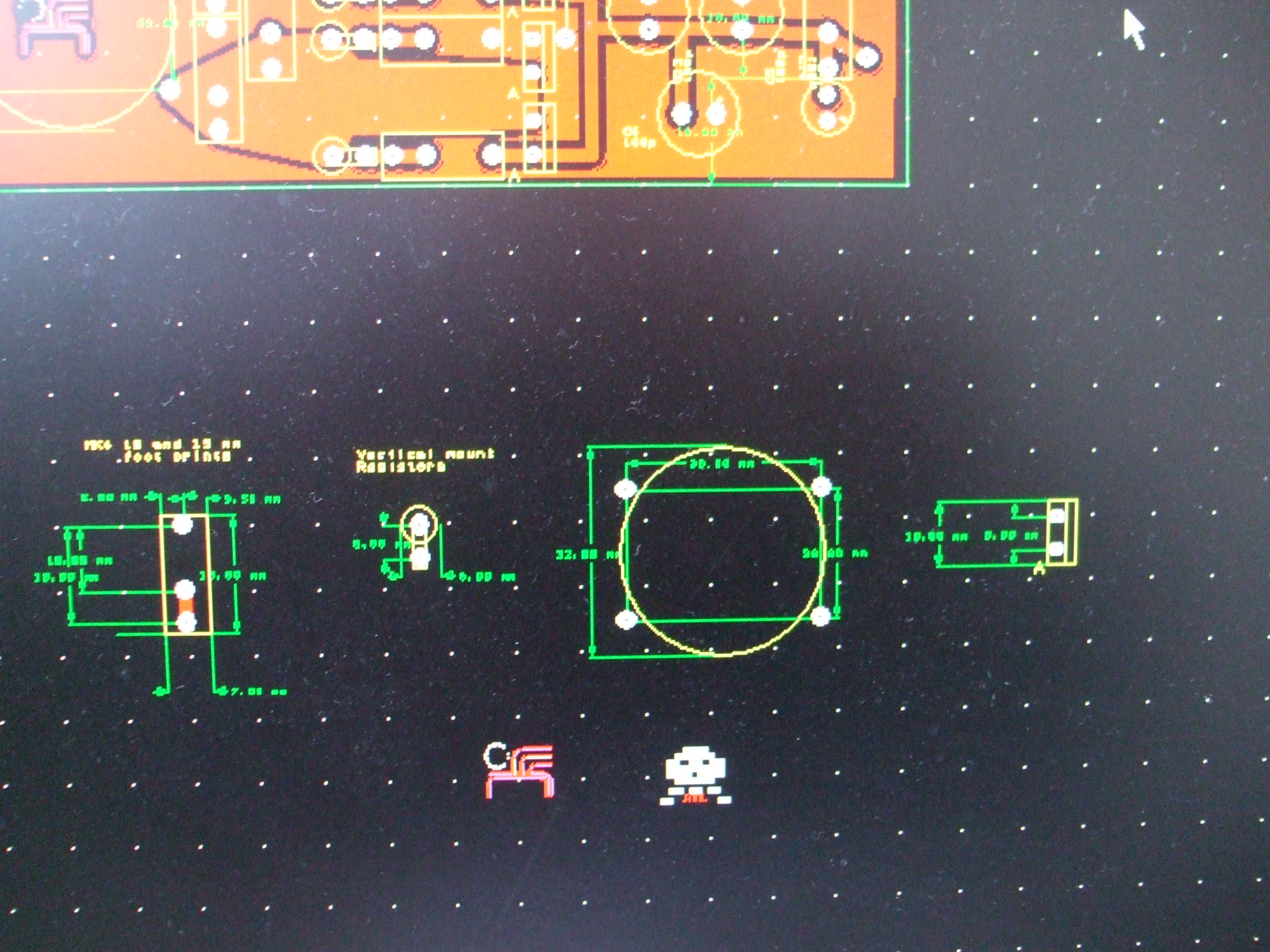

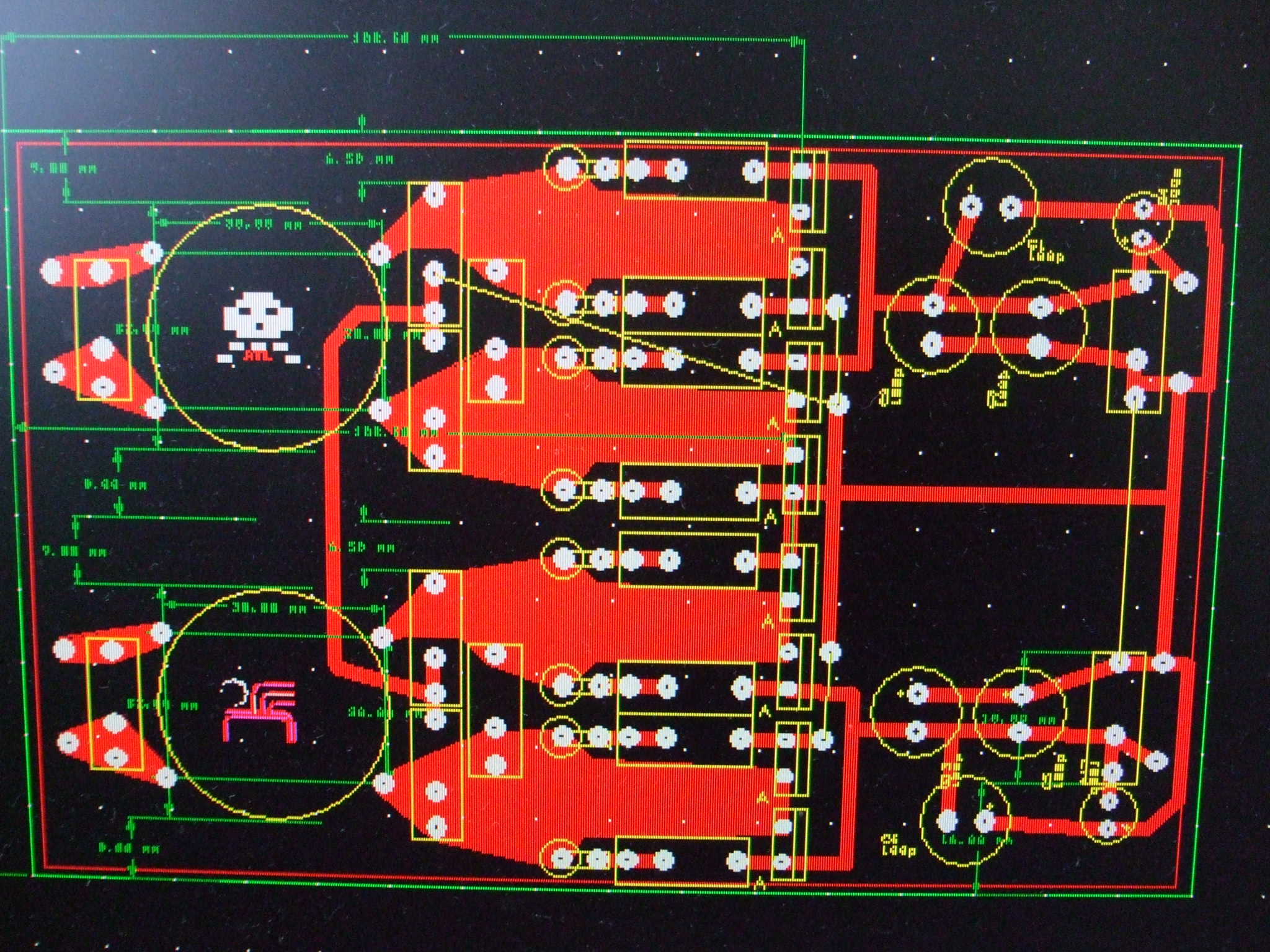

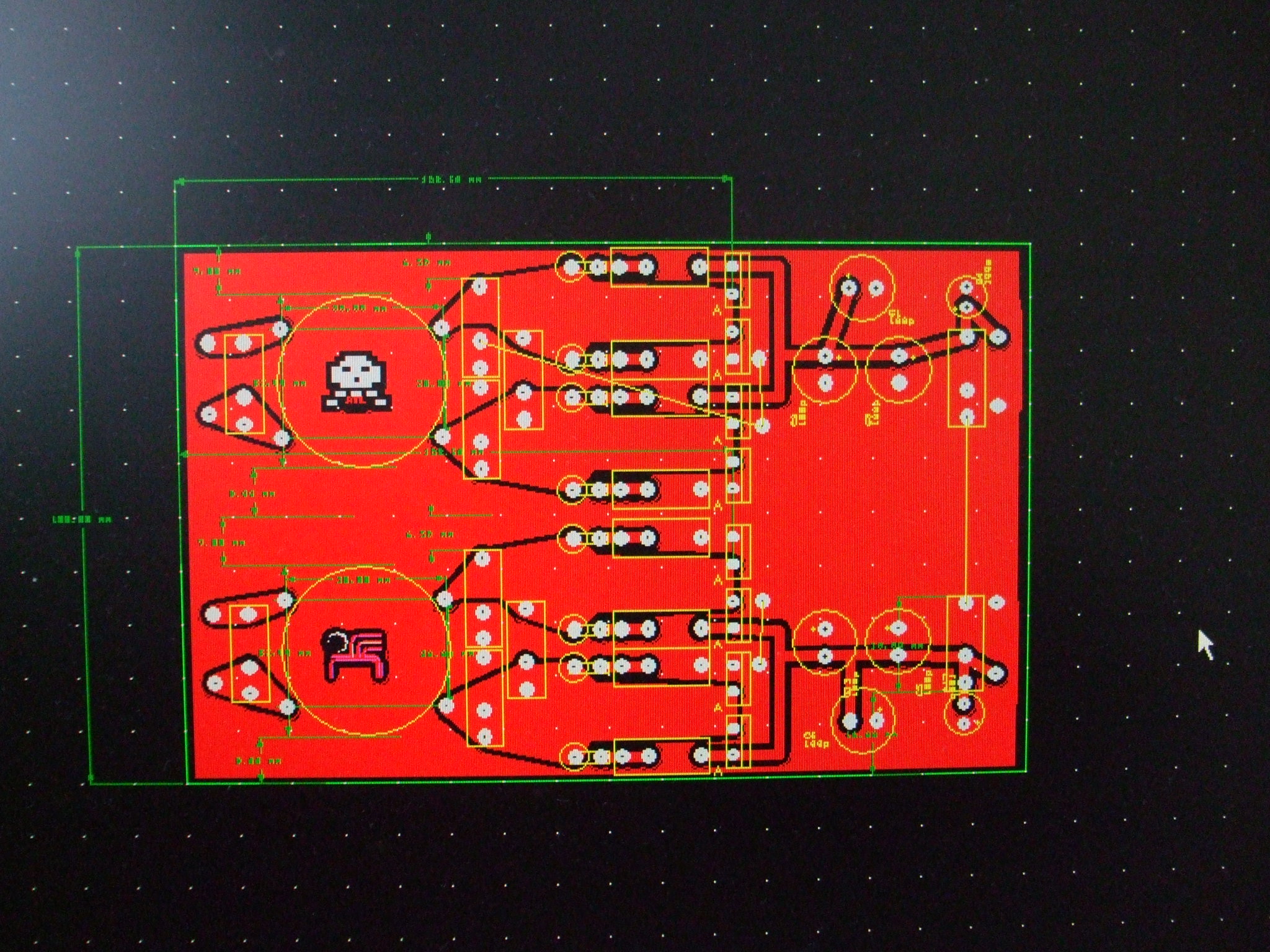

New board lay out ready for acid bath
Footprints for MKP4 up to 7 mm width and raster from 10 to 15 mm
Footprint for vertically mounted resistors (much tidier this way)
I have area on picture for the foot print sizes could you please double check
And let me know of any further changes as needed.
Just noticed missing cooper pour around output tracks that is now ok
Picture 1 The all thing
2 foot prints
3 for clarity no ground plane
PS I have sent couple of PM (Joachim your box is full again)
PSS tanks Joachim for the cokes arived earlier shuld be able to send boards by Monday

It looks great, I can see no problems.

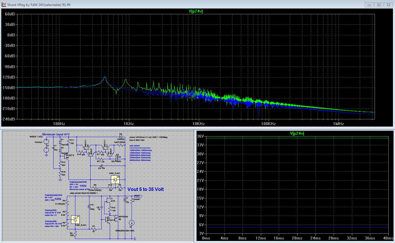

So here it is 5 to 35V up to 1Amp, maximum dissipation at IRFP924 35Watt (when Vout 35Volt @ max 1Amp), and at each of the power transistors 17Watt (when Vout = 5Volt @ max 1Amp).
Awesome graph
What are the fdw parts ?
Awesome graph
That are LT413 variable shunts.
Look up TL413 and you find it. That was a typo i think.
another typo? TL431 I think
