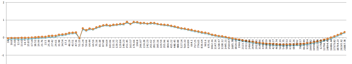

I built a inverse RIAA based on the standard Lipschitz circuit, but I am afraid it is not very precise. But as you mentioned the FPS is precise to +/- 0.1dB, so I used that as reference.
So here is the RIAA compliance of my Paradise below, normalized to the FPS' compliance. Remember I have matched the caps in both channels to each other, and the absolute value is better than 1%, and so are the resistors. Both channels were basically identical in performance, although I still haven't adjusted the current sources to remove the offset.

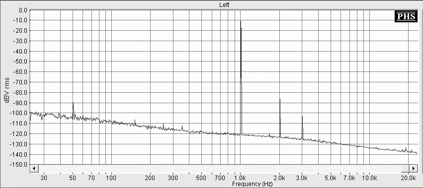

This you may find interesting as well - output noise spectrum of both phono stages.
(Please ignore all the spikes, my test setup was handsoldered in the living room, lots of noise sources around. And I also suspect my shunt regs in the FPS are MUCH worse than Frans' regulators, and the fact they are fully integrated with the preamp helps too).
The upper curves are from the FPS , the lower curves from the Paradise. It is interesting that the distance at lower frequencies is higher than at higher frequencies - could this be the 1/f noise of the JFETs?
To me this confirms my subjective assessment of the Paradise phono stage, I could hear less noise when I did the noise test Joachim suggested. It is dead quiet, and quiter than the FPS. Heck, I am thinking of using it as an LNA for noise measurements (without the RIAA, of course)...

Hesener, you may have a version of the FPS that has the wrong "bass" resistors in both places
Because i originally thought that the output resistors of the servos are in parallel. The correct value is 110kOhm and you may have something like 140kOhm. This are resistors R44, R45 in the schematic that is published in Linear Audio Volume 0. To get that right simply solder 1Mohm over the 4 "bass" resistors.
The noise difference can be explained easy. The FPS has 3dB worse S/N because it is balanced. The bigger difference in the bass comes from the lower 1/F noise of the BJT´s. The FPS is very quiet so the Paradise is in exalted neighborhood.
Naah, you can do better with JFETs in your FPS when even I got this chart from just two K170s with 3R9 under each and a single K170 second stage (bare bones zero PSRR simplistic phono). Single shunt reg and common matrix board ground for both channels. See where you got a loop or a field contamination. Goes to -110dB at 20Hz if with K369s with seriously less of 1/f ascent even. That chart is feeding from 5 Ohm source divider at 0.5mV and 0dB is 1VRMS BTW.
