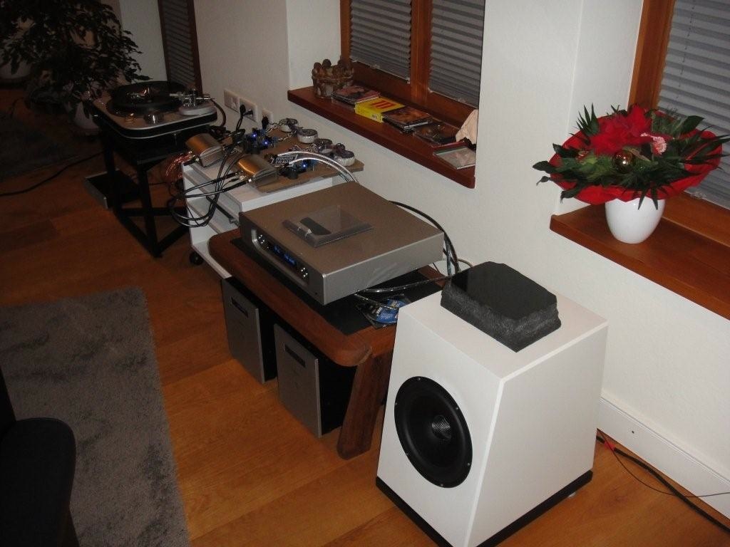

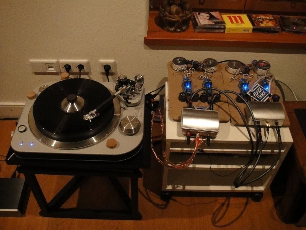

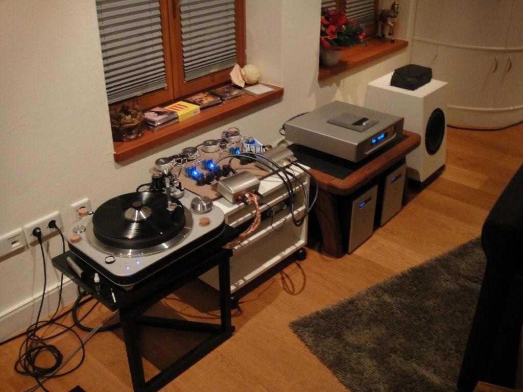

Finally i have some vacation before i go to Vegas. Today we set up my phono system at a friends house. The vinyl trampled the CD in 80% of the cases and that was my most simple stage, the Hiraga Optime Transimpedance stage i have described here. His CD system is not bad at all. An updated Audio Aero directly into the Audionet Max2 Monoblocks. He has a good tonal balance even on the warm side. His speakers are Sonics Allegria S2 with RAAL Ribbon with an active 400W Breeze subwoofer. His room is big and proportioned after Feng Chui. The CD had very good staging and even a measure of microdetail. Were it was better then Vinyl was in bass definition and tightness. Everything else was better then CD. Instruments sounded more typical, treble extention and resolution was better and there was an udeniable sense of presence with the musicians in the room. I show you some photos. From left to right:
The Spiral Groove SG1 with Triplnar arm and Lyra Titan i on my DIY stand. My chaos-fractal cable into the Hiraga Optime into the Transimpecance RIAA. Interconnects are from Wire-World and speaker cables were a double 7m run of Spiral Groove speaker cable.
I have also good news for fellow audiophiles concerning cartridge loading. I talked half an hour today on Skype to Stig Björge of Lyra. Jonathan Carr has gone through the pain of simulating his cartridges plus capacitive loading of cable and Pre. The results will be published in recent setup instructions of Lyra cartridges. Stig will also send the information to me and i will publish it here. As far as i understand it has to do with capacitance and ultrasonic resonance and varies with the cable and stage you use.
