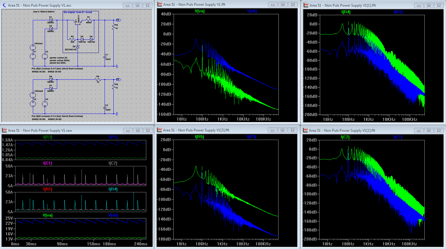

‘Area 51’ device revealed
Dear All,
Today is the day, now is the time
First let’s see the specifications of the ‘Area 51’ component.
Input voltage 0…N Volt
Output voltage 0…15V (depends on device type, this one is a 15V device)
Output current 0…3A (depends on device type, this is a 3A device)
The device is connected between the rectifiers and the buffer capacitors.
The amount of time that current can flow into the buffer capacitor depends on the difference of specified voltage between the transformer and the device, when a transformer of 25V pp is selected for the 15V ‘Area 51’ component it will transfer current for about 50% of the cycle (50% is optimal).
As the attached graphs show, the ‘Area 51’ component improves power supply performance by about 40 dB on all specifications (when compared with the standard power supply).
Frans.
