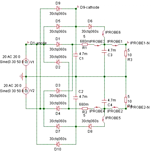

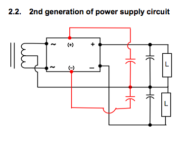

Japan patent JP2006288180
AC-INPUT TO DC-OUTPUT CONVERTER CIRCUIT
PROBLEM TO BE SOLVED: To provide an AC-input to DC-output converter circuit in which, in time zones (forward recovery times, reverse recovery times, time zone when voltage is applied to microarea) where electric currents do not flow through a load during diode rectification, an auxiliary power supply circuit is provided so that electric current flows through the load where electric current is insufficient, thereby improving ripples, or the like, in series power supply circuits.
degawa A&R Lab
Development of Second Generation Series Power Supply Module Exceeding Battery-operated Power Supply
Rectified and smoothed DC supplying circuitry US4555751 ONKYO
A DC power supply circuitry comprises an AC power source transformer with its secondary winding having a center tap; a rectifier circuit; a smoothing circuit; and a bidirectional switching circuit having predetermined threshold values, interposed in between the center tap and the smoothing circuit.
POWER SOURCE CIRCUIT JP58172976 ONKYO
:The center tap 6 of a power transformer 1 and the connecting point P of smoothing condenser 4, 5 connected in series with each other, i.e., the negative terminal 4b of the condenser 4 or the positive terminal 5a of the condenser 5 are connected through a bidirectional switch circuit 1 with the prescribed threshold value. The center-tap current is blocked by diodes D1, D2 in the range that the voltage difference between the connecting point P of the condensers 4, 5 and the center tap 6 does not exceed the threshold value of a bidirectional switch circuit 11.; The secondary coil current of the power transformer, the condenser current and the center tap current become only the amplitude information and do not contain signal frequency component.
Unfortunately this 6 terminal black box is not described in detail.
