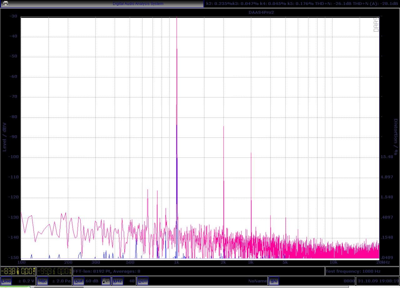

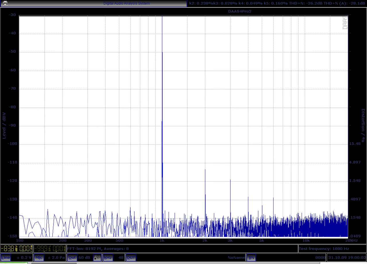

Erata
Here the Goldstandart at -30dB/U

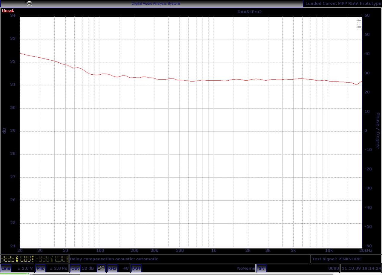

I post a measurement of the RIAA curve i got from the prototype.
It shows a resolution of 1dB. The 1dB error at 20 Hz is due to the fact that i did not have a 318kOhm resistor around and used 3 parrallel 1MegOhm instead so this is easy to avoid. The result shows that the basic mathematics are correct.

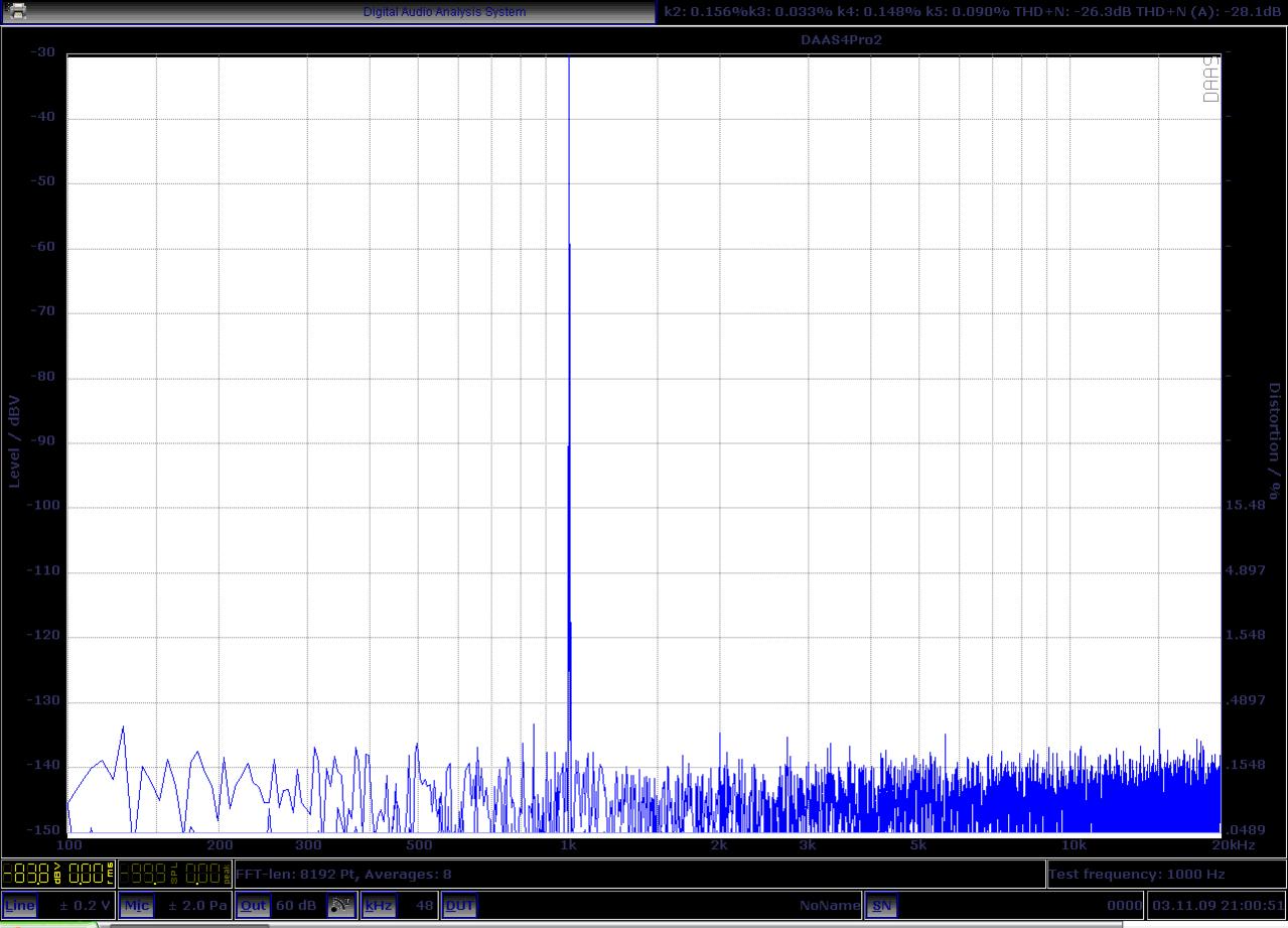

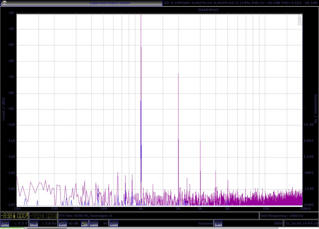

Today i fished the second channel and was able to measure it and listen breefly.
I work late hours so everybody at home was sleeping when i came home so i could only listen at low volume to a diet of Casandra Wilson and Diana Krall.
Measurements first:
There are diffences between the channels but most of them can be explained.
One channel (the new one) has 0.8dB more gain. that may come from the MAT02/MAT03 being different on the channels. I had selected the cascode transistors for hfe but could not do that for the MAT´s. I am using a PEAK Consult transitor tester for this and the revers bias diodes in the MAT`s fooled the PEAK. I could of cause measure the hfe directly but i was to lazy. I may change to other input transistors anyway. The gain difference can of cause be adjusted by R7.
The RIAA on that channel had a 1dB loss at 20Hz. That can be expained by the use of poorly matched 10% carbon resistors. The servo is also a bit different in the new channel and has a series resistor of 1Mohm instead of 750kOhm on the first channel. That does not explain the difference because in both servos the brakepoint is very low.
I used a 0.47uF MKT on both channels. Help !!! i am running out of resistors !!!!!
I also put C6, C7, C8 and C9 into the new circuit (value 2200uF) and that lowered distortion a lot. 3rd went under -100dB at 0dB/U output (aka 1V RMS) and 2nd went down from -75dB to -90dB so this modification is recommended. it also lowers the noisefloor somewhat by a theoretical -3dB.
I then mounted some capacitors also in the older channel and got an improovement too but 10dB less on the 2nd and 4dB less on the third then i got on the new channel. higher harmonics (4th, 5th) are also present but very low in value.
i can only explain that behaviour in the context that i used different types of electrolytics. The new channel has SMD polymer Nichicon 6V and the other channel has through hole Nicicon polymer 4V. Why they behave so different i do not know. This part of the circuit is very sensitive to biasing issues so i will try other caps too. One thing that occured to me is that polymer electrolytics of that high value have a very high leakage current in the order of 1mA. Elna and others are making low leakage types that have less then one muA. Wet tantal whould be ideal in that sense although they do no have particalar low ESR. Unfortunately the 2200uF i found from Kemet at Farnell cost a staggering 300,- € each !
