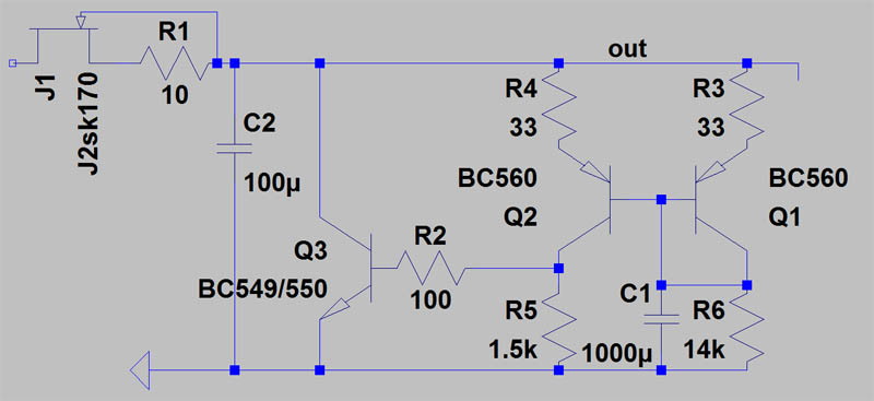

I vote for minishunt for the ref-voltage, it's no big deal to make (but costs one jfet per rail...)

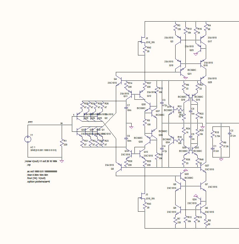

I have put the 2SA1015, 2SC1815 into the circuit, I have also degenrated the input some more with 47 ohms to improve distortion gain is now 55 dB but can be raised in the RIAA correction network.
I have removed the servo from this stage, The servo can later be fitted at the buffer..
I have also implemented the proposed shunt, but something unbalances the circuit so offset at the RIAA node is now 3V (with Zeners it was only 300 mV) the shunt stabilizes the voltages at the cascodes at app +-12 volts, but with at little difference at each rail...(in the ballpark of app 0.5V) could be I have an error in my implementation...??
I think it's important that we finalize the input/amplification stage, so we have that in a good balance/working condition, then the buffer can be implemented.

I found some models from NXP on the BC327-47/BC337-40. with those transistors the offset is minimal..(app 100mV) I do think the offset is generated in NPN/PNP differences in the current mirrors.

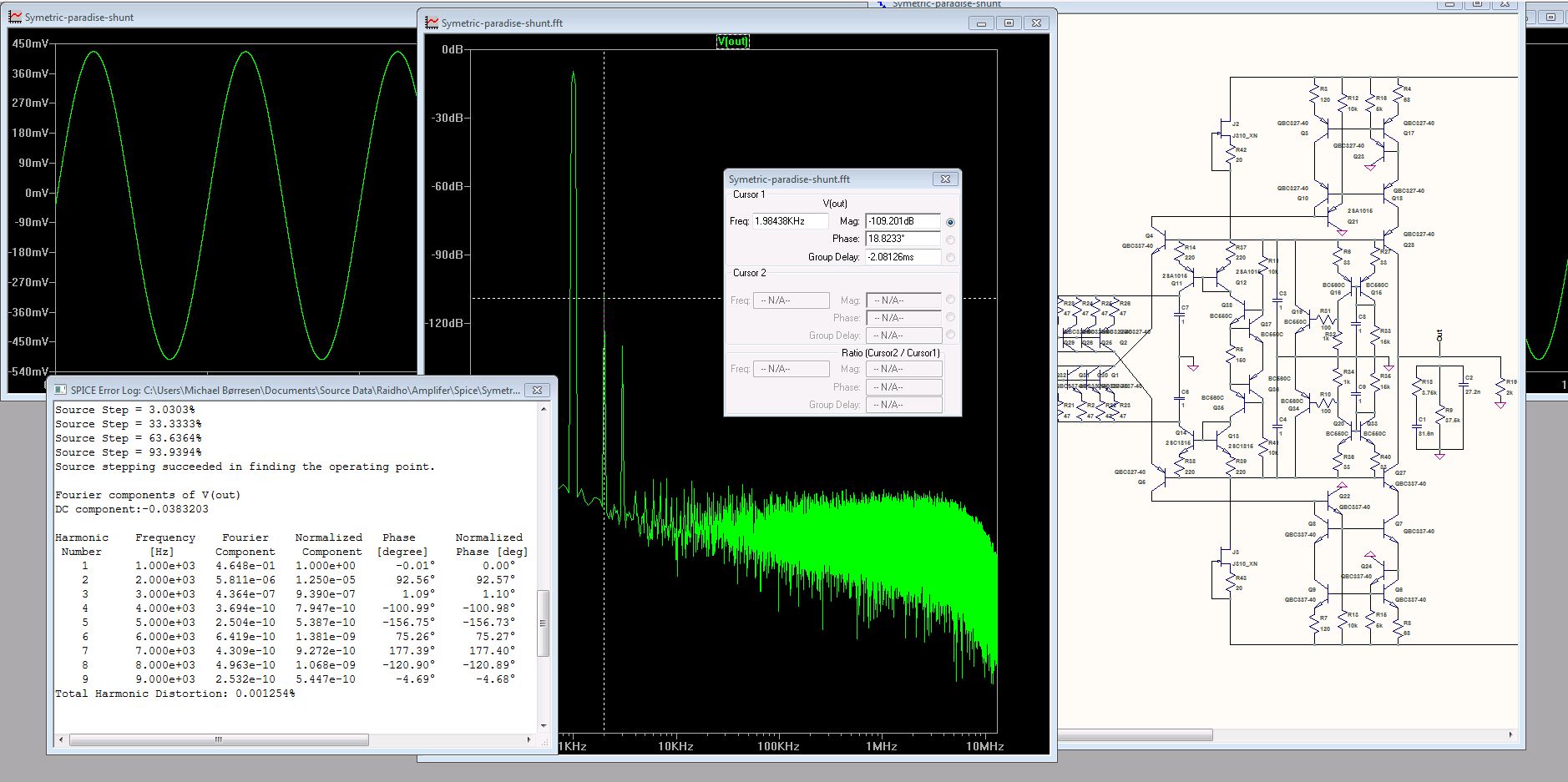

I made an distortion plot with 1 KHz and app 0.5 V out....Looks fine I think...
To simulate deep in the noisefloor I changed capacitor values to 1F...so pls don't take notice of that....
Use a trimmer for the voltage reference resistor (the one bypassed with the big cap value) of the mini current mirror shunts. Using NPN/PNP changes Vref due to differences in Vbe. Vbe adds to Vref.
