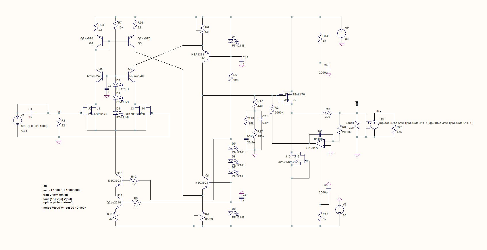

This is the circuit I have in mind...
Quite sure that the servo can be made different...where it is less in the signal path.. but this will work...only must the fundamental offset in the summing node be adjusted so it' close to zero before engaging the servo..
The showed resistor voltage reduction for the servo opamp is not good enough. think that a 15 V zener solution would be better, but for sims this works OK
The gain here is 56 dB, but can be adjusted by adjusting Riaa network values.
The circuit is extremely fast and has a bandwidth of more than 30 MHz.
Can be used with an octet of BF862. without changing the currents, then noise will be extremely low as well...But for ease and proof of concept i think that the SK170 will be good enough
