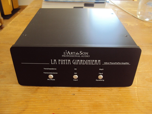

I have build the other channel of the Starless. in the lab i got both channels working. In my system only the second channel works correctly. The other channel is too soft and distorted. It sounds like a contact problem and in fact when i moved around the stage a bit i could influence the signal. I will look at it tomorrow.

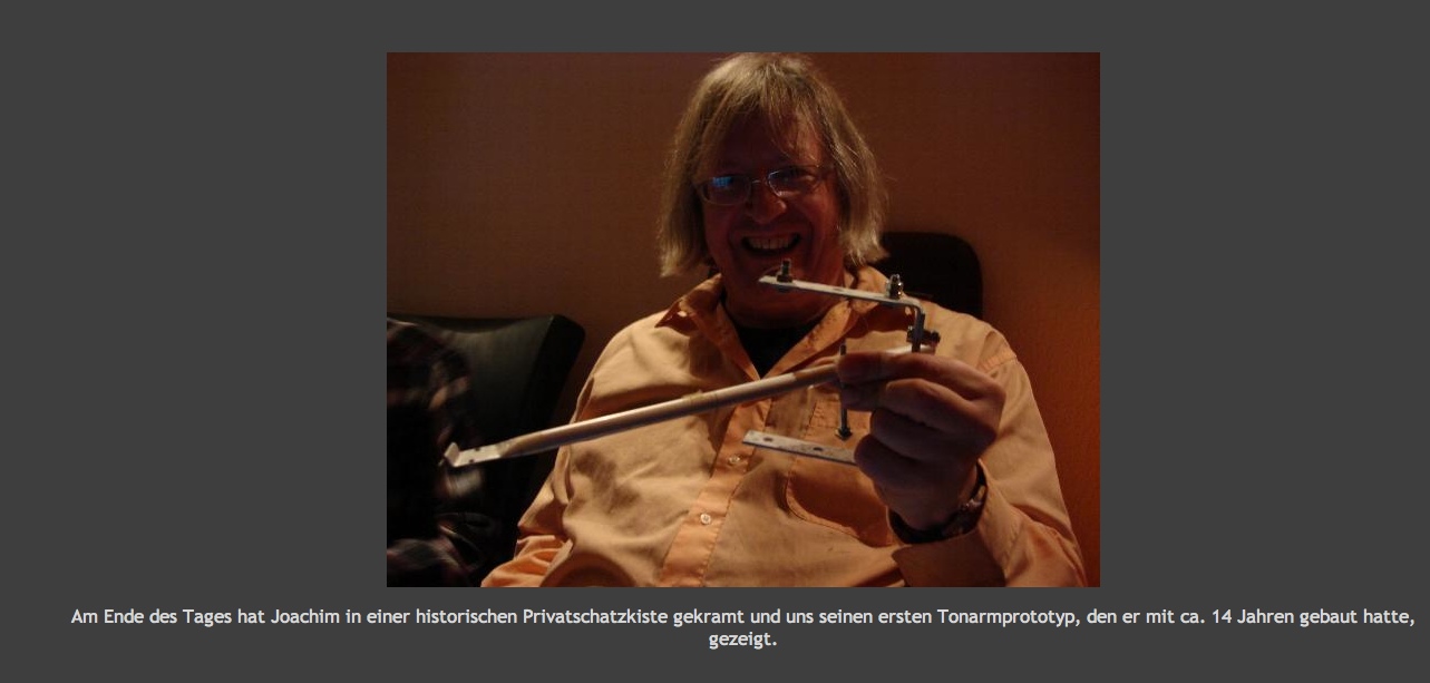

I build this string suspension tonearm ca. 35 years ago......
my haircut looks better at the moment...
Cute
Audiofanatic
P.S. I mean the Tonearm not the guy that holds the tonearm in his hand
SQ, yes, i think it was that way. I made the head shell by compressing the arm tube so this is a one piece tonearm. The finger lift is made by rolling the compressed arm around a nail. I also build a turntable at that time. It is still working in a friends home. It is a rather heavy direct drive from terrazzo and acryllic. It is quite amasing that we had that kind of ideas over 30 years ago. And there was no internet so a lot of stuff came right out of our mind.
Jose`, sorry, i look terrible on that picture.

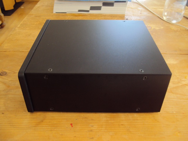

Your case looks very good

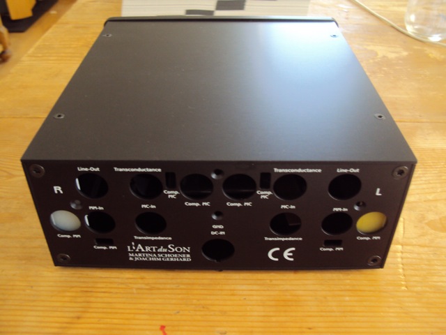

I made the second channel of the Starless work. Actually that was not easy. Back in the lab the channel worked again so i was stuck.Then i found that the faulty channel had some considerable DC offset at the input. It was something like 3mV. Nothing to be worried about in a buffer but for an MC phono input this is way too much. First i tried with swapping the Fets but after 1 hour back and forth between plus and minus 10mV i gave up.
The Fets have to be exactly matched right away or you are in trouble. In in end i solved the problem by inserting an offset trimmer.
Where did you insert the trimmer ?
