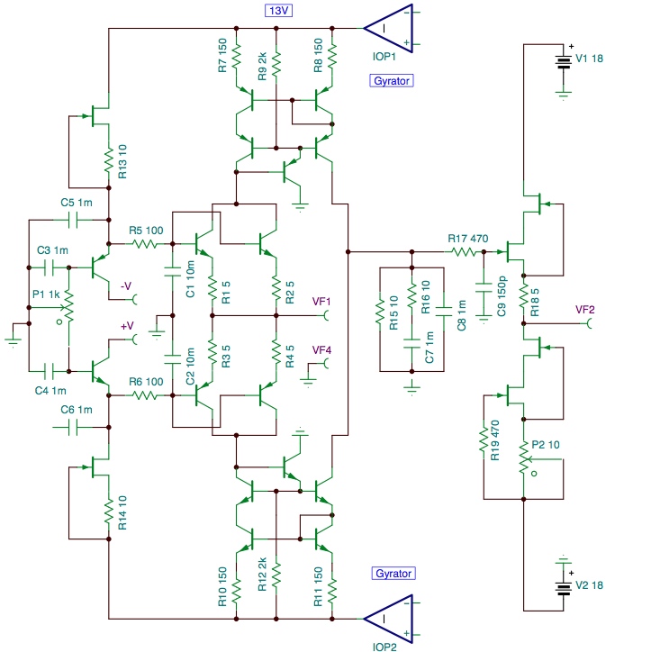

After my little tutorial on parallel symmetric design i went back to the MPP Summer 2011 1.
I think this circuit deserves a PCB and also to be build and listened too. Maybe i can persuade Jan Didden to do the layout or somebody else from here can do it. I put now most of the component values and types into the circuit. The Fets that provide constant current to the Leds can also be substituted with resistors as long as 1 - 4mA flow in the Leds without much disadvantage. I have drawn only one Fet and Led per type but actually 4 of each are needed. I have not dimensioned the Gyrators. That can be a simple BJT cap multiplier like the one used by B.Vogel ( it works well, i tried it ), a Fet multiplier JC style, an Opamp multiplier, a mixture or simply an RC combination that can sound good too. The circuit could even be supplied from the DC direct because the mirrors have excellent PSU rejection.

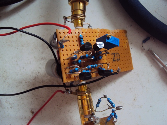

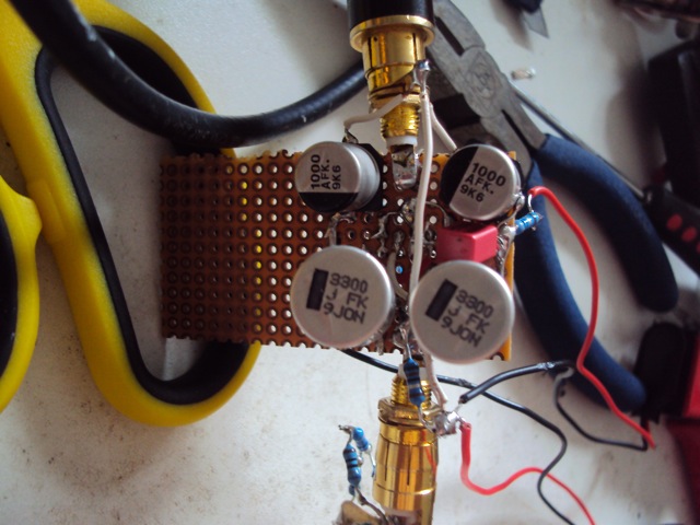

I have finished now building the JLH JG in the elcap version and it works just fine. I also found out why my DC coupled experiments failed. I had connected the collector of one output transistor in a wrong way so i was running that thing on single ended. It did amplify though and that confused me. Feel free to try the DC coupled versions if you wish. I will stop here for the time being. I got it to lower noise and i am happy with that.

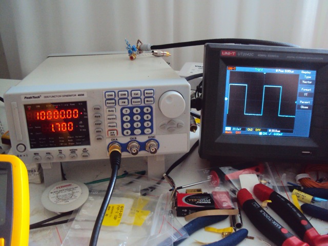

I made some measurements on the JLH JG. Idle in the input stage is 6mA and 17mA in the output stage. Amplification factor is x30 with a 5.1 Ohm feedback resistor. The output transistors can drive 17mA x 300 Ohm = 5.1 V in class a so this circuit will not leave class a any time soon. Bandwidth is 500kHz with a 150pF compensation cap. 10kHz square wave
looks good. I use 2 x 9V blocks for supply. Under this conditions the voltage is plus-minus 6V after the 80 ohm resistors. DC offset at the input is 70uV measured with a precision meter, that is under my 100uV criterion. Here the rather high Hfe of the Hitachi transistors helps although i run the stage on 4 times the current of the original JLH. See some pictures. I could keep the size compact by using 3900uF/9V Pannasonic SMD elcaps. The caps measure 30mOhm impedance at 100kHz. When i started building at the age of 11 a 10.000uF cap with 35V had the size of a cola can. We have come quite far in the meantime.
