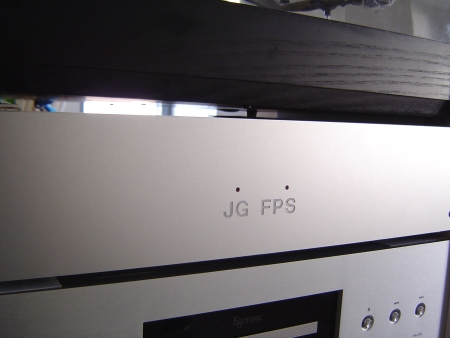

Finally, the finished FPS is up and running in my system, with the final power supply and everything adjusted and assembled (more details in the next posts).
The first impressions after listening to the fully warmed up phono stage were reinforcing the previous comments: Excellent detail down to the last microgroove, excellent bass - deep and strong, tonal very good balance, and no noise. Just fantastic.
My other phonostage is a Pearl II which is a single-ended JFET design, followed by passive EQ and a gain stage at the output. It is good as well, but no match to the FPS for tonal balance, detail, or noise. Initial comparison though was that it was a bit more involving, probably due to the "warmer" sound with a little bit more K2. No going back, however...
And, it fits well with my system as you can see ;-)

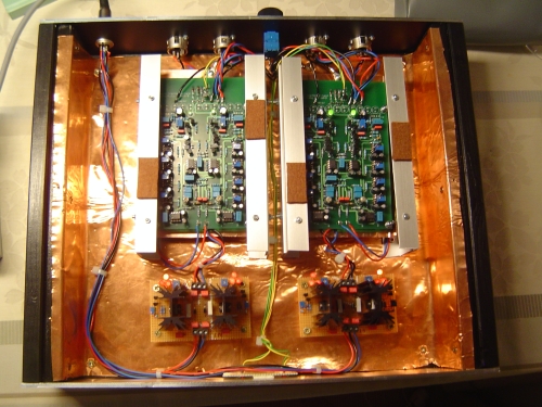

Here some more details on my build. Attached picture shows an overview of the phono stage boards in the box.
The box is made from wood, covered with copper foil on the inside. Front, top and back are 4mm aluminum. That leaves next to no magnetic shielding on the bottom side but since there is nothing in my rack and no cables, just a CD player (with no power when listening vinyl) with a thick top plate I figured thats ok.
The two PCBs are sitting in separate "chambers", and below them are the two dual shunt regs (modified salas "simplistic"). The brown patches on the aluminum frames are felt damping, that will contact the top plate (which itself is damped as well) and so the case does not vibrate.
Forgot to mention: I measured the shunt reg's output impedance to be 4mOhm (!)......

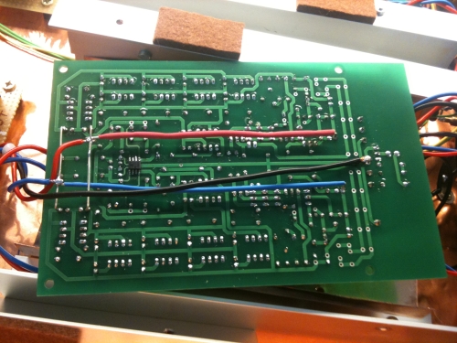

Joined 2005

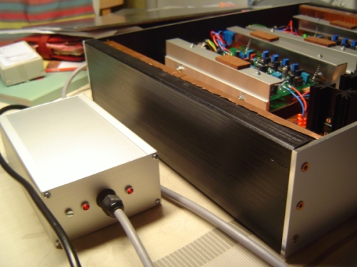

As mentioned earlier, I have modified the power supply layout on the PCB. The connections were on the input side, and in my build the shunt regs are on the output side, so I added some braces on the bottom side and connected the cabling there. The (black ) ground wire is going to the star ground at the input side, though.

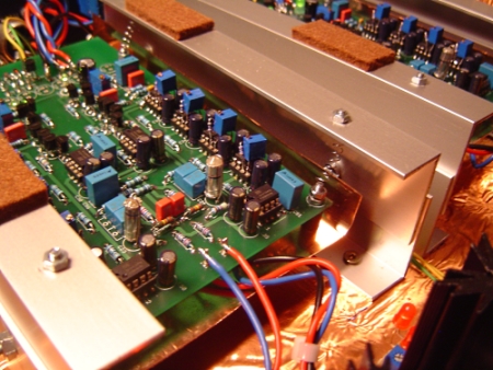

The PCBs are located in copper foil "bath tubs", and hanging from the frames with springs, in an effort to remove vibrations. Not sure it does a lot but it was fun - I even cannibalized 8 ball pens used for advertising from our company (don'T tell my boss!) for the springs.....

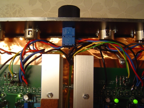

Joined 2005
I spend a lot of effort on the grounding scheme, basically implementing a star ground at the back plane (under the blue pot, hard to see). The copper "bath tubs", the PCB ground connections, the input and output connector ground connections are all coming together here, as well as the copper foil from the case.
The power supply ground is going through its connector (not visible here) on to the shunt regs and then on to the PCB, and to the star ground from there.

By the way, the blue pot is a Bourns conductive plastic pot (1K + 10Ohm metal film), used for adjustable loading impedance. I know opinions differ, especially on the type of resistor used at this point, and I am considering to change it at some point to a fixed resistor. Right now I want to understand better the sound impact of different values.

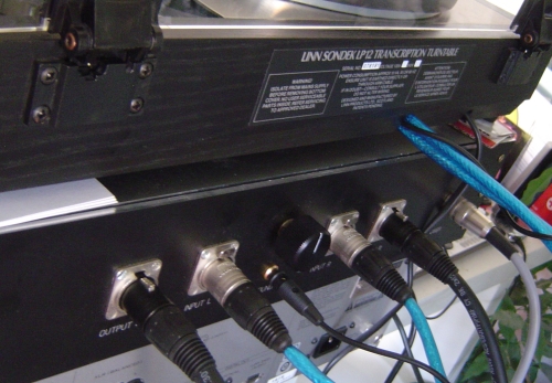

This picture shows the connection to my player and preamp, with symmetrical cables and XLR connectors. Note that the ground connection is not a screw but a banana plug, I think that is a much better connection.
The blue cables are the input cables, and the black cables go to the line stage.

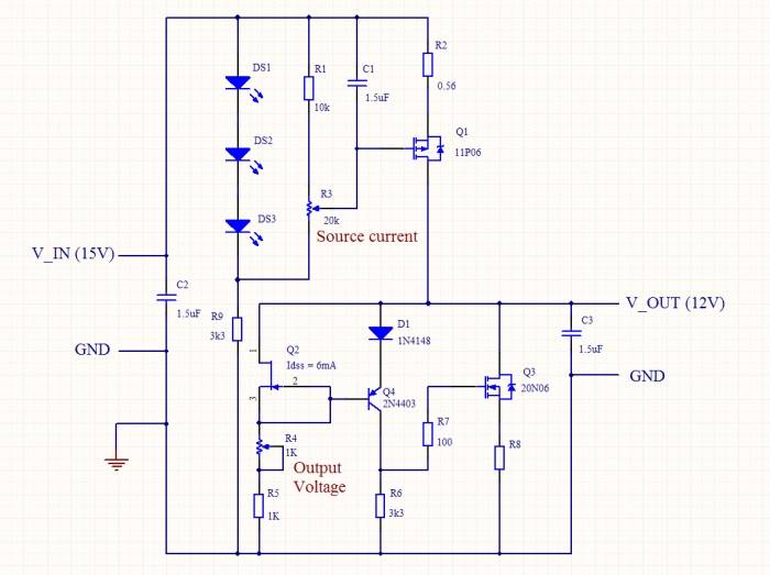

2 : could you draw a schematic of the modified Salas ? I have sometime trouble when i use it so i can learn here something.

On the shunt regulators, attached is the schematic for the positive regulator. The negative regulator is the same, except for the reversed polarity of the MOSFETs, LEDs, diode and bipolar; otherwise identical.
What kinds of issues do you see with this regulator? Just to point out three things I implemented here:
1) the current source is a degenerated MOSFET, that allows for a nice point for measuring the current, has excellent noise behaviour (much better than LM317 - I tried), and lower voltage drop (the LM317 needs around 3V to start operating properly, this one works at 1V or less voltage differential - 2..3V is better though)
2) The diode in the emitter of the PNP increases the drain voltage of the JFET used as constant current source, making the reference voltage more stable
3) R6=3k3 is on the high side, the current starving for the PNP gives a lowish gain, which combined with the Q3 gain is high enough but still stable.
One issue that might happen is oscillation around Q3, but that can be fixed with R8 (not needed in my design) or a small capacitor from gate to drain (100pF or so).
The temperature stability is not great, as I pointed out in the original "simplistic" thread, due to VBE of the PNP decreasing with temperature, and the MOSFET's positive tempco (at least at these lowish currents). It is not helped with the additional diode.
But the drift is not large, and it could be fixed, but then I thought so what. Adjusting the output voltage after thermal settling is good enough. Of course, 10-turn pots for both the current and the voltage are advisable, especially for the current as the adjustment is quite sensitive.
I did measure the output impedance of the shunt regulators with a electronic load that can sink a DC and AC current, and the output impedance (= noise voltage / AC current) was 4mOhm flat from 20Hz to 22kHz. Low and flat, thats what we want right? (in this case at least ;-)

Ok, that is a version of the Salas i do not know. I had trouble with oscillation in one case. I think i used the Mesmerize. Maybe i just loaded it to heavy with Elcaps but i also tried decoupling with resistors and it did not help. On another stage it worked well.
Yes, the measurement on the gain resistor gives the idle current in the input stage. It does not matter much. Non matched Fets have no effect on the noise performance ( Scott Wurzer pointed that out ) and a unbalance in Gm does not effect distortion much ether because of the feedback structure. I am just curious. The amount of current that flows totally of cause gives a clue of how low the voltage noise is.

Interesting point... loading this regulator with large capacitors causes a phase shift at higher frequencies, hence oscillation.... Did you try and put resistors in series with the cap (to increase ESR)? It's counter-intuitive but works well. Audio Research used a similar trick, albeit for other reasons, in their tube line stage power supply (forgot the model, I think it was the LS25).
In my phono stage the 1.5uF at the output is all I use! It feels strange to NOT have big caps there, and when I unplug it goes off immediately..... never had that before.... but the listening results and also the measurements indicate otherwise.
Use LEDS instead of Norton Vref if better drift is desired, but it can be inconsequential. You skipped capacitor filtering the Voltage reference resistor and trimmer on purpose? That could be an important aspect. Your build works well for Zo in its simple form, congrats.
