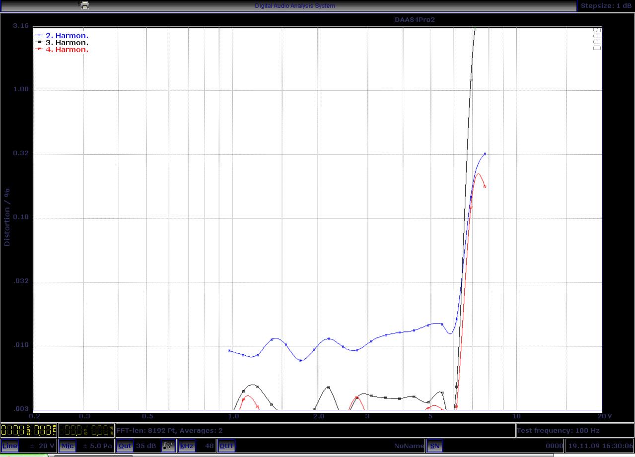

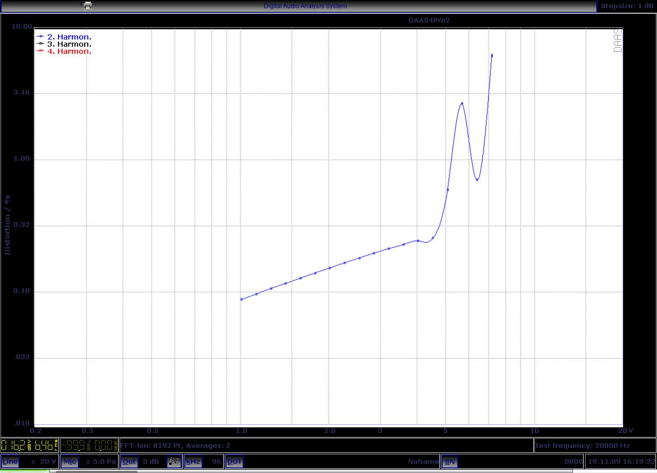

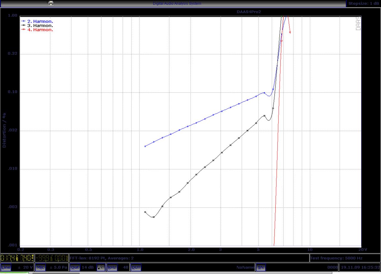

i promissed more overload measurements of the original MPP and here they come. anyway, this is history now that i know that matching and improved current source can make much better distortion readings. again measurement are taken in dB/U RMS one leg swing only. they start at 1V and are compensated for RIAA gain this time.

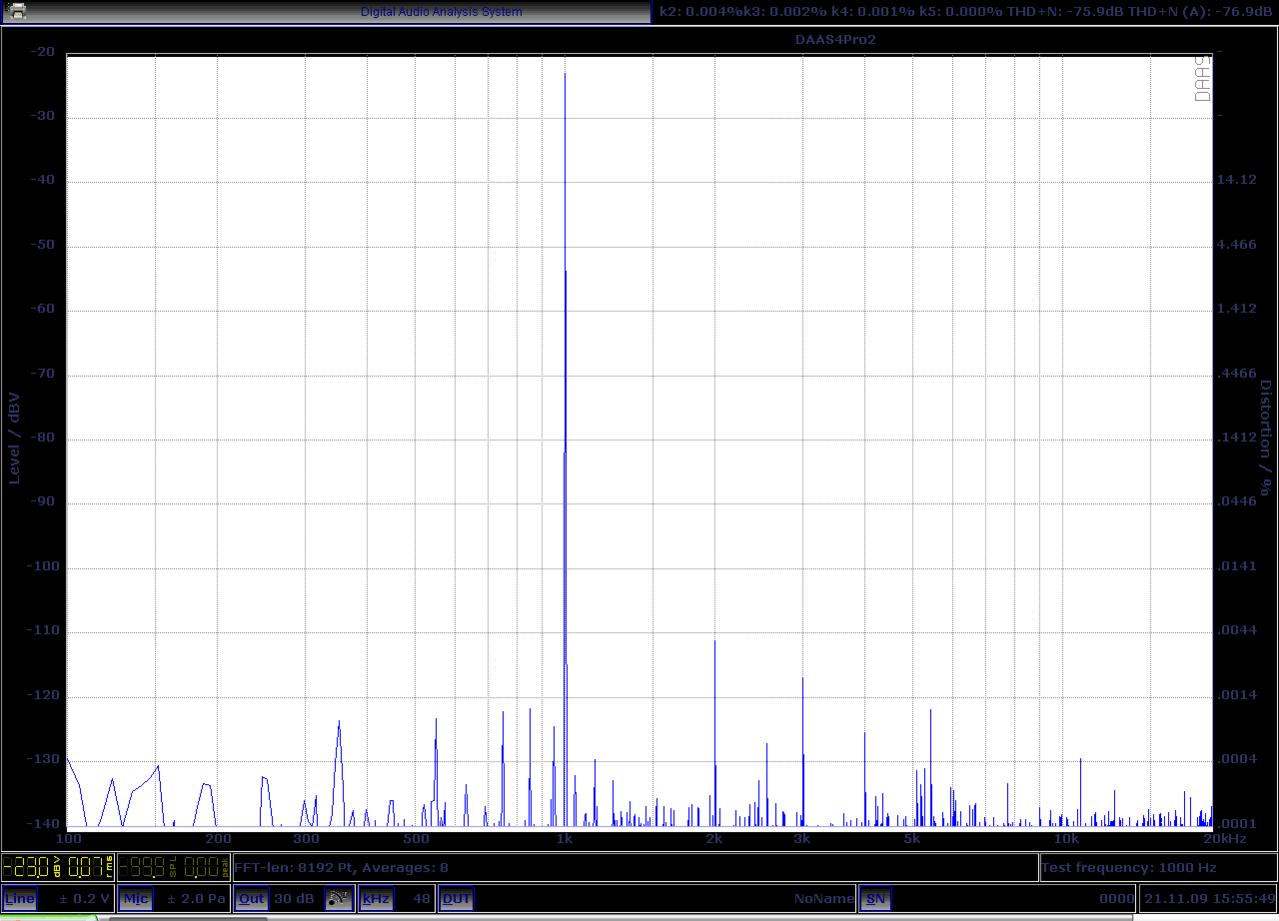

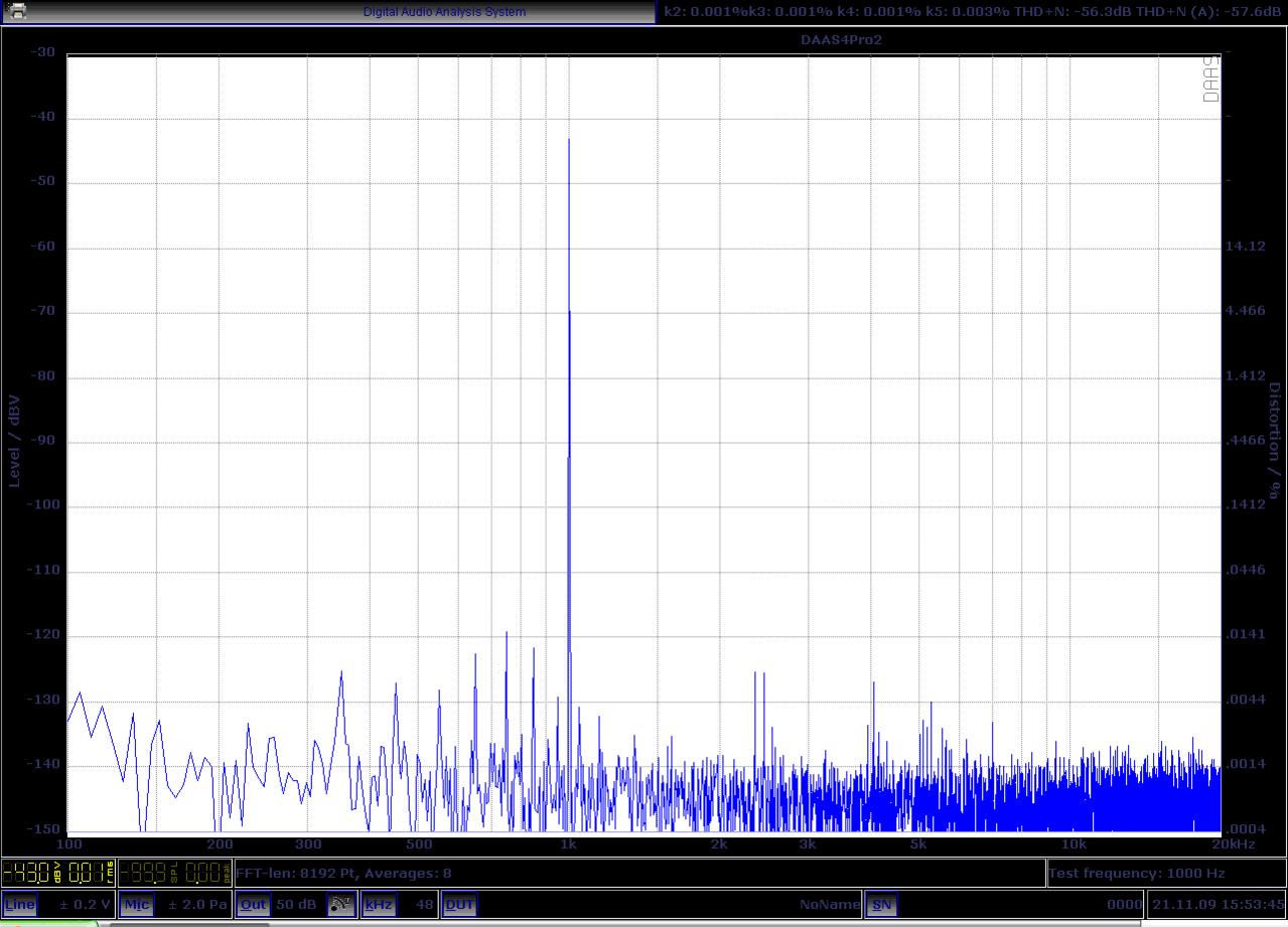

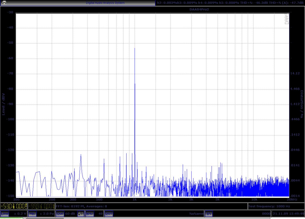

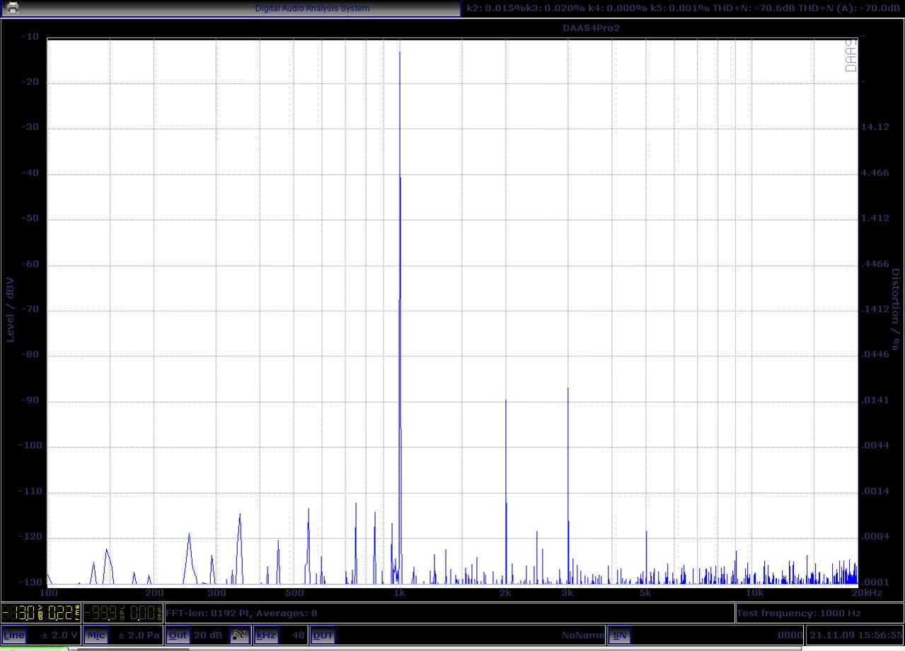

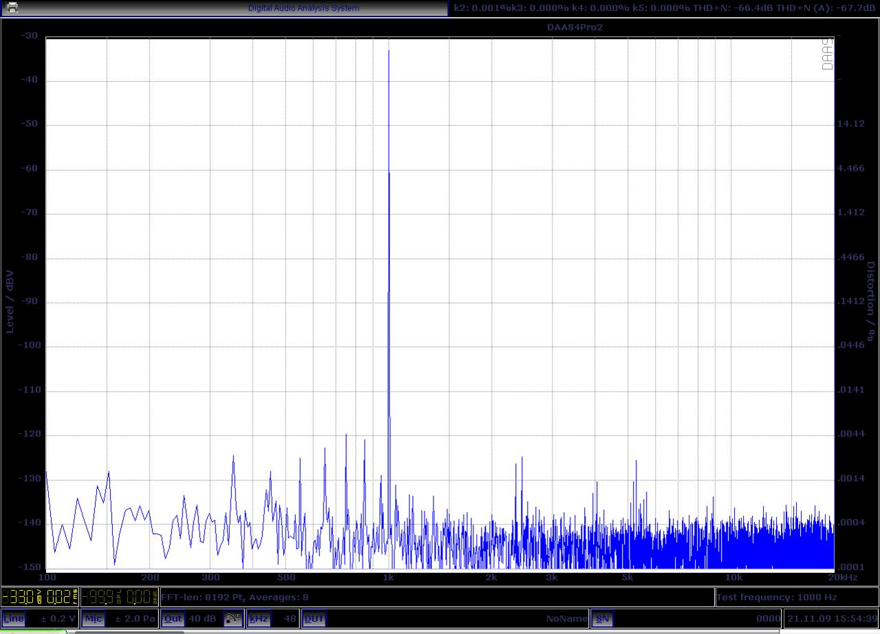

so here come measurements on the new MPP unbalanced. It has good speed and amplification. when i set the gain to 30dB with the 340 Ohm resistor - 3dB bandwidth is 3.5MHz so gain bandwidth is 105 MHz. i will calculate the slew rate later. a 100kHz squarewave is reproduced without overshot and very straight lines. i will show a photo later in this tread too. HF demodulation is virtually non existend partly because the circuit has quite a low input impedance. is this at last an atvantage of the transimpedance topology ? i show distortion measurements at different output voltages. they start at less then 50dB. that amounts to an equivalent input voltage of 0.1mV. i did this measurement to look at resolution problems at low volume. maybe when i find the time i will measure at even lower volume. 0.02mV should be posible. the circuit seems to behave quite monotonic so i am thinking that low level resolution is good. on the plots you can see some intermodulation products. partly they are measurement artifacts (under 1kHz) and partly it is radiation from two nearby toroidal trannies. the circuit seems quite sensitive to hum injection and my lab powersupply is not really good enough. i will work on grounding and shielding and also started to work with Salas on a really good supply. installed at my home hum and noise are not audible in the listening seat at high volume. with the ear close to the speakers i hear a very faint "light" sounding noise and some hum with an unpleasant overtone spectrum. hum is slightly dominating in terms of subjective volume. hum got better when i put the trannies farther away but i could not get them any further because the cables are not long enough. anyway, in the finished version i will put the trannies in a seperate box with pre filtering.
i found clipping at -3dB/U so it can put out (head amp section only) 2.5V (P-P).

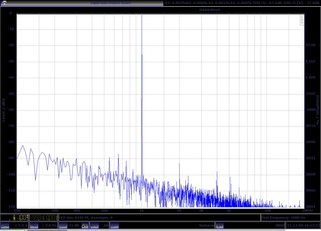

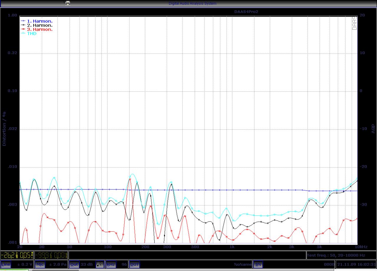

shown here is a sweep at 50mV (head amp only) and total distortion and noise including following RIAA stage at 1V dB/U RMS also done with my lab PSU. i think distortion is not a problem any more with the new design and i am very pleased that the MPP had such good potential for improvement.
