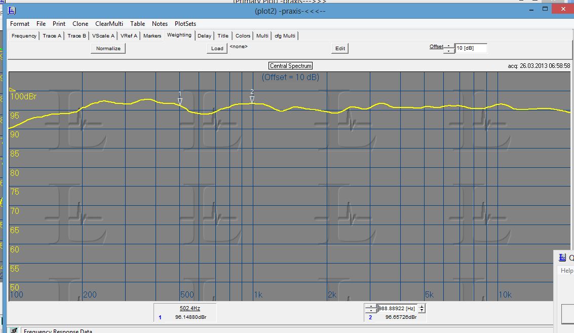

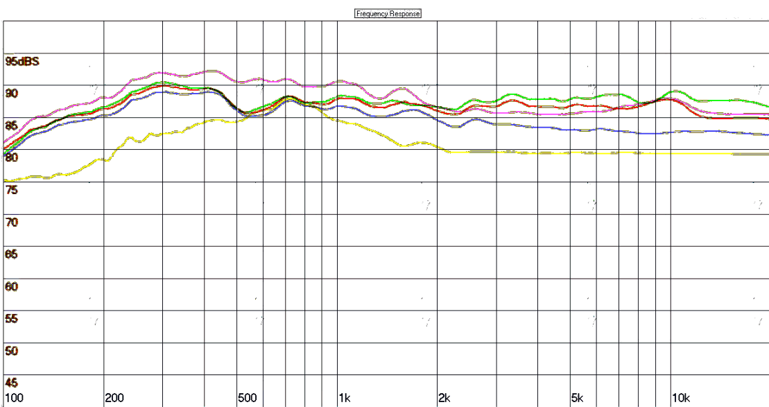

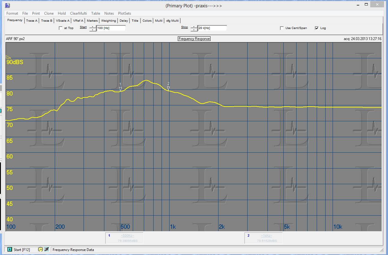

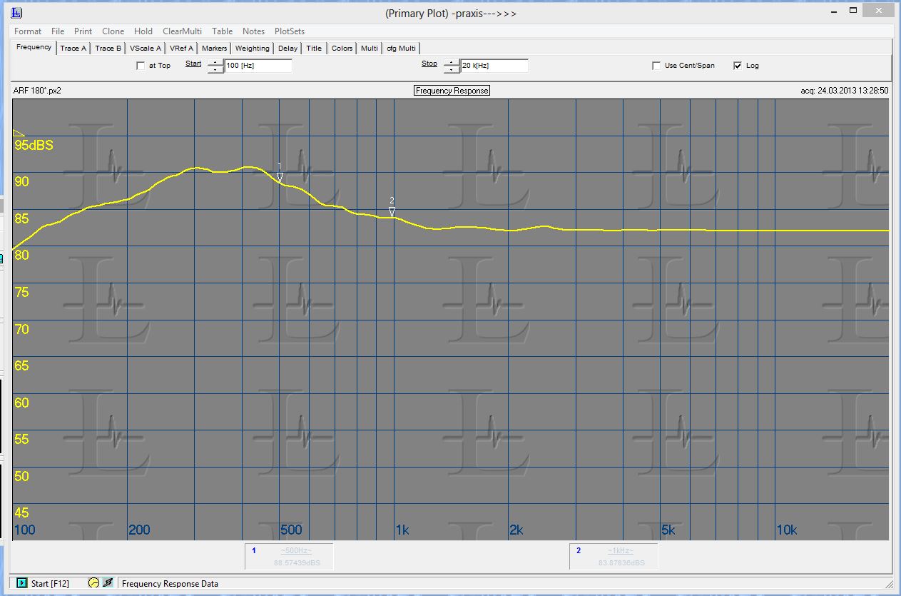

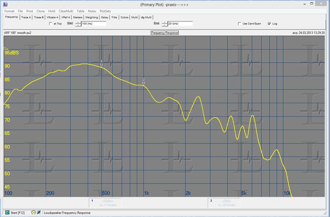

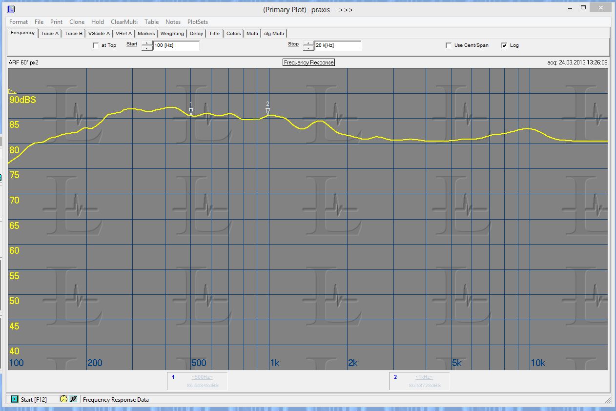

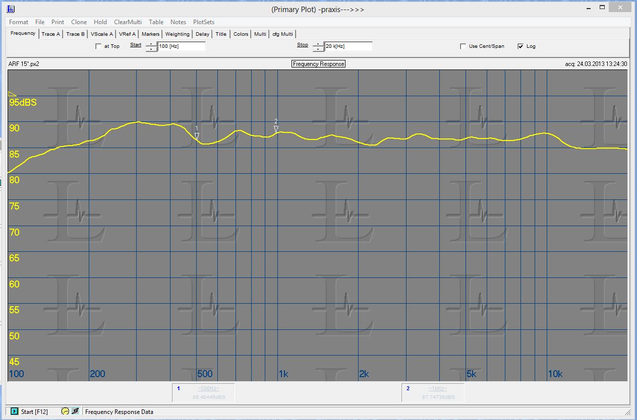

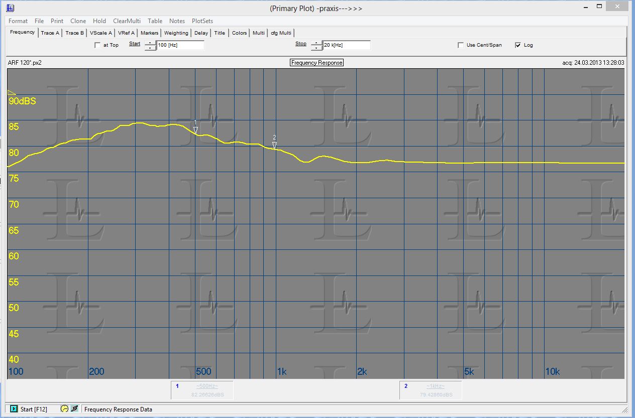

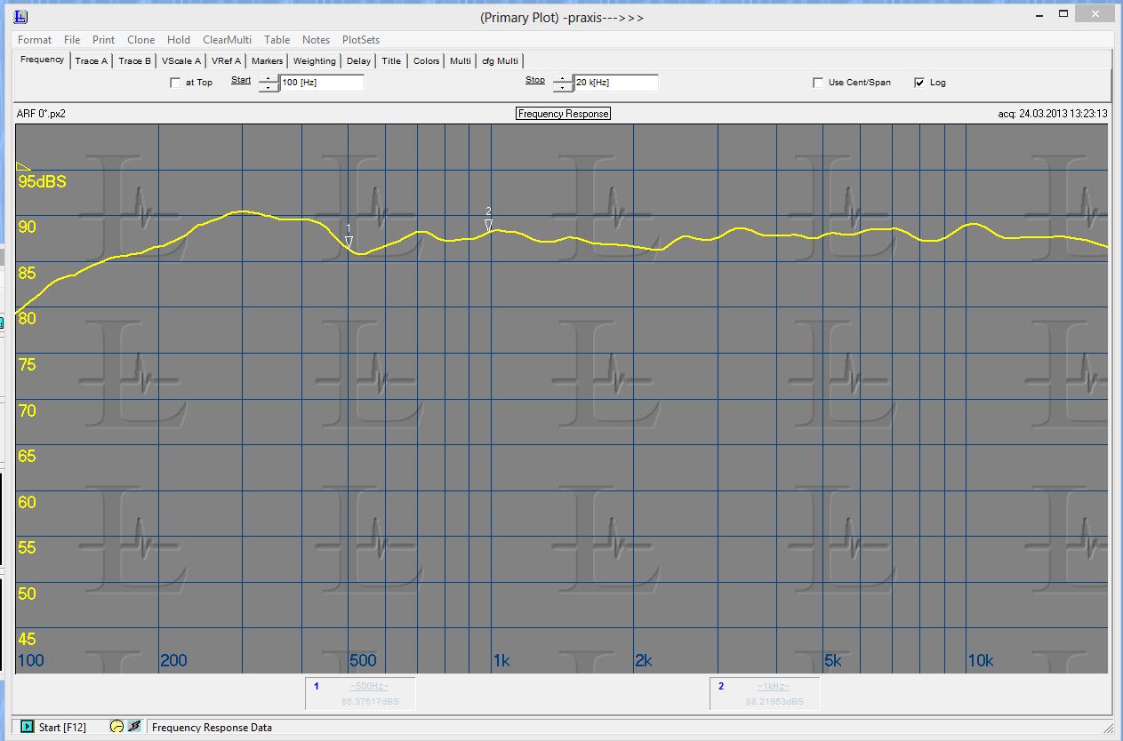

Here are the measurements i made on the Acoustic Resistance Frame.
It is on 0°, 15°, 45°, 60°, 90°, 120°, 180°. I use a post process from Don Keele called
" Central Spectrum ". It works with the notion that the human ear hears peaks in the response better then holes or sharp notches. You see that on some off axis plots the response flattens in the treble. This is the consewquence that level is so low there that masking sets in and the frontal radiation dominates. The last plot shows the 180° response without that post process. The roll off is rather smooth i think.

The measurements so far may tell us about tonal balance and radiation pattern.
An outstanding design like this has other properties that are important for success as well.

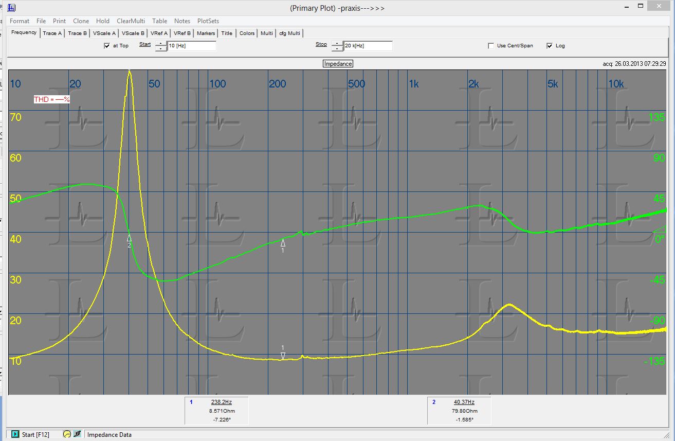

So far the measurements where taken with 1V in 1M. That is the default setting of my Praxis measurement system. I have repeated the on axis measurement with the more usual 2.83V at 1M. That transfers to 1W/1M into 8 Ohm. This gives a reading of 9.03dB more. I took the baffle as reference distance and got a sensitivity of 96.5dB at 2.83V. You can also see the impedance curve. The maximum is at 78.45 Ohm @ 40.37 Hz, the minimum is at 8.59 Ohm @ 238.2 Hz.
The fundamental resonance is shifted down a bit by the frame damping compared to the data sheet. The impedance curve reflexes my inbuild EQ. It is done with 3 passive components to reduce a slight upper presence lift that is the natural behaviour of the untreared driver. Some guests i had prefered the sound without EQ. It sounds somewhat more bouncy and dynamic to some but i prefer the even sound of my EQ and do not feel a loss of micro detail or dynamics. I think it is a psycho acoustic effect because a little lift in the upper presence gives that impression.
