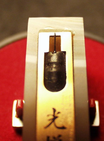

If the cat leaps up and pats the stylus, your cartridge is ruined. But it's unlikely to happen.
Unlikely, eh? You can see the missing tip on the pic. I'll refrain from posting a picture of the cat - it's also missing stuff now.
