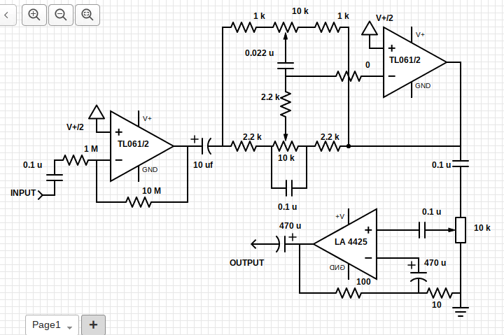

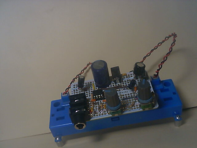

With the higher input Z there is so much more highs
that I need to re-adjust the tonestack ..... ; )

With 9 V actually not that much more power ...... But that seems enough for my studio .
BUT ........... It can be powered up with a heftier wart .

Do you think the input ( jfet ) buffer makes that much
of a differance with that type presentation ?
I think it's a mix of the FET front end followed by a power-amp with collapsing rails. Plus a truly crappy speaker set up (nothing under 150hz, nothing over 4khz, plenty of cardboard box flapping).
No tone control, so gotta rely on the axe set up to take out most of the bass to avoid pharting. My chino-line is set up with a Bill Lawrence 5-way switch and phase reverse switch (push/pull on volume). It's a pretty flexible setup while still looking like a "stock" tele.
