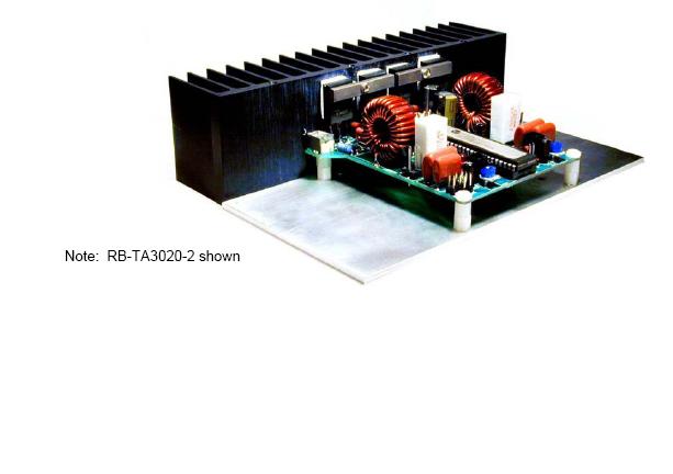

Anonymous1 -- The power supply - the rails are +/-30V? I haven't had the time to rip into mine yet... According to the TA3020 spec sheet, you can go to +/-60V and get over 300wpc @.1% THD....I would drop that supply and keep the remaining "Guts" usefull - not a bad idea...
+/-30V will give you around 100wpc @8ohm, so this checks out...
And the real cool thing about these TA3020, you CAN BRIDGE THEM TO OVER 1000WPC @4OHM!!! So you can potentially have a 3 channel system getting 2 x 1000wpc and a single 300wpc with a beefed up +/-60V power supply (again, 4 ohm).
Google the RB-TA3020.pdf and you will see that the boards in the Moto are very very similar looking to the Tripath RB-TA3020 dual channel Evaluation boards...shows you how to bridge the Evaluation amps too...
Also Google the standard TA3020.pdf and you will find the specsheet
